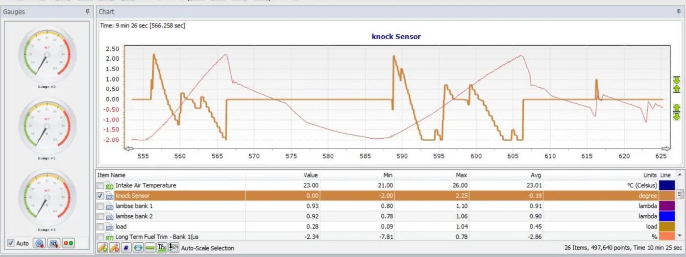

Can someone educate me regarding Knock Activity? Is there a safe range for Forced Induction systems?
Below are my past experiences when performing Datalogs with the current modifications at the time. I do have all logs saved if anyone is interested to review.
Prior to Whipple Upgrade
- Mods: JLT Intake with Bama 93 Performance Tune and Ford Racing Borla Sport Catback. All other mods unrelated as it still on the vehicle. 93 octane in the tank (mixed 91 and 100 octane to make 93)
- Datalog: File name "Screenshot_20160211.jpg". My last datalog before the Whipple Upgrade, I experienced 2.25 degrees of knocking. This is after I re-tightened exhaust bolts, checked intake and TB for any loose bolts.

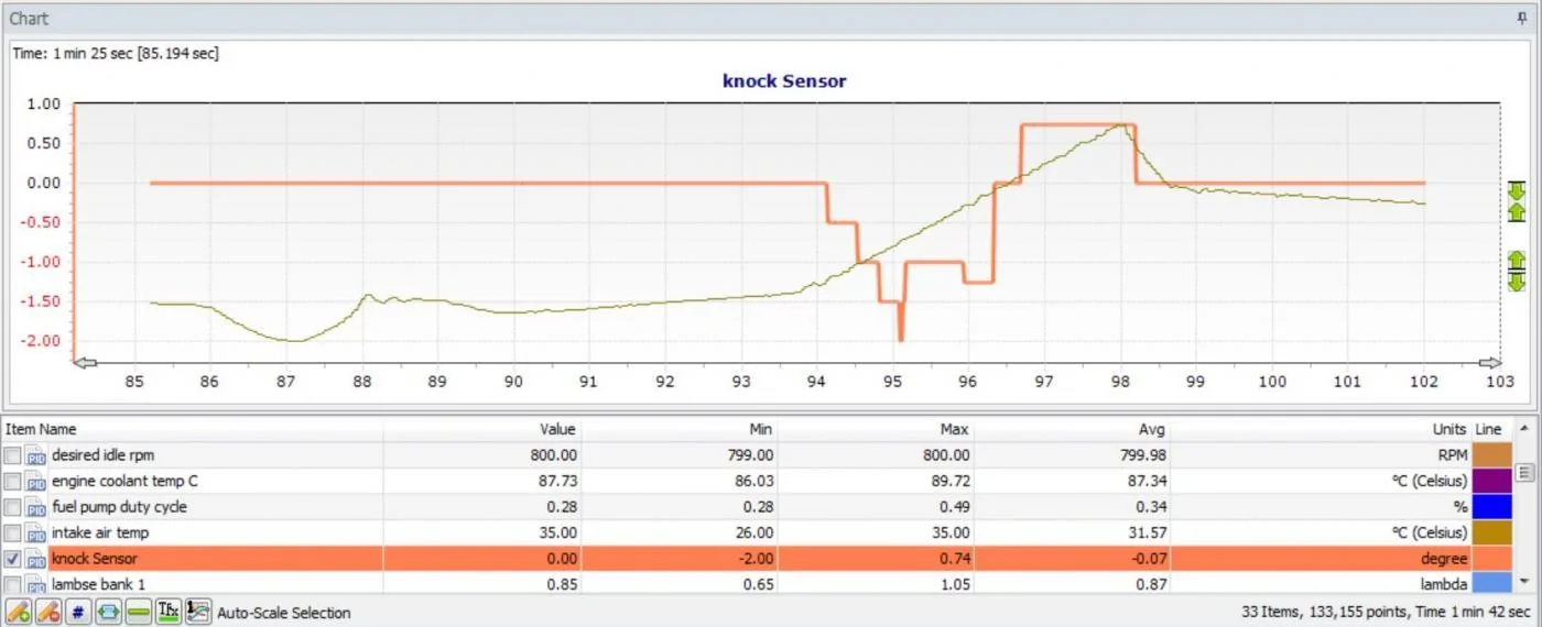

- Datalog: File name "Screenshot_20160325.jpg". I experienced 0.74 degrees of knocking on 3rd gear WOT.

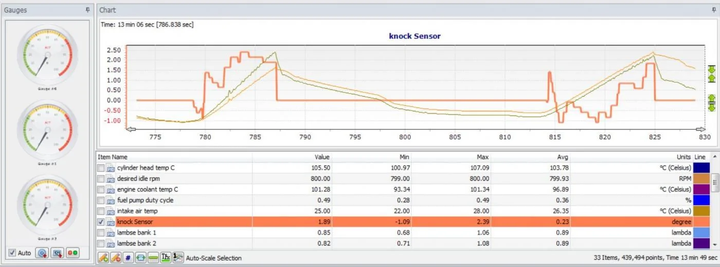

- Mods: Whipple Stage 2 Kit plus 0.025" Bypass Restrictor, Stock Exhaust and 91 Octane in tank with Knock limiting off on Flare device.
- Datalog: File name "Screenshot_20160529.jpg". I experienced 2.39 and 1.84 degrees of knocking on 3rd and 4th gear WOT, respectfully.
Is this a concern or is it typical?
What this means is that this is how the system is designed and it's working as normal. You are adding and subtracting. It's pushing the spark until it knocks then brining it back, meaning you are at or near peak timing and cylinder pressure for your given octane. Higher octane or lower temps (higher flowing exhaust) can help or higher octane. But there is zero wrong with what you have or see there.

91 vs 93 octane is about 5-6 deg of timing, everything else equal due to the octane and burn times. On 91 octane it can't handle the same timing so the knock system is more active but it is also adding in your log so you are fine. Just real world conditions with our good ol 91.....
