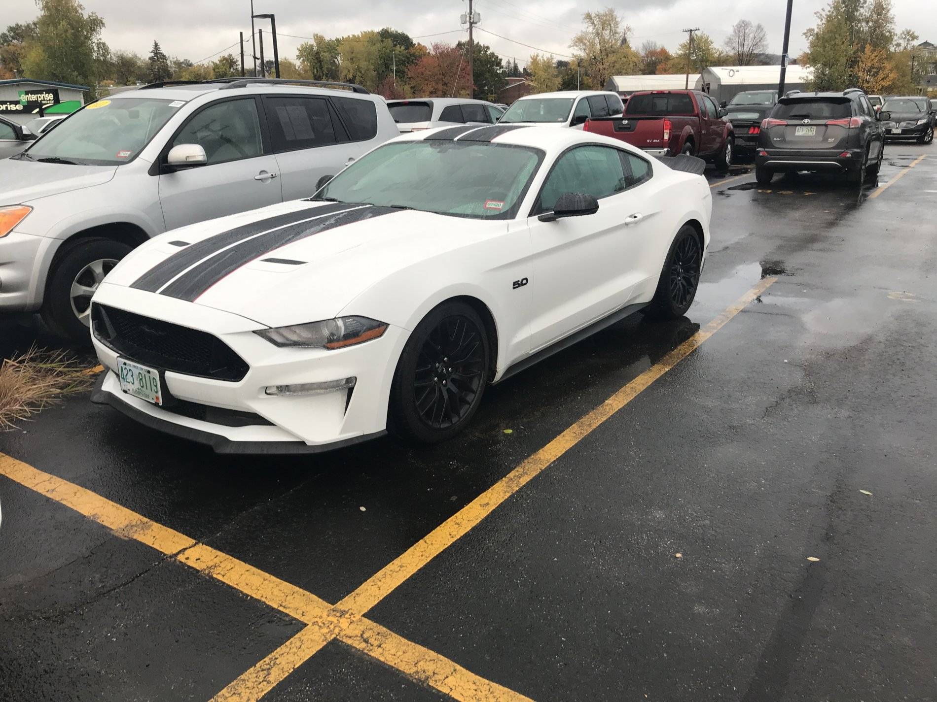

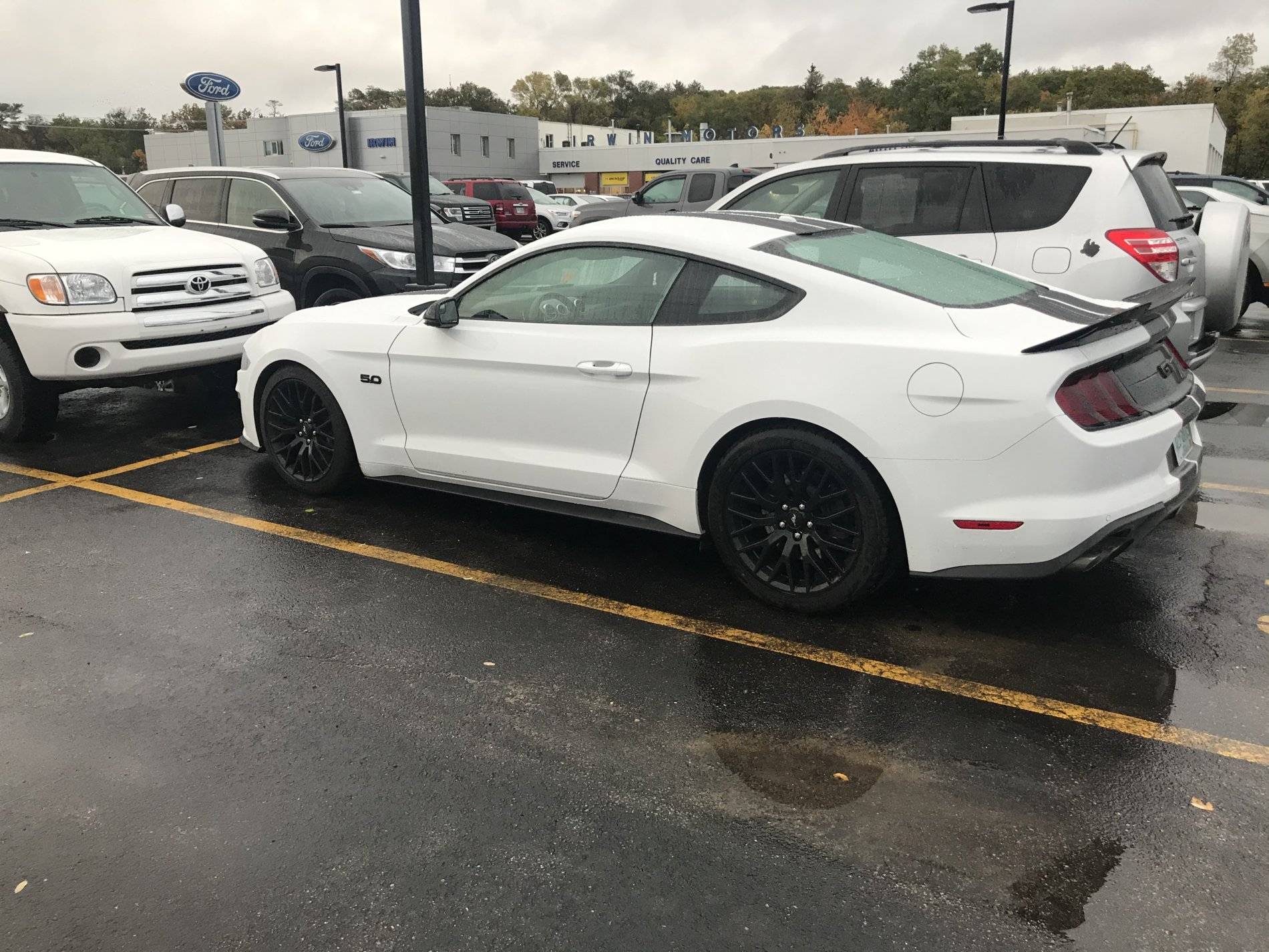

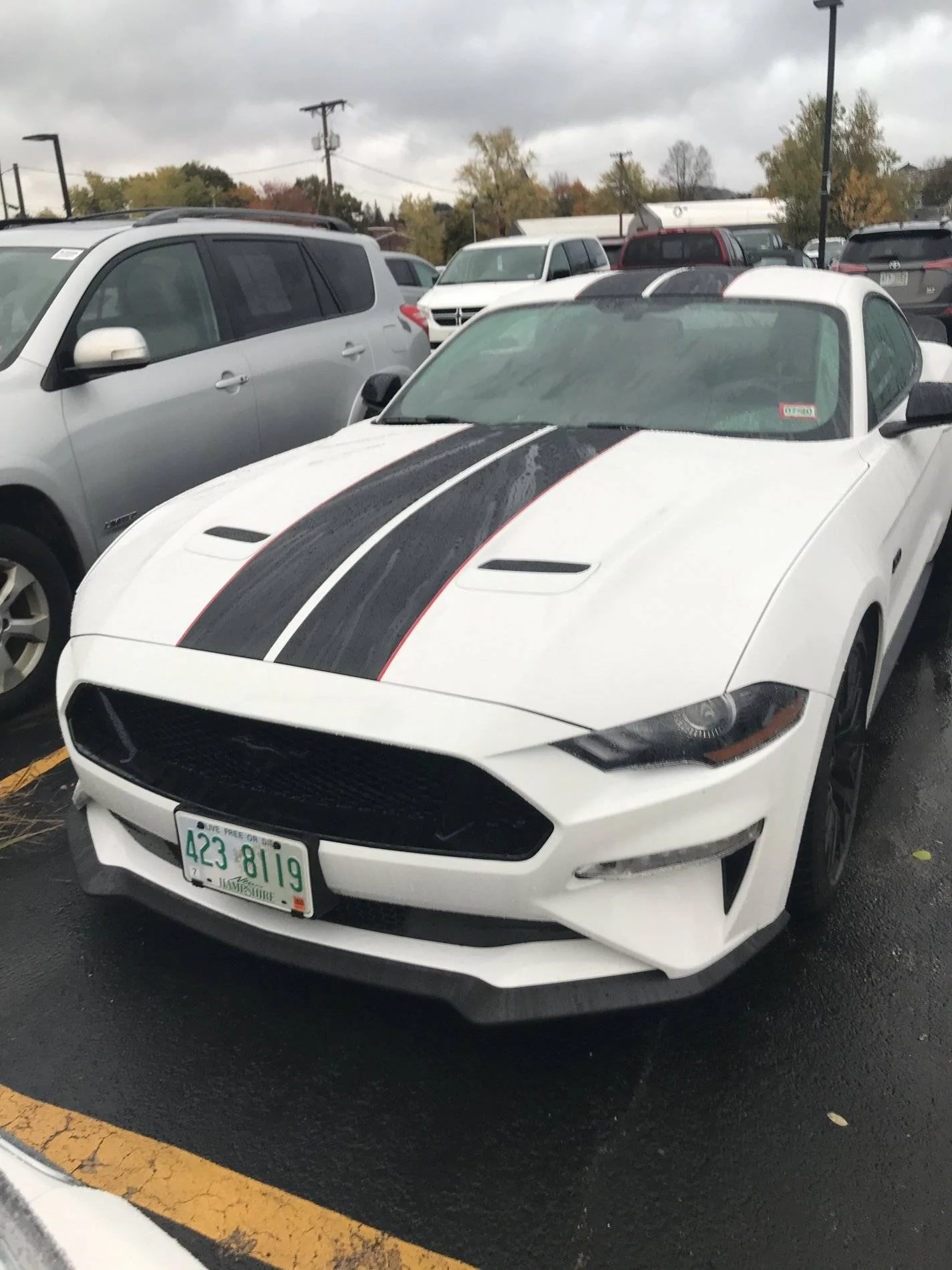

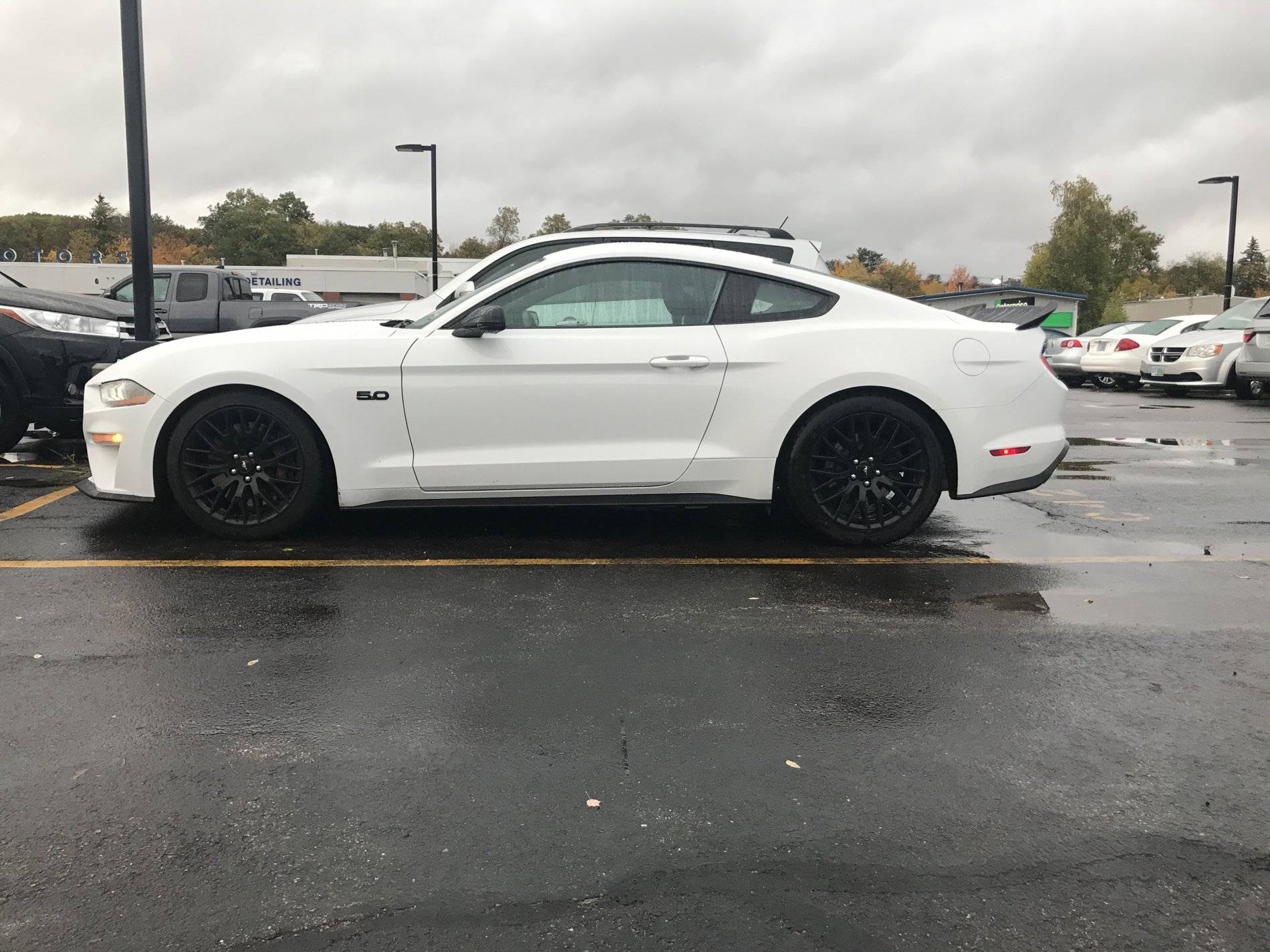

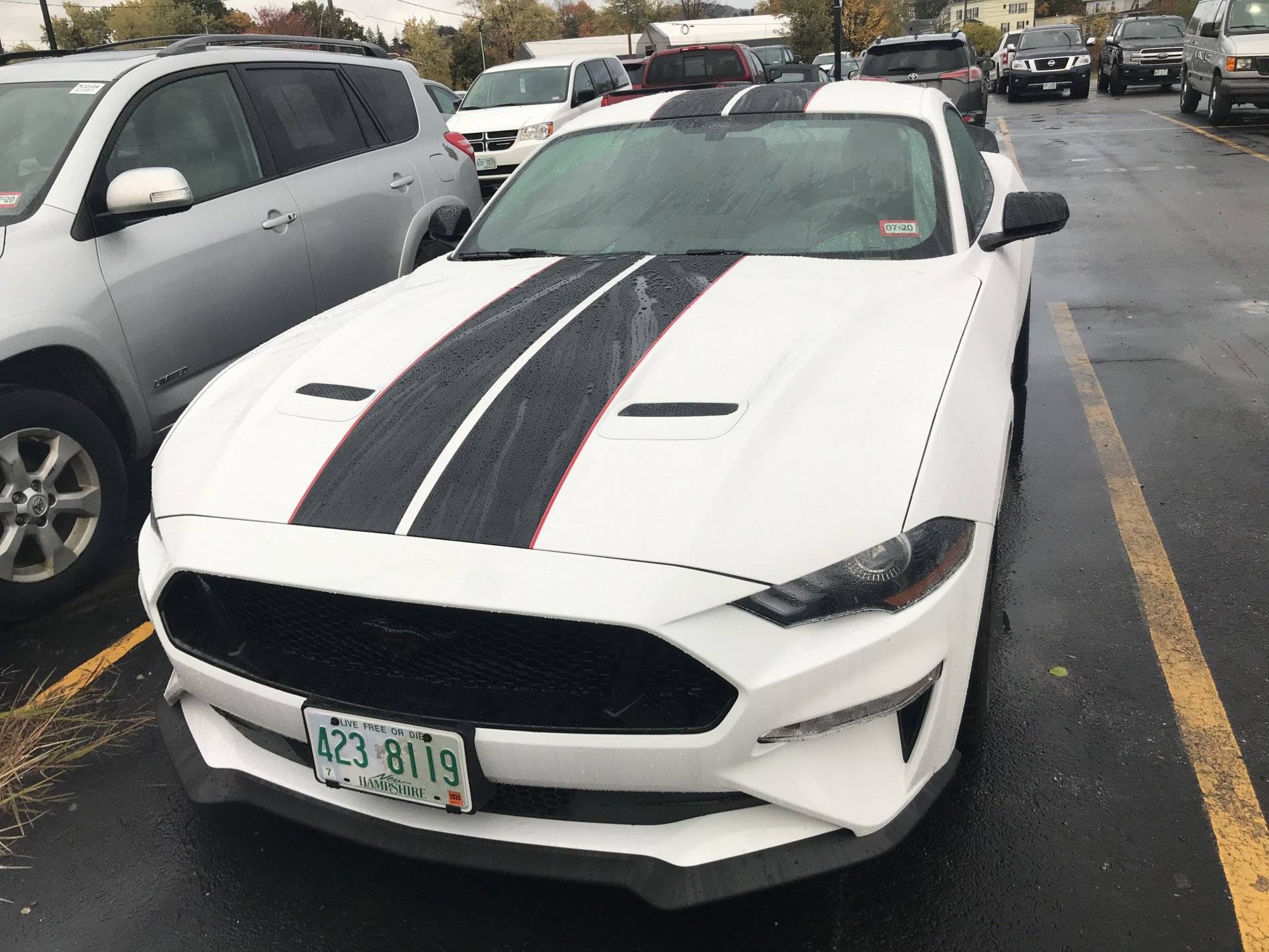

Ok, I had these installed with the Steeda stop the hop pro kit. The car is way tighter and feels much more balanced and nimble. It accelerates perfectly straight under hard throttle with wheel spin and feels much more planted. My only complaint is the suspension seems to almost bounce at 50 MPH plus speeds, my guess is the floating feeling of stock PP1 is gone and I’m just feeling the bumps more. It’s not harsh just different. I will update again when I get more driving time in. As far as looks go, these are perfect, still plenty of clearance but more aggressive looking. Fronts dropped an inch and tears about 3/4. On a side note, I had to have my front bumper fixed and repainted , I have the stripes to redo the bumper but actually think it looks good with the bumper stripe less. What do you guys think?
It’s odd that you have issues over 50mph; most stiff(er) setups available for the S550 are more harsh or fidgety under 40mph and then smooth out. Are your dampers adjustable? If so, for sure play around with the settings until you get what you like.
Stance looks good :beer:
