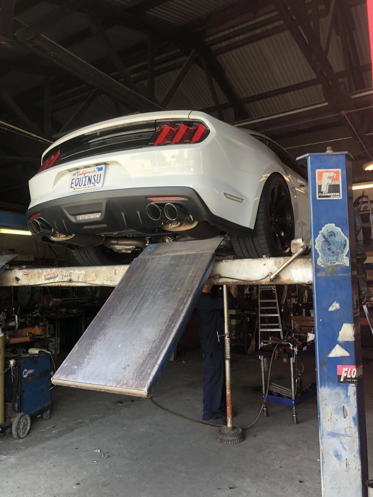

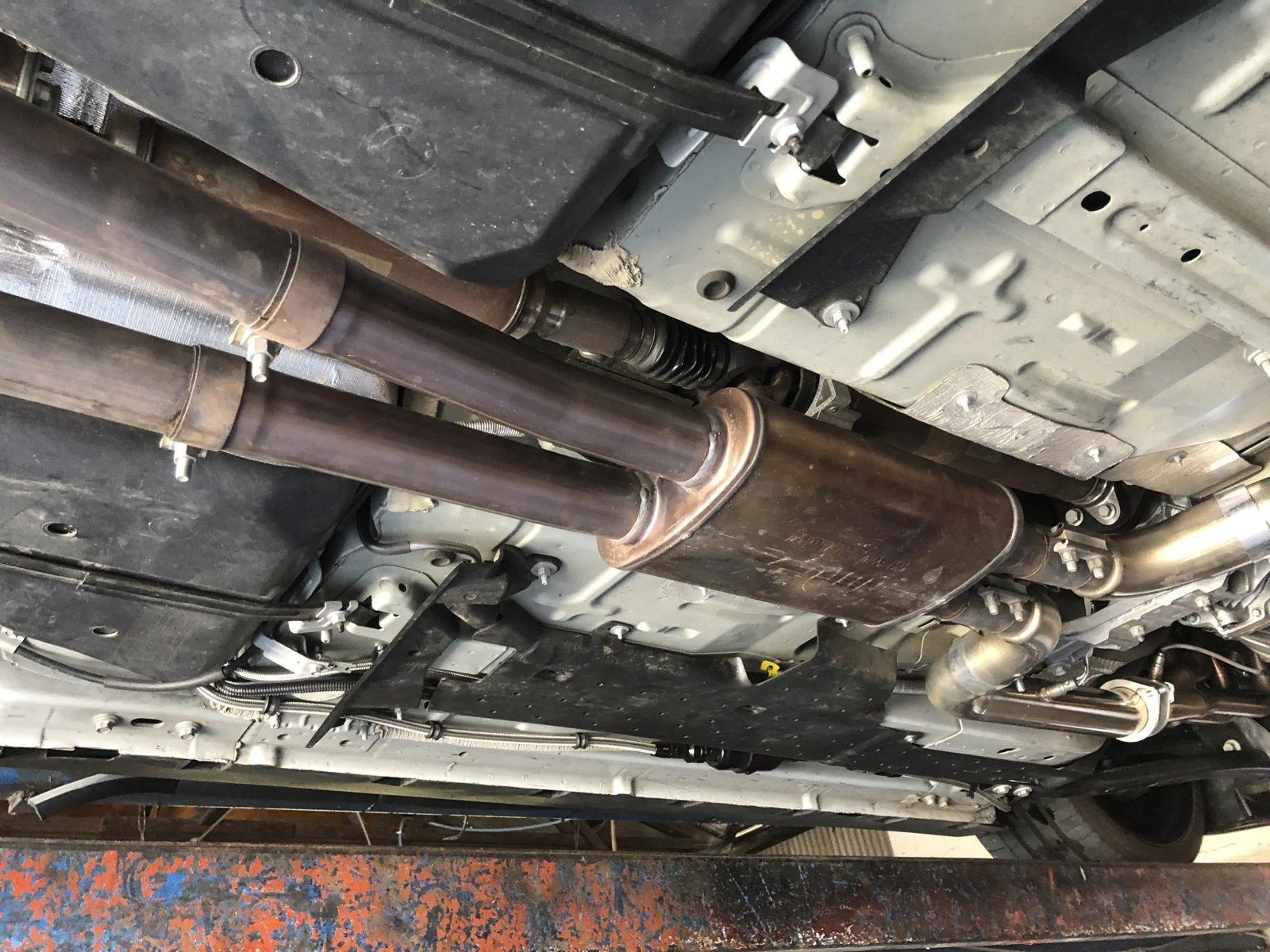

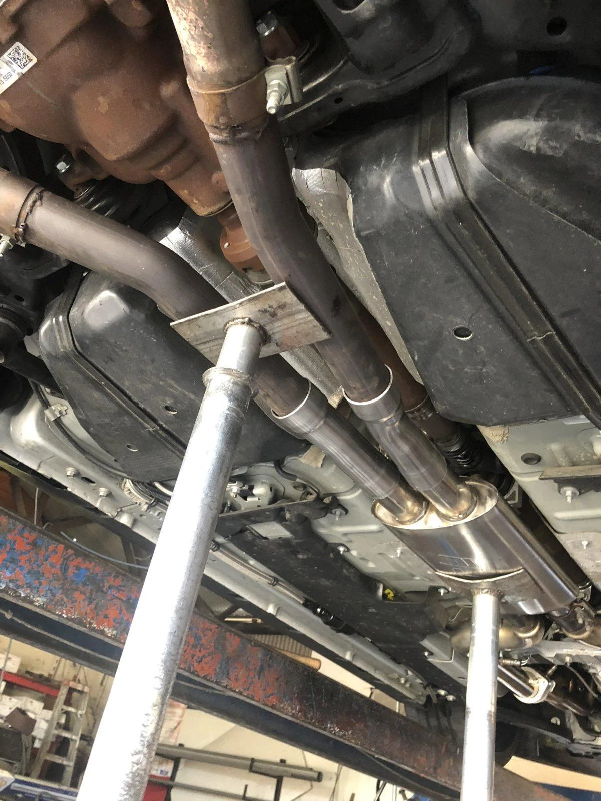

I have the Roush quad tip exhaust and the active system with it. I’m also running catless Kooks headers. I had the magnaflow setup and I still had rasp that I wanted to get rid of so I nstalled the borla resonator and got my deep tones back. My system can be quiet or loud based on what I switch to on the fly. Much happier with the borla resonator but this is of course my experience
