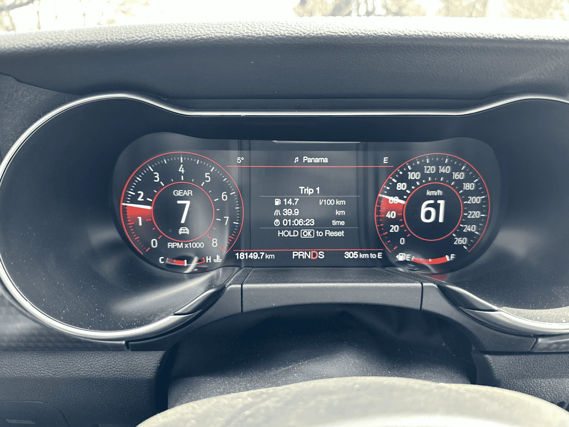

Side note, NORMAL mode with light pedal driving seems to have me at about 14mpg. Very limited seat time after filling up the tank and resetting the sensor. Will see what it balances out to with some more seat time. This is already better than the 10 MPG I was getting before after first getting it after the blower was installed. But that's on me for TRACK + PADDLES 2 minutes after taking possession post install. Ignorance and all that.
