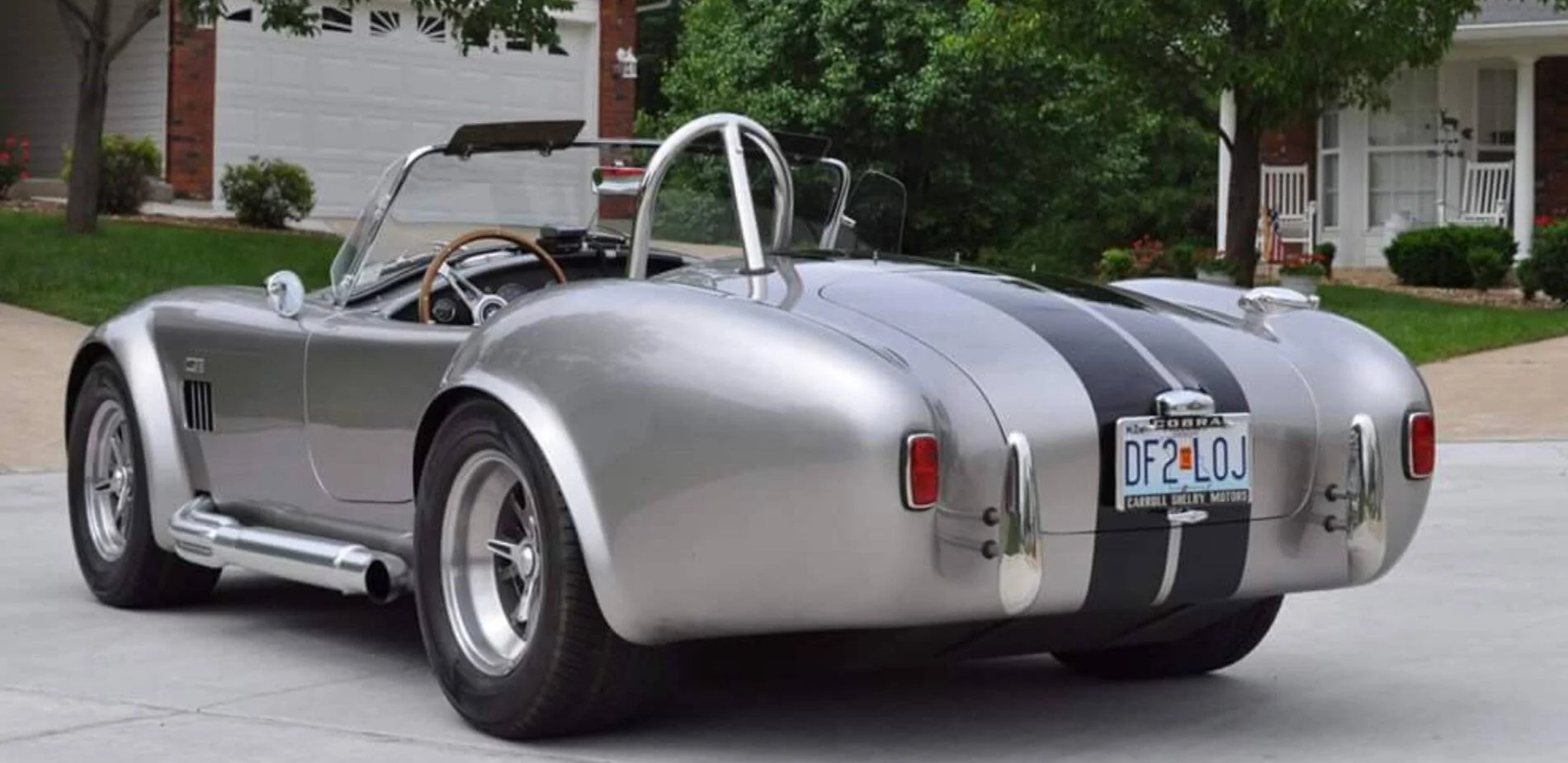

There are different levels of tuning but I've read the Roush tune leaves a lot to be desired. I'll let everyone know how it works out. I had a Superformance Cobra before the Mustang.
