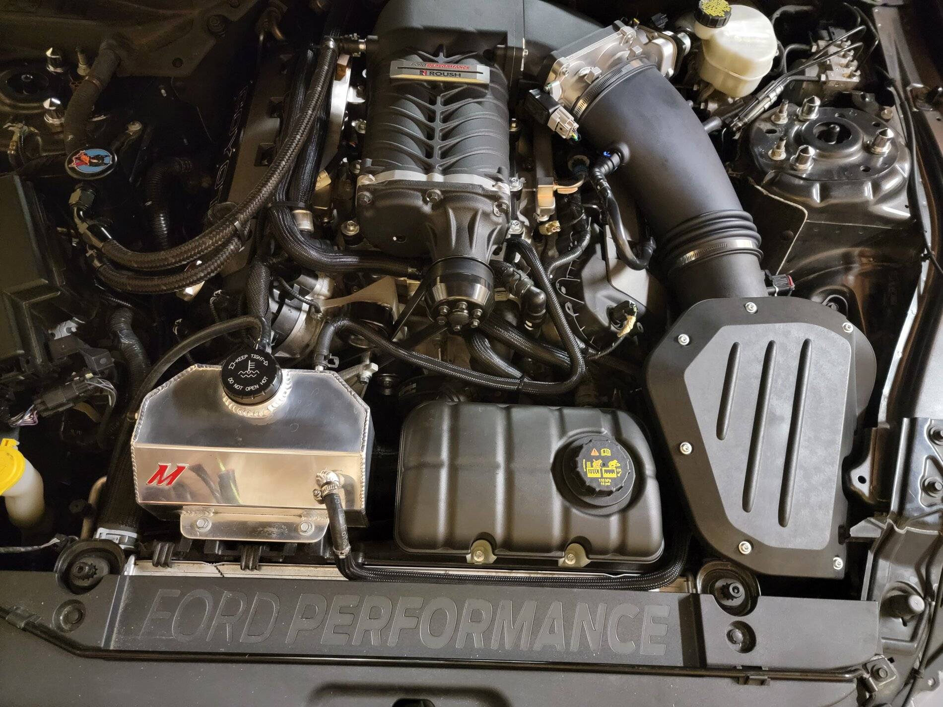

Congrats! Post a few pics of the engine bay.
I'll take some pictures later today. I got out of the shop around 4:30 and it was a six hour night drive from hell. Road construction, detours through the city of Indianapolis and terrible roads. Indiana takes the cake in that category.
They did two dyno pulls and let me watch. It was in the twenties there and the door to the dyno room had been open for quite a while as they'd just ran a dyno on another car and were helping the owner load the car into a trailer so the drum was very cold. My car pulled 612 rwhp.. about 726 crank but the tires spun some on the drum and there was a slight dip in the power line when it did so. I was chomping at the bit to get out of there so we buttoned it up and I hit the road. I don't think that the clutch slipped but it's a possibility that I'll check out today. Will post more later along with photos.
