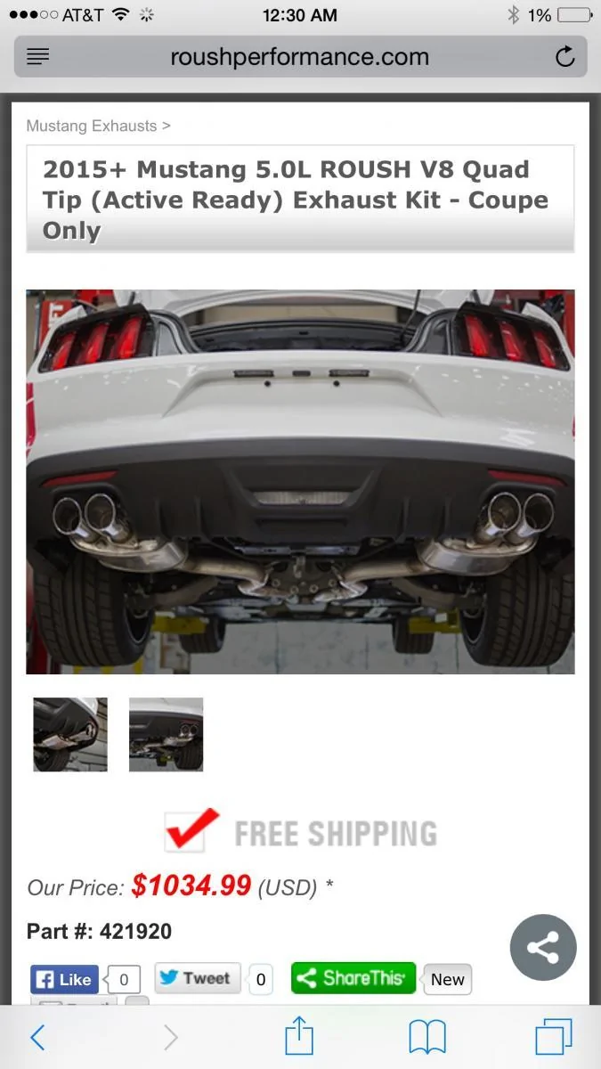

Here are some pictures of the quad tip which is prepped for the active. You can see on the inner tips that its bolted on at the muffler itself, so you would remove that tip, unbolt the blockoff plate and then attach the valve where that block off plate you remove was located and reinstall the tip.

The kit you see on the web link posted is prepped for active. So there is no valve or wiring etc. its just the quad tip setup that would allow you to leave the plate on and have a quieter sound or remove it and have the louder sound all the time. The rest of system should be coming out fairly soon.

http://www.roushperformance.com/parts/2015-Mustang-rear-fascia-valance.html
Part #: 421894
$207.99
This requires a Premium package rear valance to install.
I am going off what NPP costs from the factory for pricing. You have to remember that the muffler itself will have a straight through exhaust tunnel, and the butterfly valve will close it off and run it through another channel and out the other exhaust head. I don't know if the solenoid/butterfly valve comes with the exhaust already and can be manually set, and later on the solenoid will be electronically activated. If they are using a cell phone, iTouch etc., then it might be wireless and needs to have a wireless sender receiver connected to the solenoid. This then needs to be weather proofed and somewhat user proofed. Or it might be a direct connect to a switch in the car, makes it less expensive, but not as neat.
Then it could be in the vehicles PCM so that the user can go to the center display and in the menus, set up the RPM to open close. This would cost more also.
So in the end with the last version being used by Chevy. I would still stay in the 15 to 1800 range for a complete kit. Also to note aftermarket install on Vette NPP (In the C6) does not integrate into the cars programming (Vacuum activated), but needs a "mild to wild switch setup.
