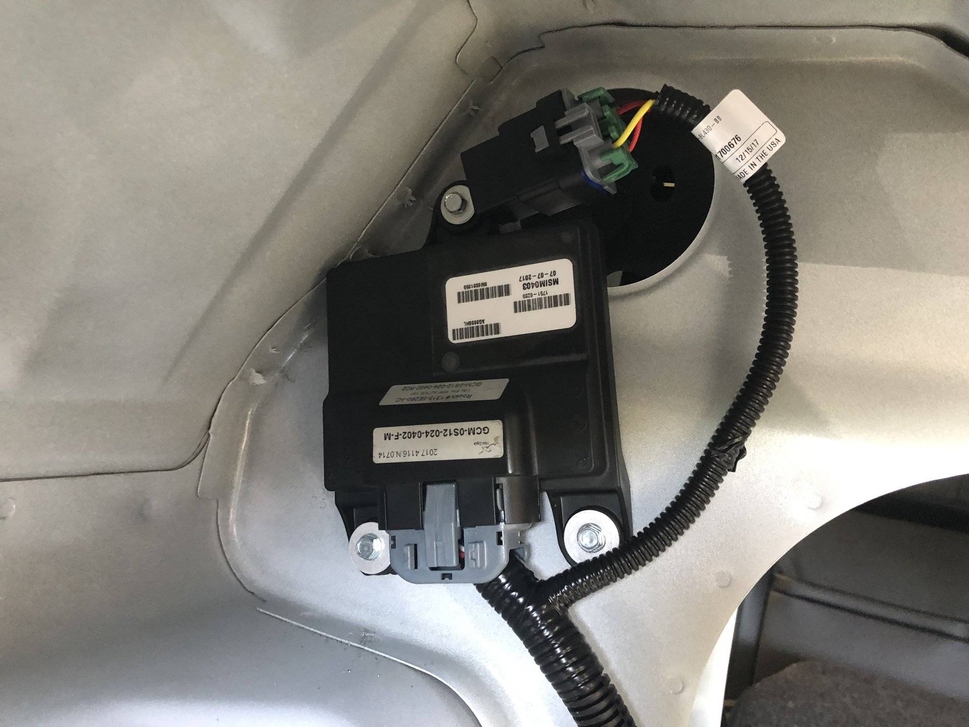

Might just need the relay replaced as that was my issue. If installed per instructions, the relay is located in the upper left trunk area behind the wall insulation. Cheap and easy first check issue.

Just don’t push it until repaired. Both valves won’t open ? If that’s the case i agree it’s most likely the relay or some other part of the system vs the valves. I had a faulty valve on mine however it would try to open and then close and the amber light would come on. Roush warrantied it and i replaced it and all was normal. Just saying highly odd for both valves to go at the same time
