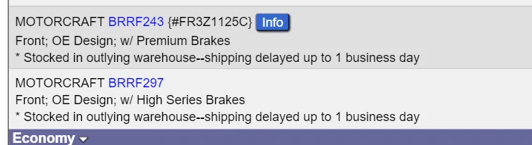

I'm looking at doing the same - only ones I can find for sale in the member classifieds are for PP GT, so they won't work for my PP EBM. Searching online finds me some from powerstop and centric. Any issues with either of them? Or should I just go Ford OEM?

I'd go OEM for blanks since they're probably the cheapest. Otherwise go with the cheapest.
Can anyone confirm which, if either of these, is the correct front rotor for the PP EBM? Couldn't confirm it on Ford's website.

dont you love the descriptions. im not sure about EB.

They are the same as the base GT, but they have the exact same options in the GT section, lol.
