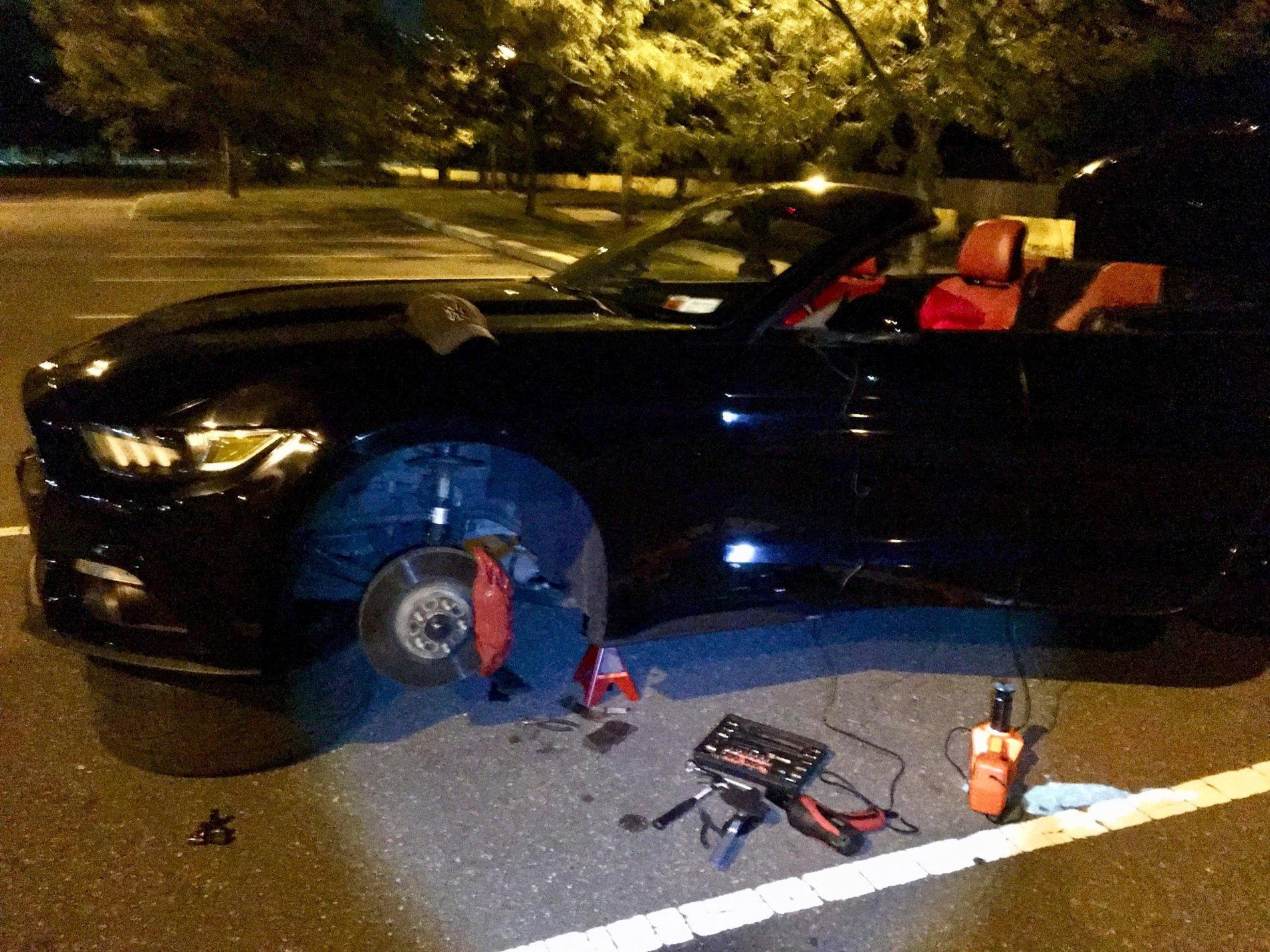

Just changed my PP pads today. Got 30k hard city miles out of them. They only started squealing within the past month and it's pretty accurate. Just take your wheel off to check. 12v electric bottle jack & impact gun makes life a lot easier. I only barely broke a sweat when breaking the caliper bolts.

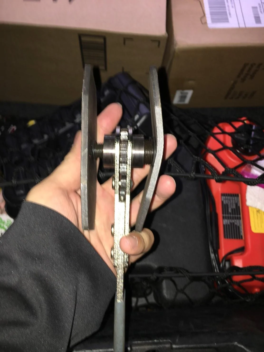

Also make sure you use a spinning piston press for your rear brakes or you'll end up like my dumbass spending 20 minutes trying to figure out why it won't budge only to bend the shit out of my press.
