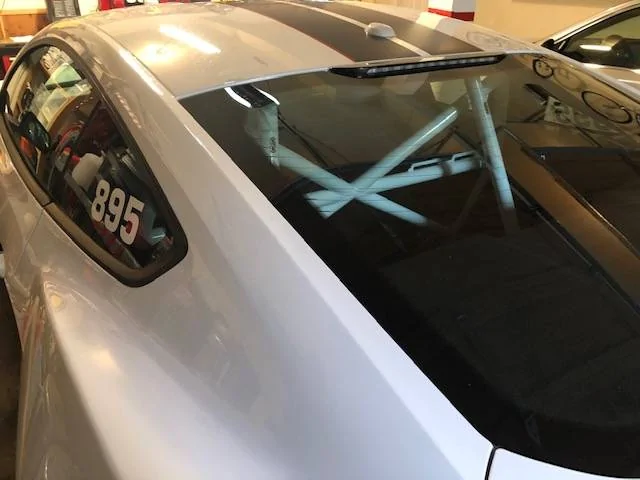

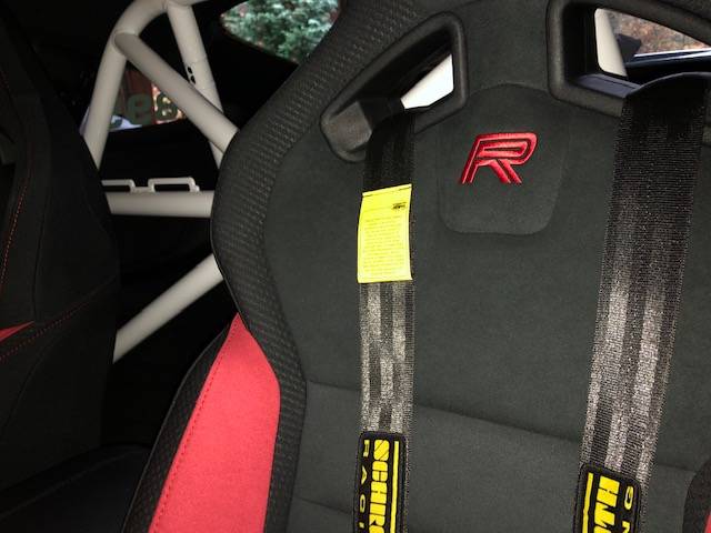

I'm looking to install a roll bar in my 350R, I've looked at CMS Performance and Watson. Does anyone have any experience installing either ones and the pros or cons to either or any other recommendations?
thanks,
meterman
I have the CMS Performance roll bar installed in my 2019 GT350R painted in matching Oxford White. fits very well, good quality. I had it installed at a local shop. I certainly would recommend it. The Watson roll bar is also high quality.
