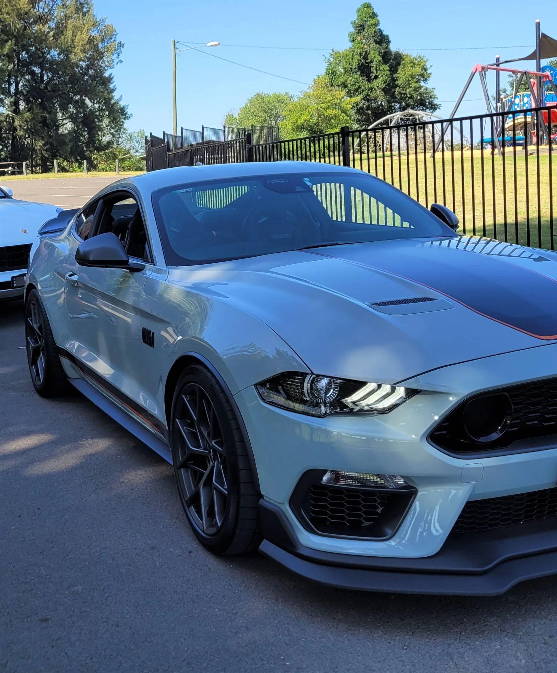

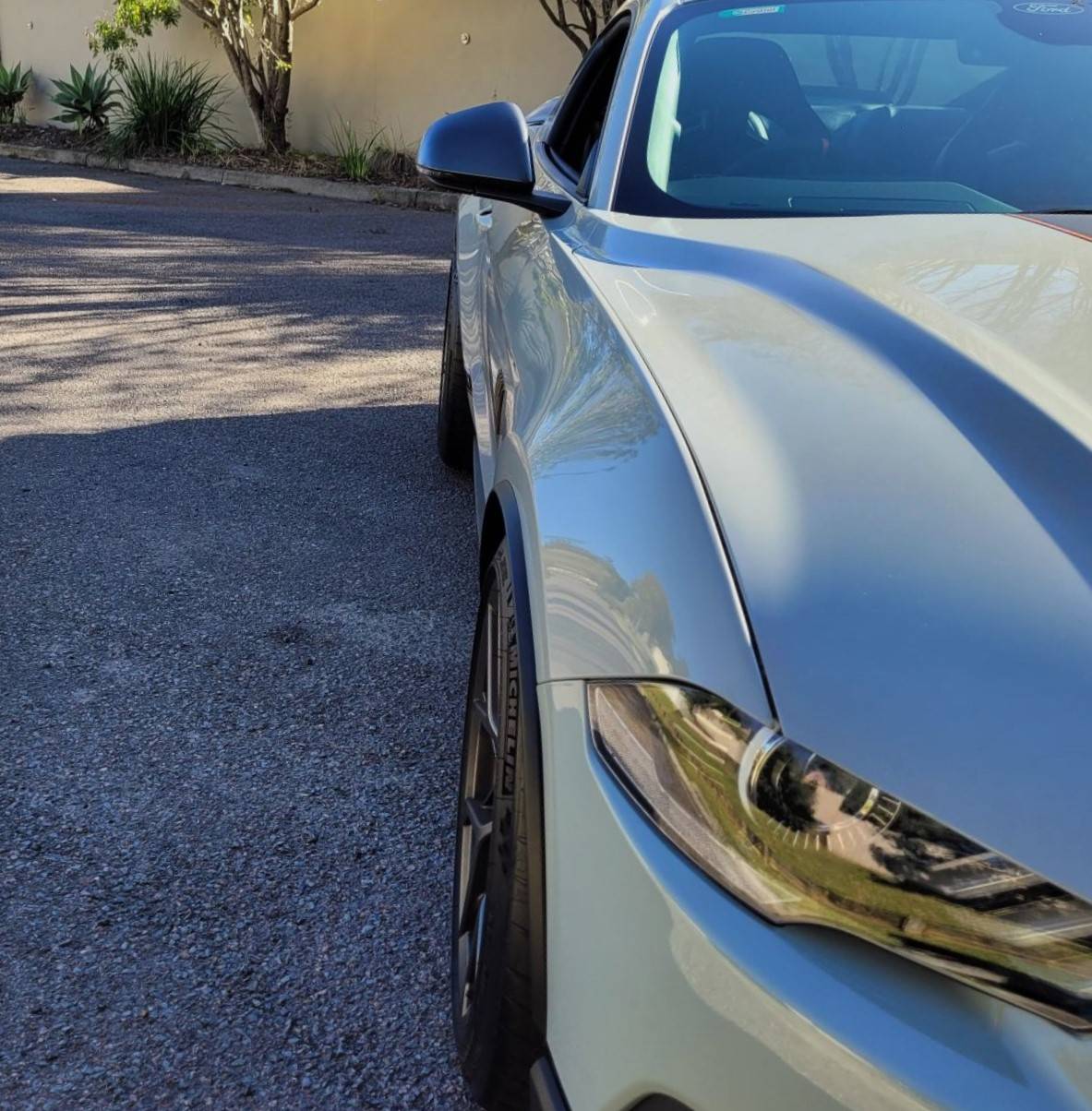

My suggestion would be to fit 285/35 and 295/35 Contis, keep your HP rims and use the money that you were going to spend on a second set of rims and buy & install a set of camber plates (Steeda or similar) with a decent alignment you can run Neg 2 camber up front and while your getting an alignment adjust the rear to Neg 1.2 , the front camber will reduce the front tyre poke to zero and the car will handle noticeably better. Pic below of this set up.
As a non-HP Mach 1, the 295's on the rear will get your speedo closer to its original setting, your tramlining will be completely gone with the Conti's and you will have a fraction more front-end height to keep that splitter from bottoming out.

Looks great,
I assume those are the continentals you are referring too, also do you have them fitted on original 10.5 and 11?

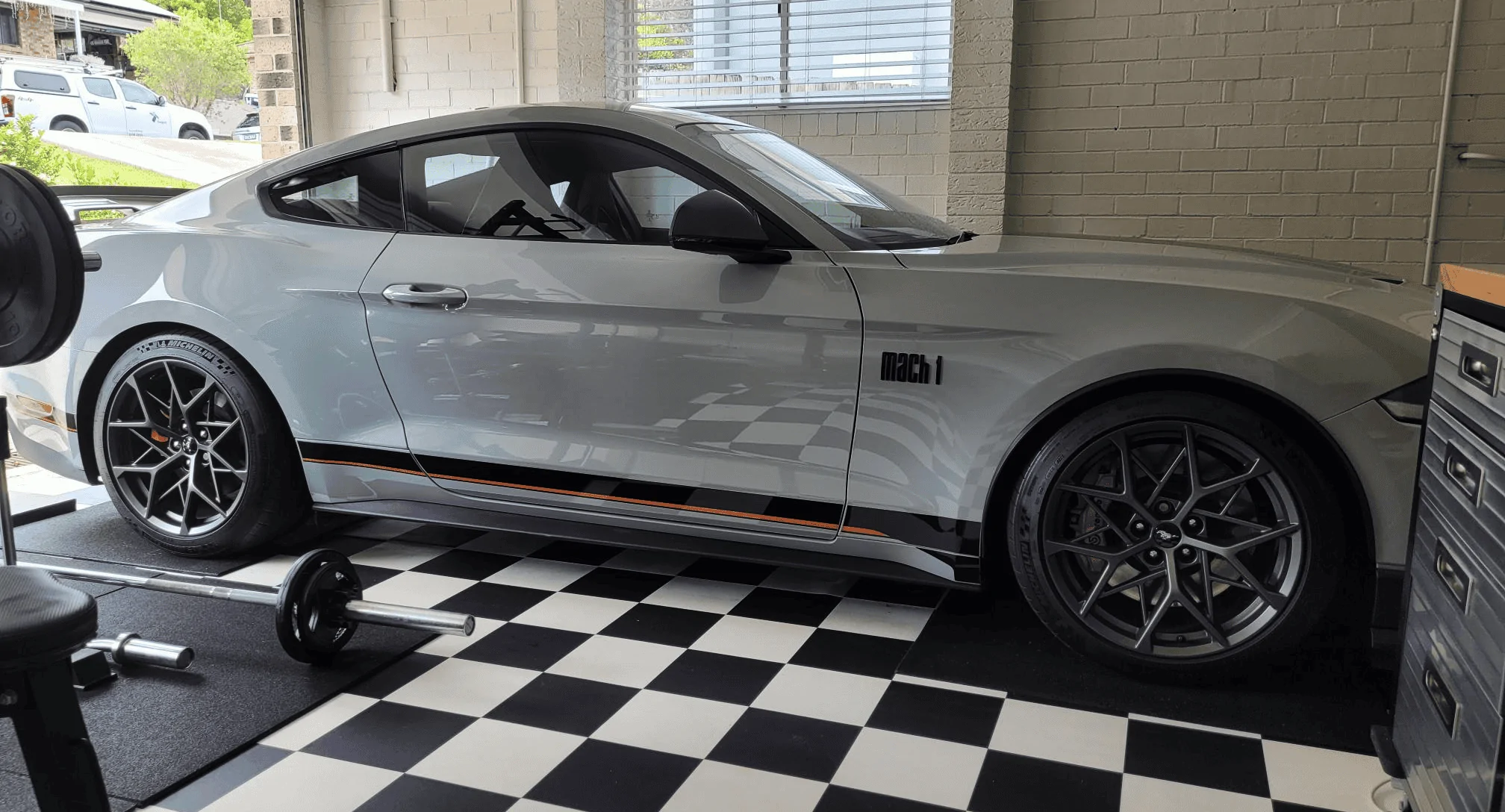

Yes those tyres are Sport Contact 6 Contis, I have since changed to 295/35/19 and 305/35/19 Cup 2 tyres as per the below pic. Wheels are the standard Mach 1 HP wheels 10.5/19 front and 11/19 rear.

The sport cups are awesome tires I’m sure you already know, good choice,
I need to pick your brain if you don’t mind,
So with the 295s upfront and the slight Camber adjustment, your front wheels almost look as if they are flush, also I noticed your rear sits nice With not much of a wheel gap between tire and fender, are you running a factory handling package with original springs? Did you do anything to your suspension, again it looks amazing.

Car runs mach 1 handling pack springs, Steeda camber plates, neg 2.2 front camber, neg 1.5 in the rear, No other suspension mods.
