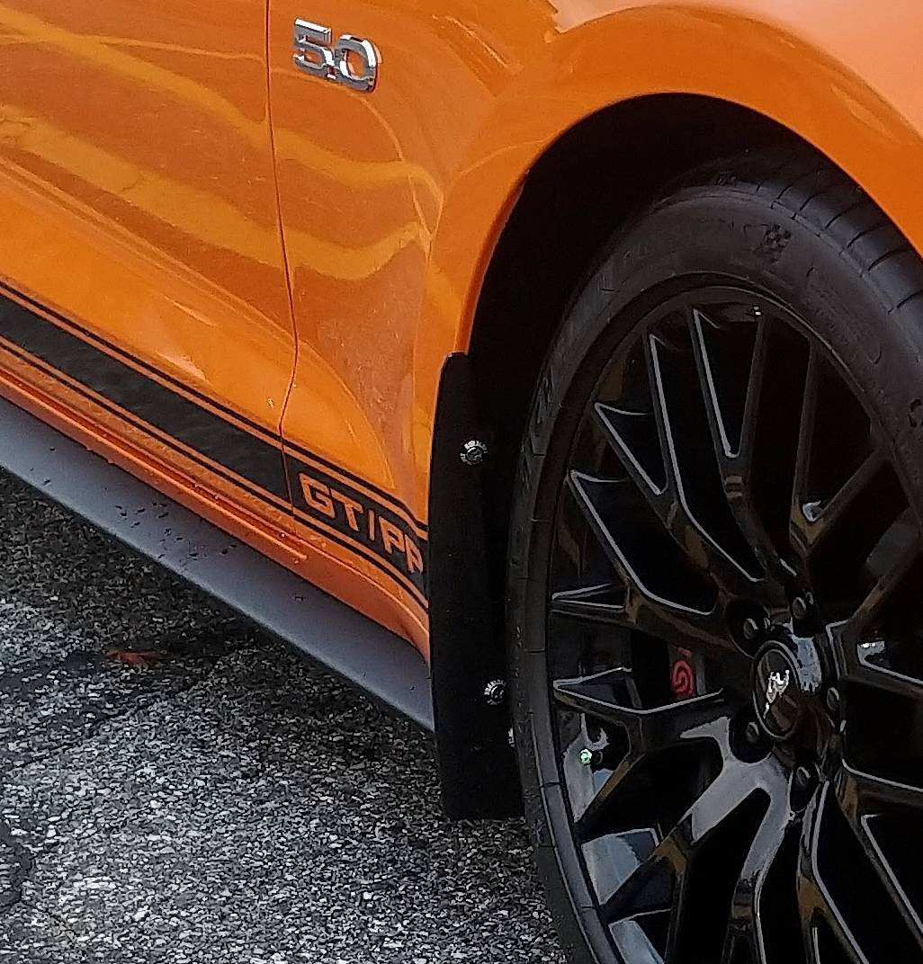

I got a full front and rear set for my '22 and started the install this AM.
I got both lower screws tightened as well as the top screw/clip tightened.
There is substantial play at the top and the guard is easily moved inward and outward. I assume this will chew up the paint on the fender edge.
I'd be glad for anyone's thoughts on this....I've also emailed the company.
I can't imagine these install loose like this...

Here’s what I wound up doing. It seemed if I adjusted them a little further out at the top they had less movement. Where they touch the paint at the top, I put a thin strip of paint protection film to protect the fender lip edge.They are very firm at the bottom I can’t imagine they’ll move much at this point

Well, I got them on. As mentioned above, a little strip of PPF at the very top.
I also found on the fronts that the clips weren't seating into the holes in the flap at the top. I was able to adjust that, which helped. They are very secure at the bottom.
I'm thinking that if the flaps weren't quite as long at the top....it might be better. Gonna contact the firm and see what they say. I'll report back.
