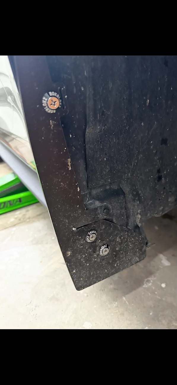

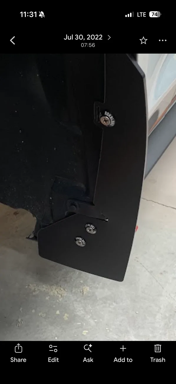

Rokblokz, just trim them around lower section of the HP lip for a better fit. I've used them in GT size and PP2 size (PP2 has same wheel size and offset as HP). I'm currently using GT size because I run enough negative camber on my 305's up front that they tuck in nicely. PP2 size looks too much like a truck or something you'd see on a WRX.

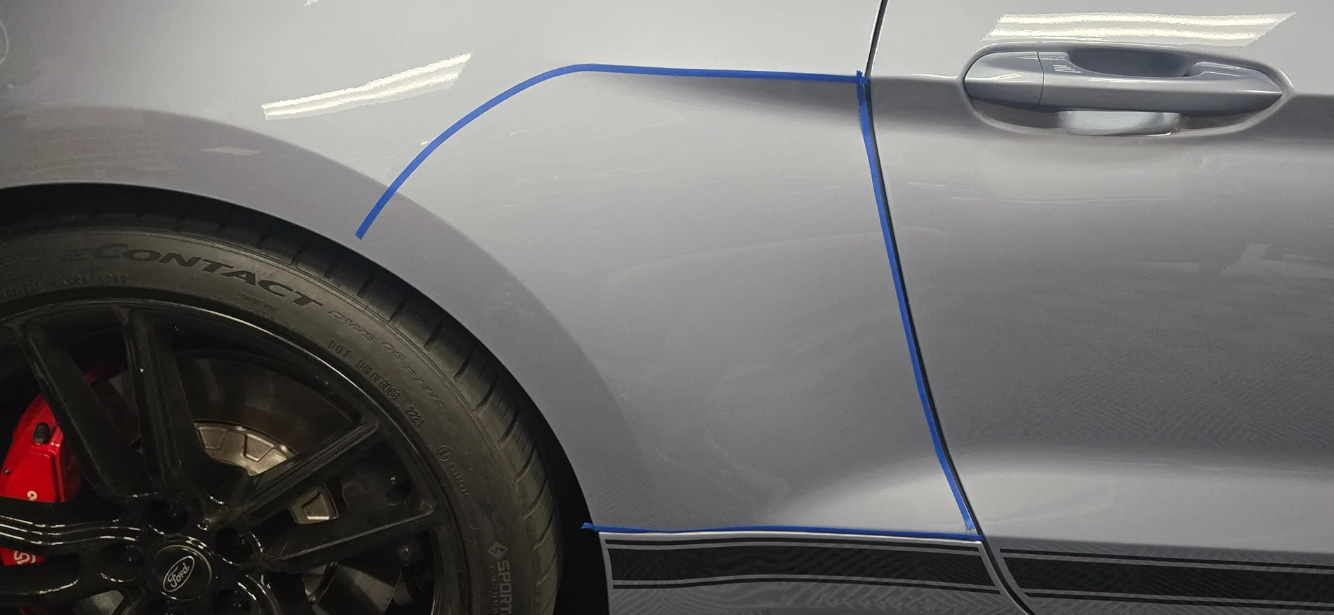

That area in front of the rear wheel is one of the easiest places to DIY PPF. Order a 24"x54" roll on Amazon for $25 bucks and you'll be able to do both sides. A little touch up paint before you apply the film. You'll never see it.
Make yourself a pattern similar to this with construction paper and trace it out on the PPF. You'll never get a chip there again.
Extend the pattern into your door jam if you can.
I paid 10x that for professional install, which included the rear part of the rocker panel. I have done PPF on small sections of cars with no issue. Maybe I should have tried this one myself. Only risks $25.
Is that Brittany Blue šŸ˜šŸ˜?
My GT size RockBlockz came in Friday. Do you have any pics of how you modified yours?
I lied. I just found some old pics one is with PP2 size the other is GT size. I’m not the only one that has trimmed them this way but it allows them to sit more flush when viewed from the side. I’ve been running them this way since 2022.

Exactly what I Needed! You are the Man!
