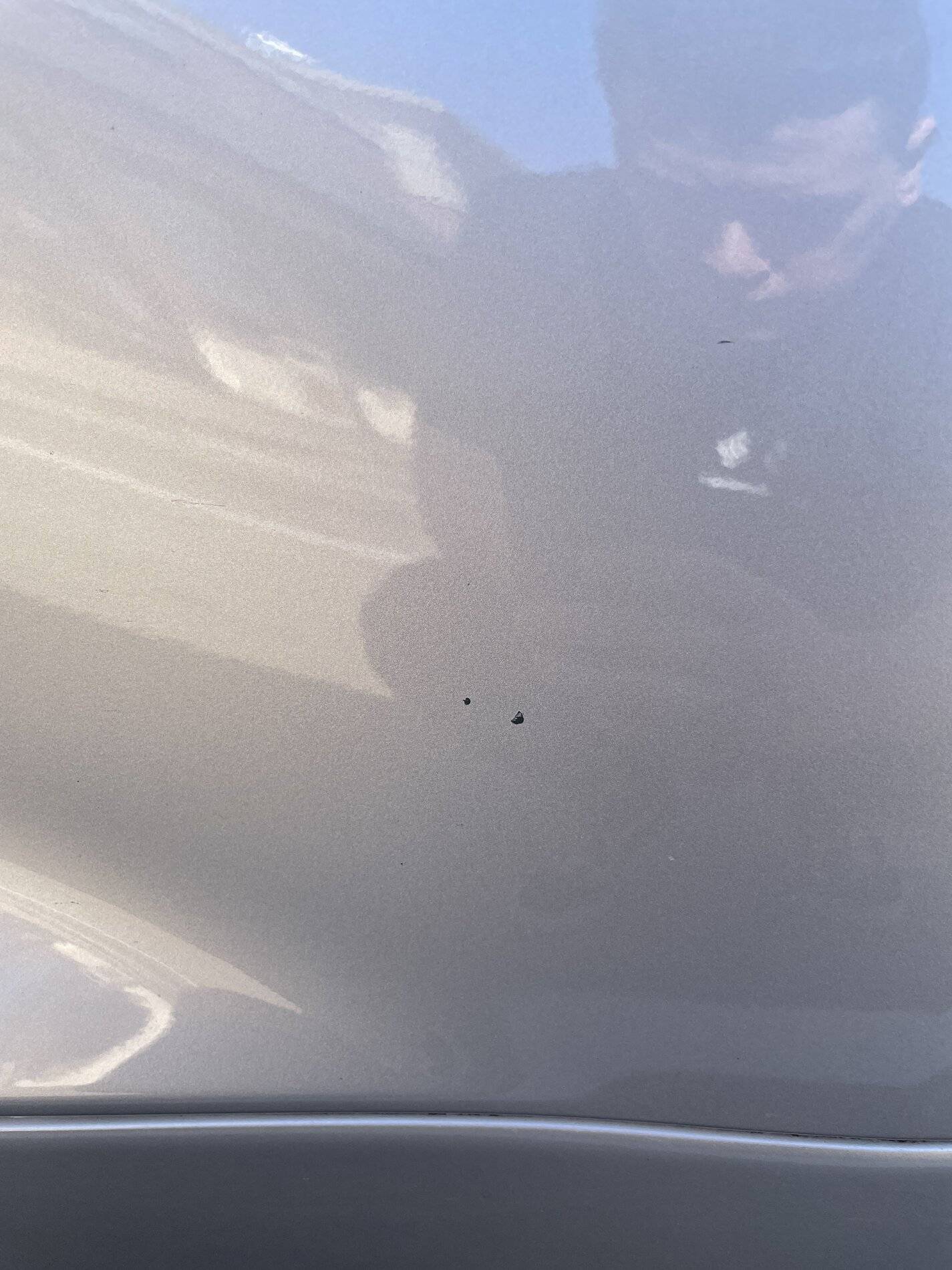

What are some good touch up kits that will help the appearance a bit? It’s not that bad but I know it’s there.
I plan on touching it up when spring comes around and I’m able to do a full detail. There are a few other spots on the front bumper about the same size.

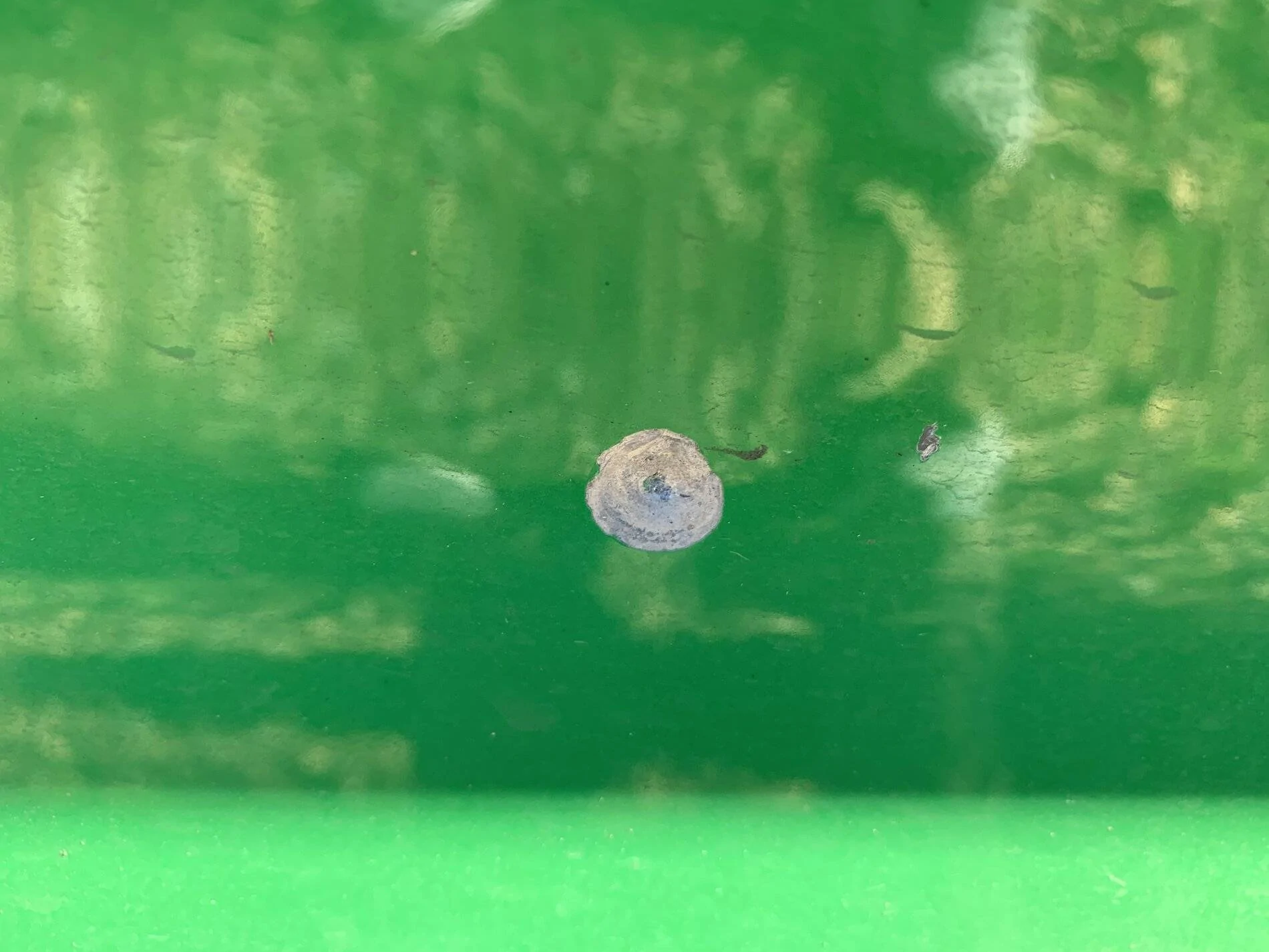

Rock from a lawn mower! Almost went trough the door. What sucks is I had her ceramic coated.

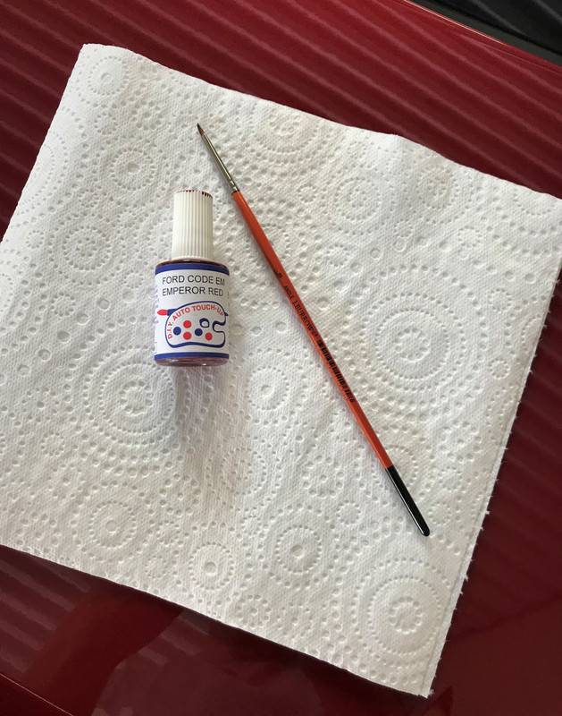

I use the Ford pen and just dab and let the paint from the tip fill the hole. Comes out pretty good, you can't see it unless you're looking for it. There's different levels of doing the repair, you can do multiple coats to completely fill in the chip and then sand the surrounding area to blend it, if you want to spend the time on that.

I bought the touchup paint and the Loew-Cornell painting pens from the video.
