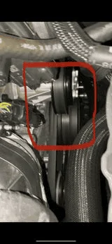

zstanny
zstanny
Jan 30, 2023
93
128
Huntsville, AL
Zac
21 Mach 1 HP; Prior:20 Camaro SS 1LE, 17 GT350
Update on this. The noise can be best heard in the area I've circled. Towards the sides of the motor, and towards the back(windshield), it's less pronounced. To recap, dead silent for 20-30seconds after cold start, noise occurs, lasts 60-90 seconds, then is gone until car sits over night and is started again.
