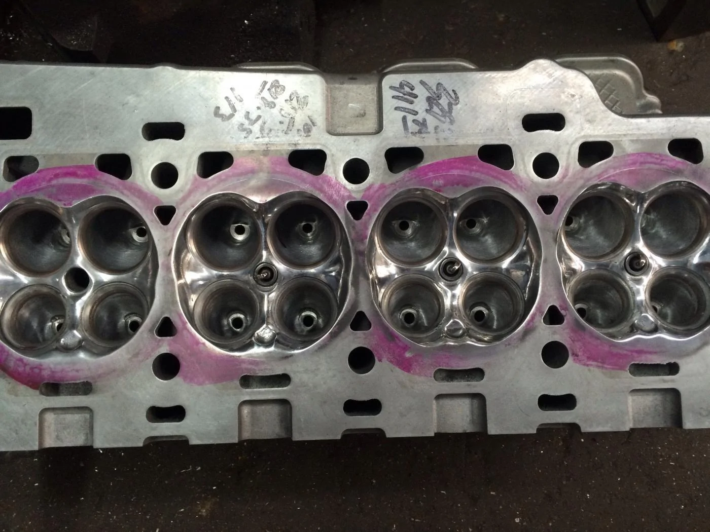

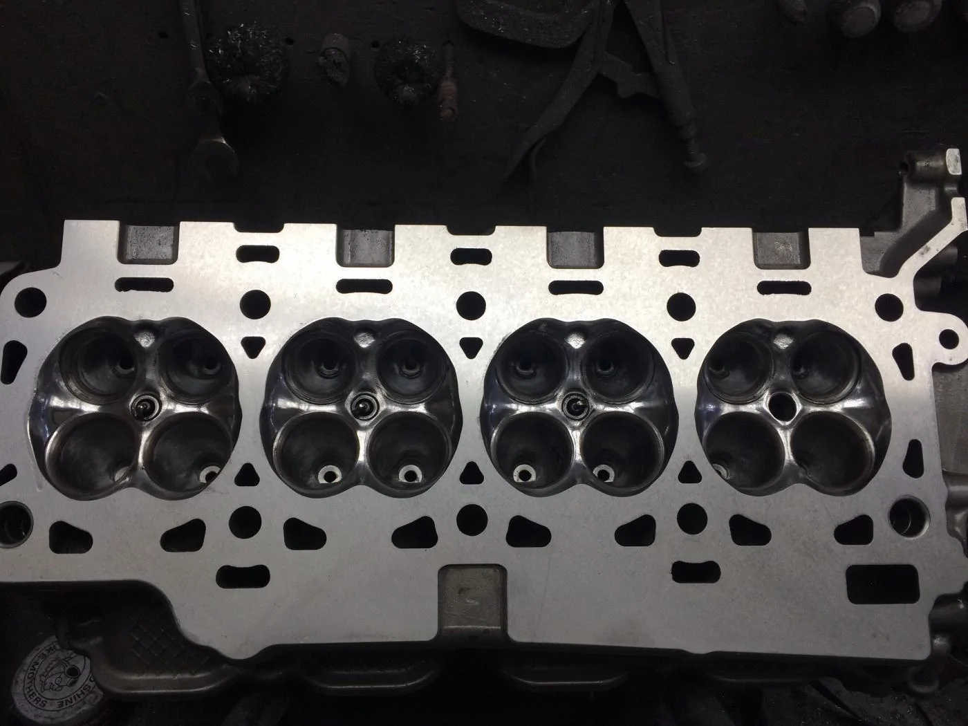

Minimal amount
I don't want to start affecting cam timing or changing geometry too much
So it's just going to be a clean up pass
I'll cc the chambers for u

After looking at the combustion chamber I don't think these are voodoo heads.

There voodoos
Factory cnc heads
I'll re measure the valves. I might have swapped those numbers around

I understand they are cnc factory. But the chamber is not the same as a voodoo from the pics you posted. Do you have a pic of the exhaust port header flange surface?
Also the coolant passages on your heads are not the same as a 5.2.

Interesting. I will take pics tomorrow of that
I was advised these where voodoos. Maybe you are correct
