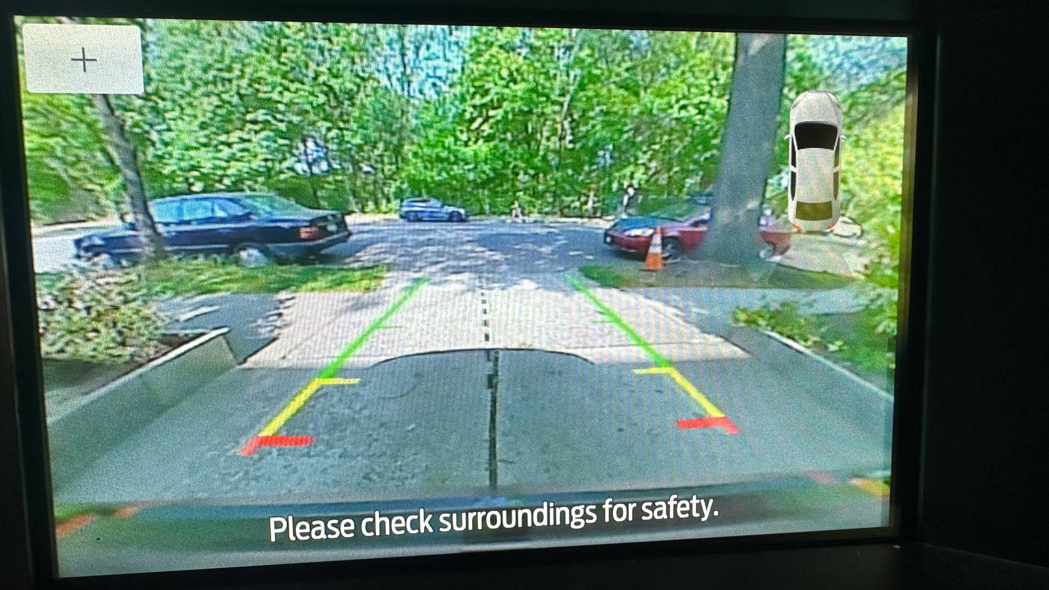

I noticed yesterday that the guidance lines on my reversing camera have gone, have tried absolutely everything to get them back with no luck.
I know they can be turned on and off with the advanced park pilot option, but thats turned on (the picture of the car in the top right comes on with the radar around it)
I've tried disconnecting the battery, doing a master reset within the Sync options. Car has been driven several times inbetween trying to fix it.
Aside from going back to the dealer i'm out of ideas, anyone else had this?

Fixed it, OBD adapter & Forscan to the rescue. Ran a DTC scan which showed the car throwing a B115E - Camera Module code.
Reset the BCM & APIM using Forscan and the lines came back.

If anyone is still having issues with their reverse guide lines I did a camera recalibration in forscan and got them back. I did the camera recall that ford put out and lost them. You’d think Ford would do the recalibration right. Saved myself a trip to the dealer with a possibility of getting charged for what they would probably call an update recalibration.
