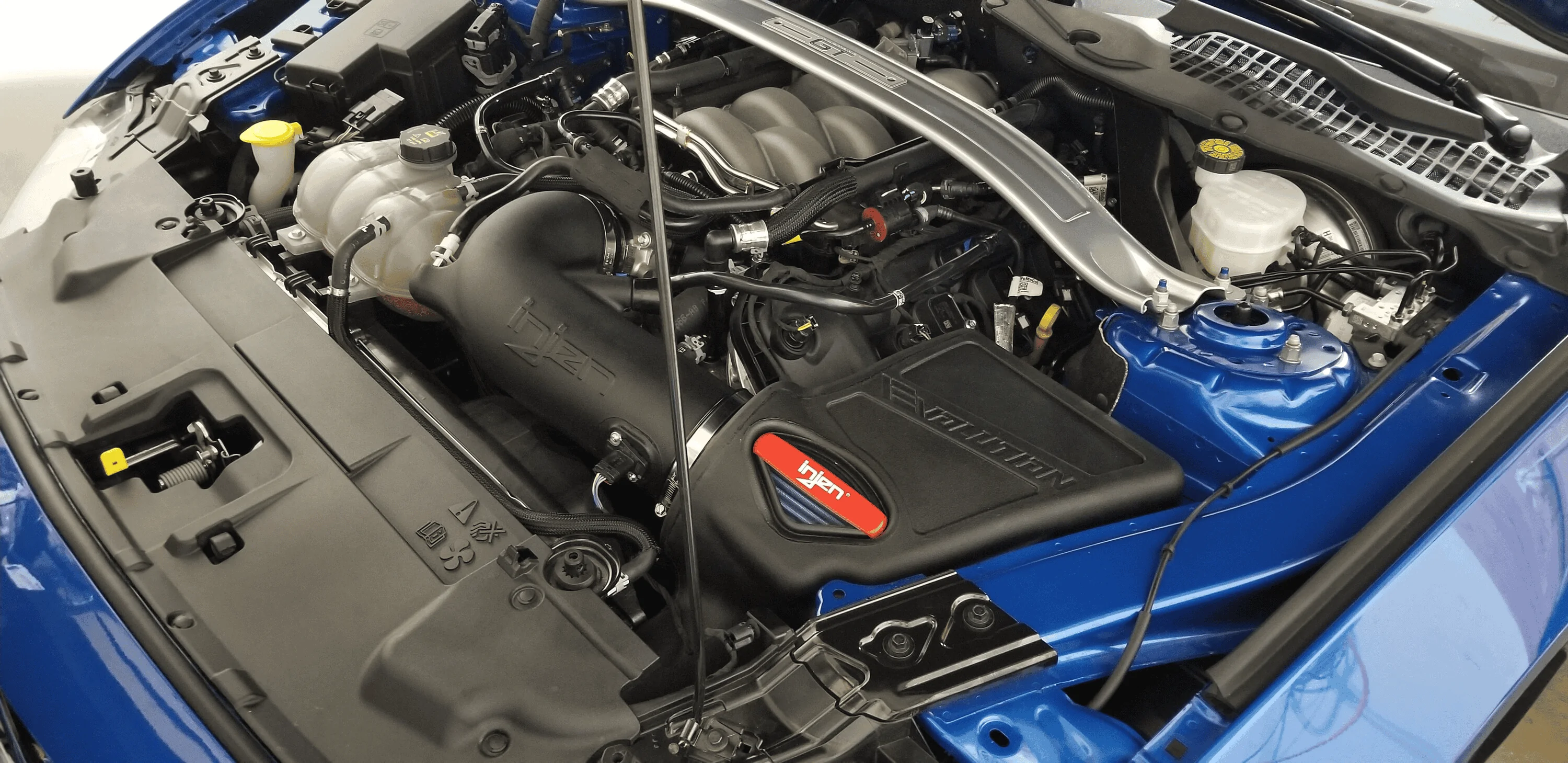

I would agree. I have the Injen EVO9202 sealed intake. Claims a tune is not required with stock calibration and that is true as it works as a drop-in replacement for the stock box. But without a tune the 25HP gain is not attainable. Maybe 1 or 2 HP at best due to increased airflow and a smoother intake tube. My uncalibrated butt dyno can't feel any difference. The intake is really nice though and I'm seeing the exact same IAT's as I had on the stock box. It takes a long time for the box to heat-soak sitting still. The plastic being as thick as it is I am not surprised. This also means it holds the heat a longer once you are moving forward. Highway cruising I am seeing 4 C above ambient max.
That one looks good too. The stock intake is excellent, but it's definitely not a looker, lol.

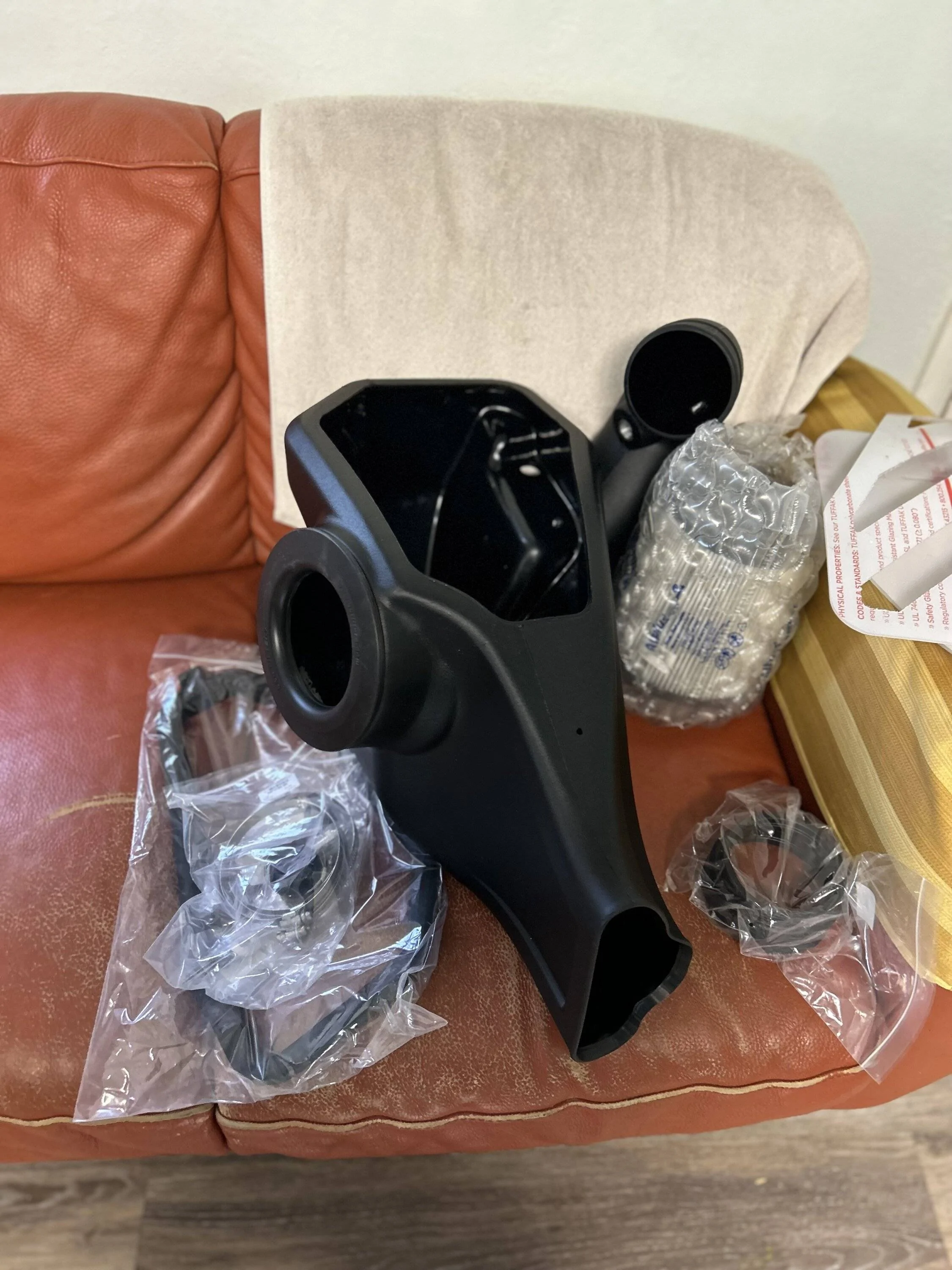

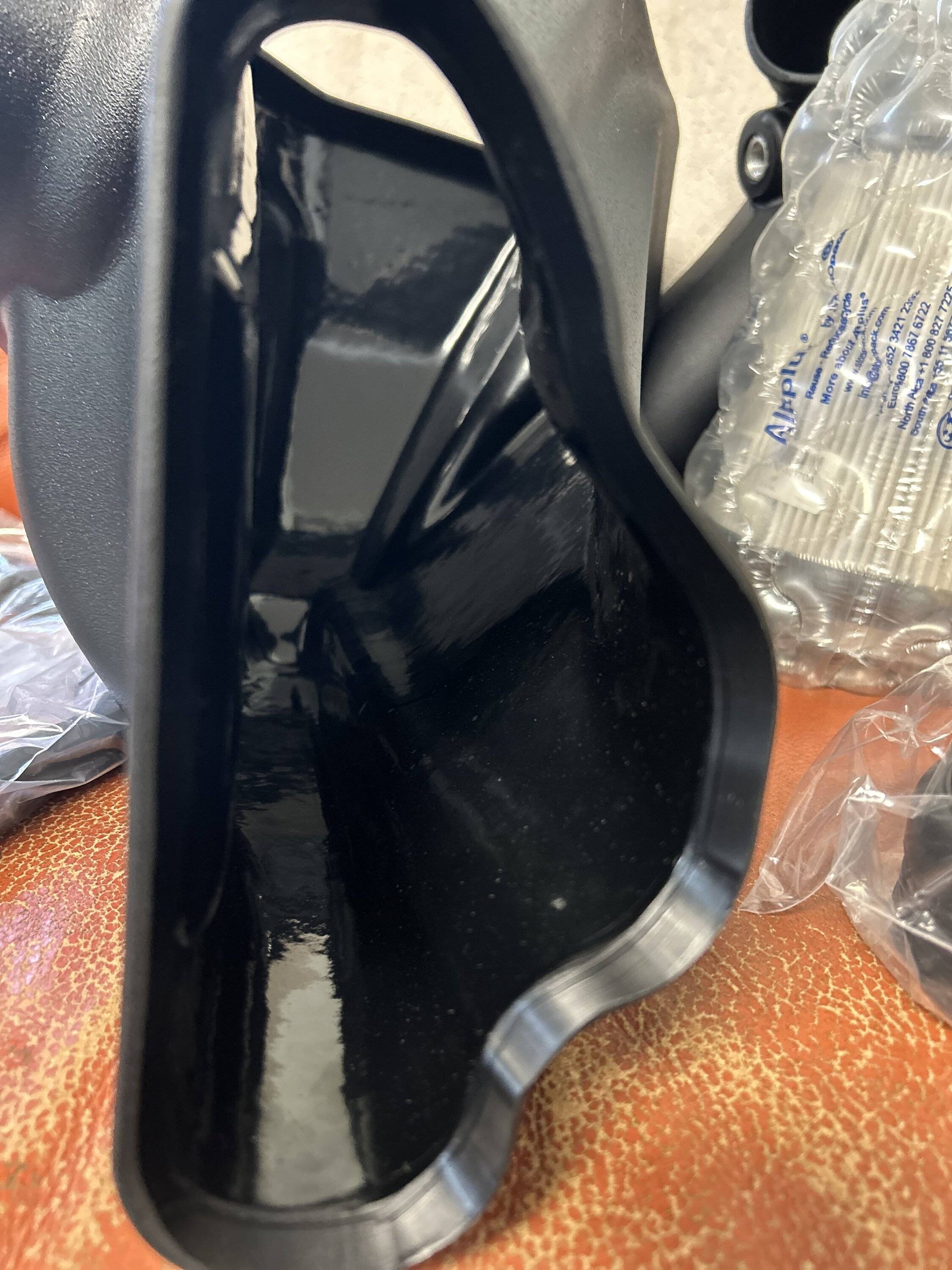

It’s here. This is the full kit and I have to say I’m impressed with the intake. Nice solid build. Very durable and the plastic is thick. Here are some pics. It’ll go on tomorrow.
Nicely packaged
Here’s the rest unpacked

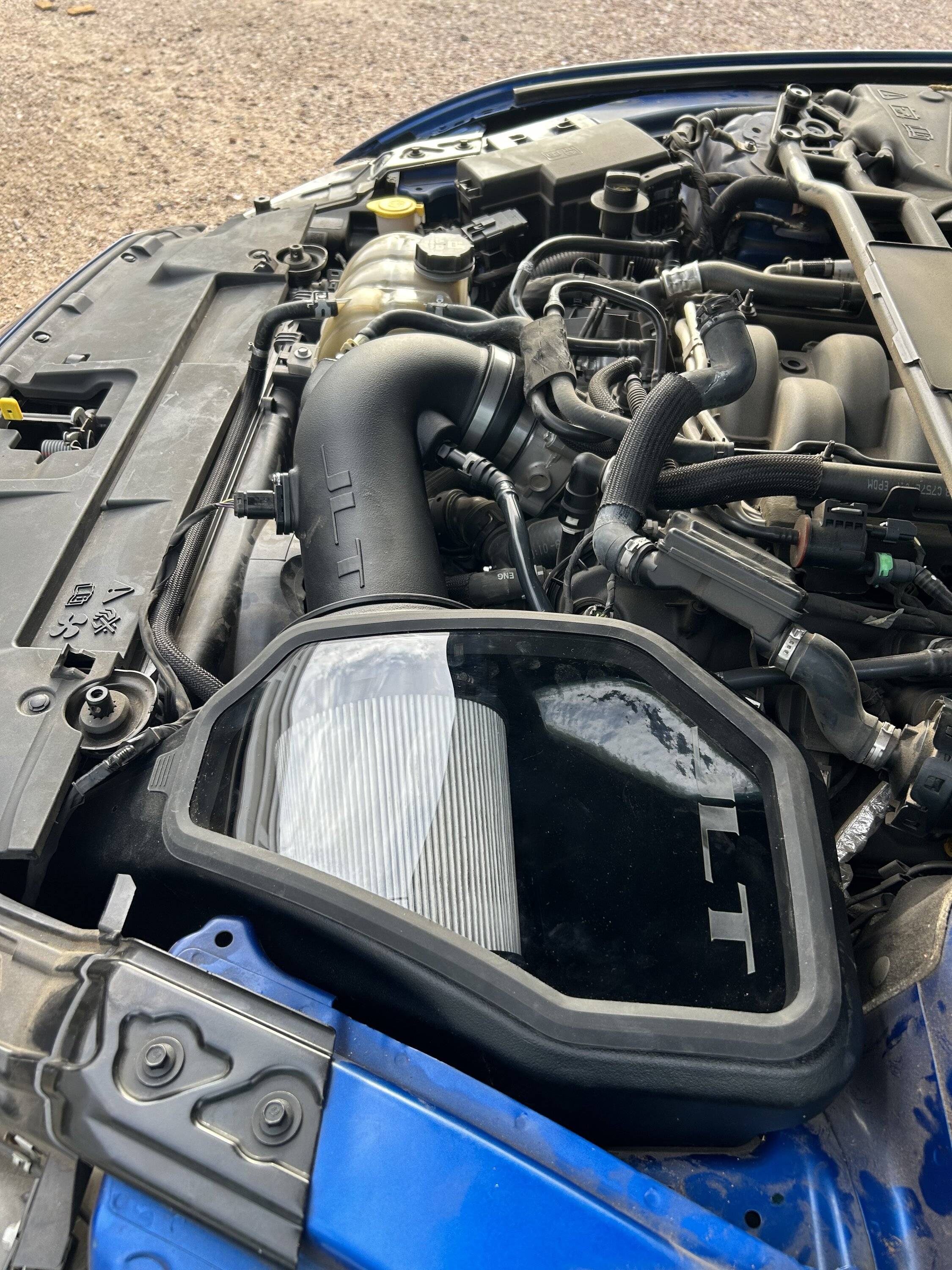

Fairly straight forward. Easy install solid fit
Nice looking intake! Can you feel a difference on your butt dyno? How are the IAT's?

So took it for a quick spin. Did a highway and street run. The IATs didn’t go beyond 6*. My car said it was 99* outside and the IATs went up to 105* as long as the car was moving. Definitely a win. The exhaust note got throatier and my butt dyno didn’t experience anything out of the ordinary. 😂 Take that as you may 🤣🤣🤣
