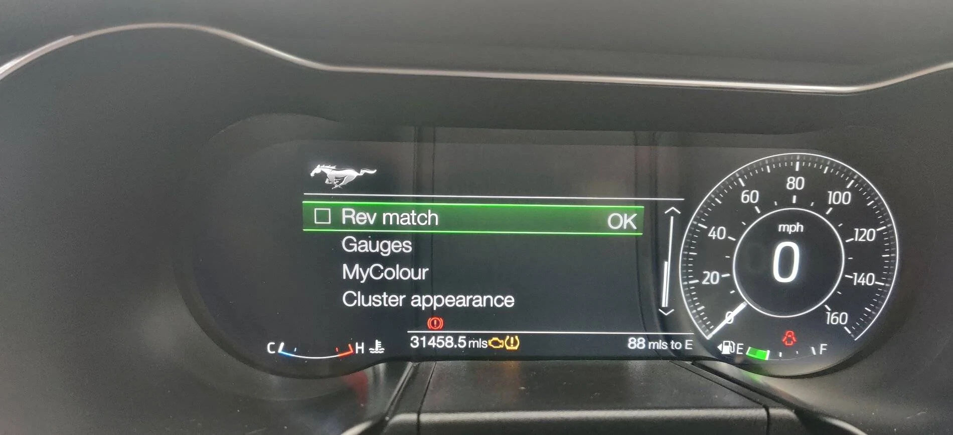

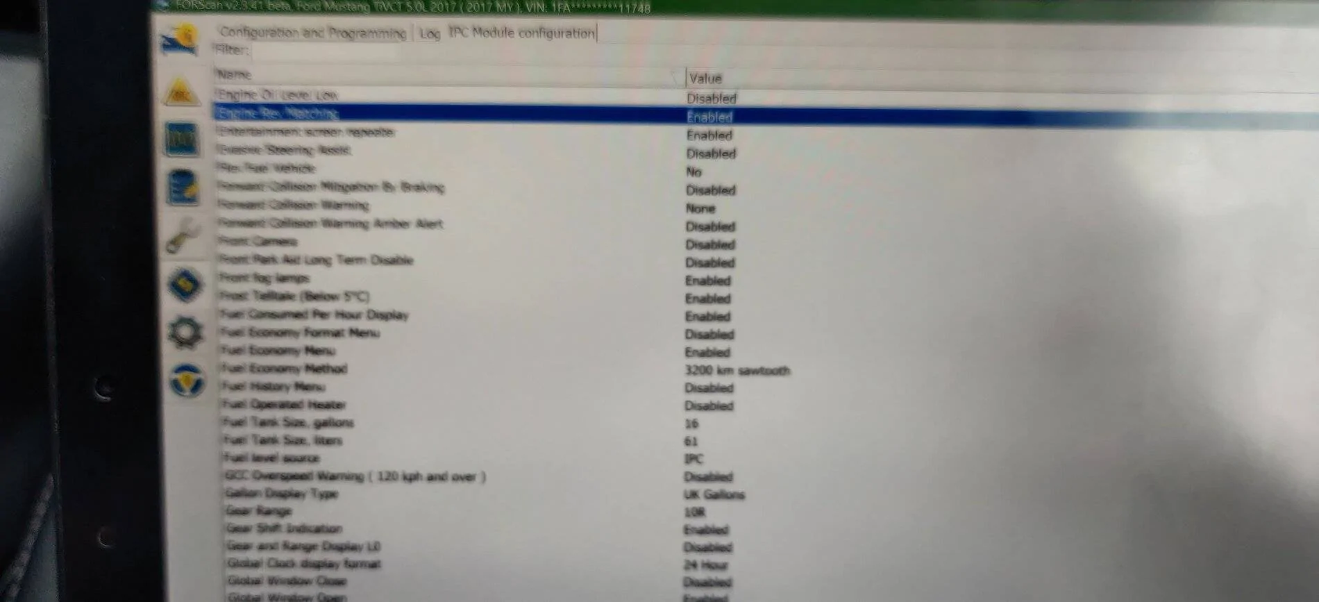

I've just had a play with forscan and mine is a retro fit IPC into 15-17 and you can activate rev matching to the cluster and the gear telltale but I can't turn it on or show the gears as I don't have the hardware, I've only read half this thread so far but it's looking like its mainly 19 gearbox related so would need to be retrofitted.
I'd be very keen for this retrofit!
Sorry rubbish photo but it's a preselect option in forscan now:
