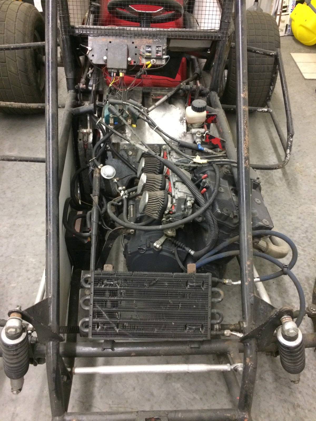

I've got an older oil cooled GSXR750 mounted sideways in my midget sprint car. It's got bigger 40mm Mikuni's and runs on minimum 100 octane. It's definitely got a little attitude.
Hehe. Looks like something straight out of the ancient movie "FlĂĄklypa Grand Prix," also known as "Pinchcliffe Grand Prix" .
