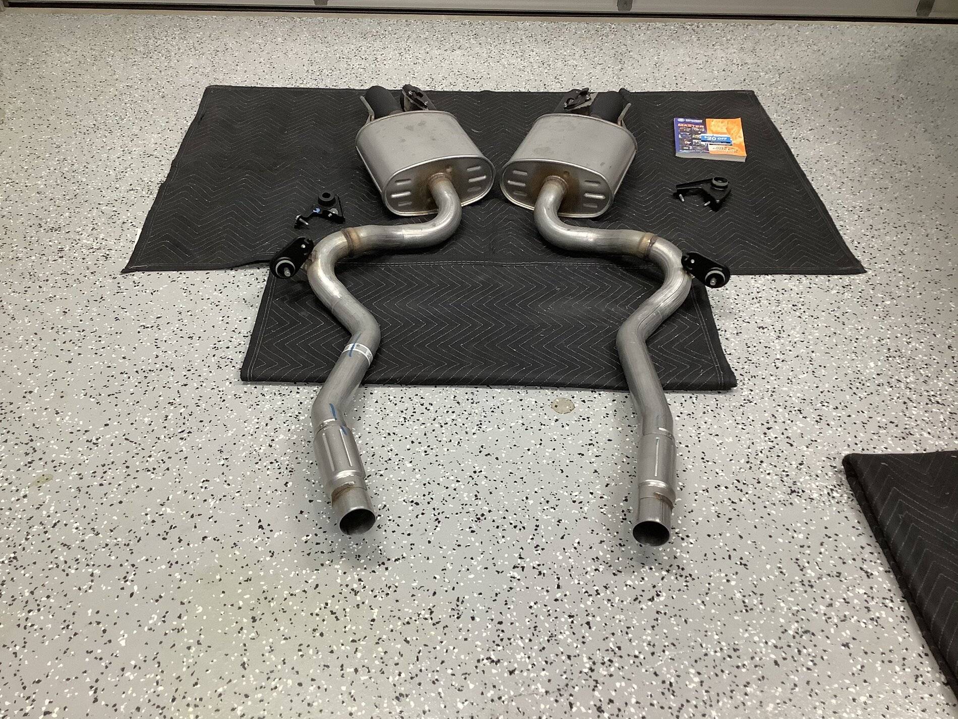

I recommend dropping the whole exhaust if you want to get your cuts straight. I bought a ratcheting exhaust cutting tool from Eastwood Tools to aid me in making nice clean cuts. Note: I did use a cutoff wheel to make the first two cuts at the rear of the resonator, after which I used the ratcheting tool. In addition, I bought better/thicker clamps from Amazon.

My Steeda X-pipe uses the factory clamps at the front, but I had the exhaust shop expand the rear sections of the X-pipe for slip joints. Then I had the shop weld the rear of the X-pipe to the axle back portions of the stock exhaust. No leaks to worry about.

Whichever way you decide to cut them (on/off the car), Steeda’s measurements for the cuts are spot on. Don’t forge to make sure that the exhaust tips are even out the back. I spent a considerable amount of time aligning mine. I also torqued my rear clamps to 50 ft-lbs and the factory front clamps to 35 ft-lbs. I had read that several people were having trouble with their exhausts sagging or twisting after an h or x pipe install. I’m guessing that happens as a result of not properly torquing the clamps.
