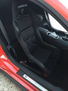

They look nice.. when I'm back in the US I'll go up to the local motorsports guys and try sitting in 'em to see if the bolstering will keep the blood flowing on long drives. Do they mount at the same height as the stock seats or lower?
Which mounts?
Are those bottom mount or side mount seats?

What are folks using for mounts? Fixed mounts, adjustable? Whos mounts?
Looking at getting a set of sparcos with much deeper bucketing.
panic
Aug 26, 2015
228
39
Spain
2015 Mustang GT
I have bottom mounts specific for the corbeau seats, all from pony parts...

So are the mounts and sliders lower than stock (so that other Corebeu seats could be used) or is the base thinner on the FX1?

I don't have any experience with seats like this. They don't recline right? Is their a reclining version of these or does that defeat the purpose of them?
