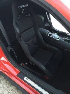

Planning my soon to be acquired car out. Looking at weight reduction.
I don't have any experience with seats like this. They don't recline right? Is their a reclining version of these or does that defeat the purpose of them?
The seats don't recline but they're more comfortable, much much lighter and keep you in place in fast driving through the bends.
It's by far the best and most urgent mod you want to get for your Mustang.

So what do you do to keep the airbag light off when you install aftermarket seats?
Adding the proper resister is the typical solution. I haven't seen anywhere yet that someone has worked out what is needed for the s550.

I just wanted to make sure people understand that, if the ABS light is on, the entire system is turned off. In a wreck there will be NO airbags to help.

And if you're in an accident with seats like that be prepared for your insurance not paying you a penny.
To the OP, you must have a tall torso like me. I'm 6'2" but have a 31" inseam, all torso. Have about 3-4' of headroom. Helmet on it touches the headliner(Recaro's).
Corbeau seats are nice and affordable. The ones pictured are fixed back. They also have reclining seats. Most will reduce the height some, especially fixed back seats. All will reduce weight. Corbeau probably already makes mounts and sliders. Look around at different seats, lots of options out there.
