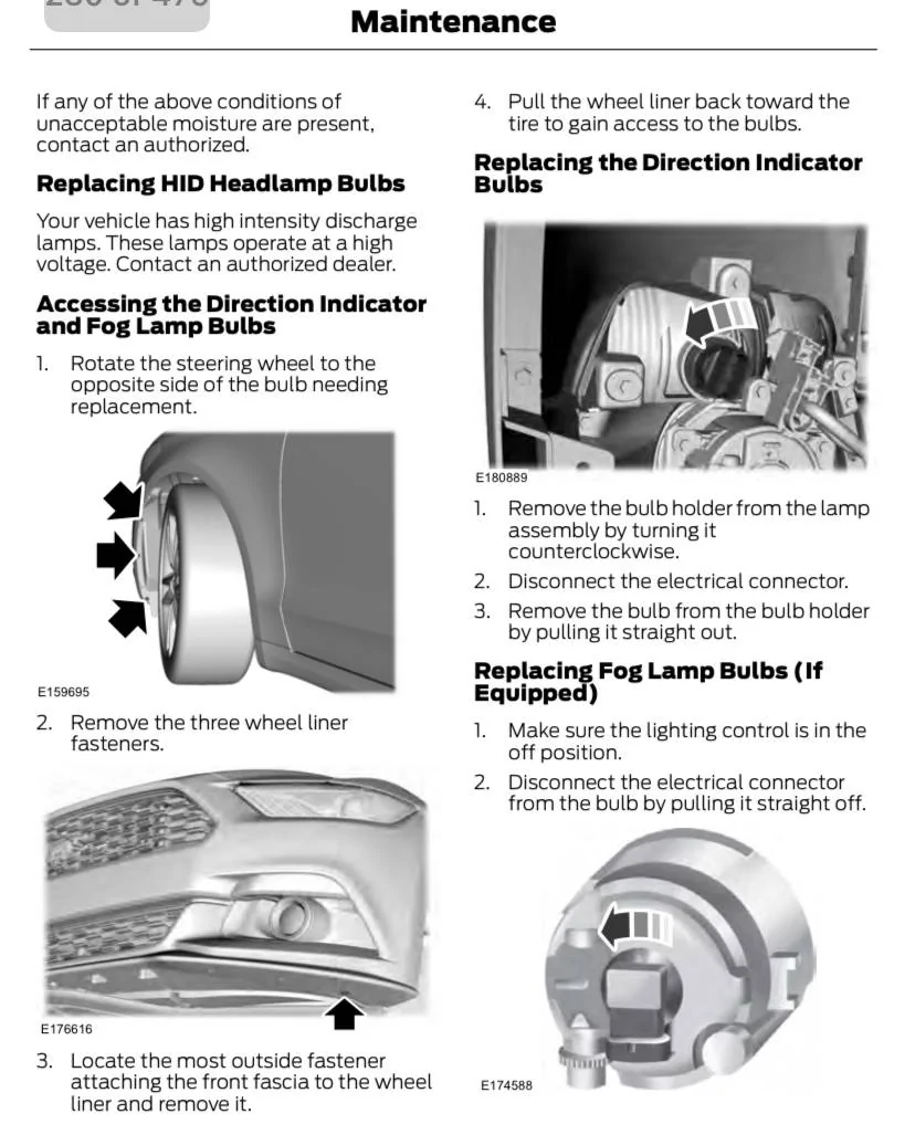

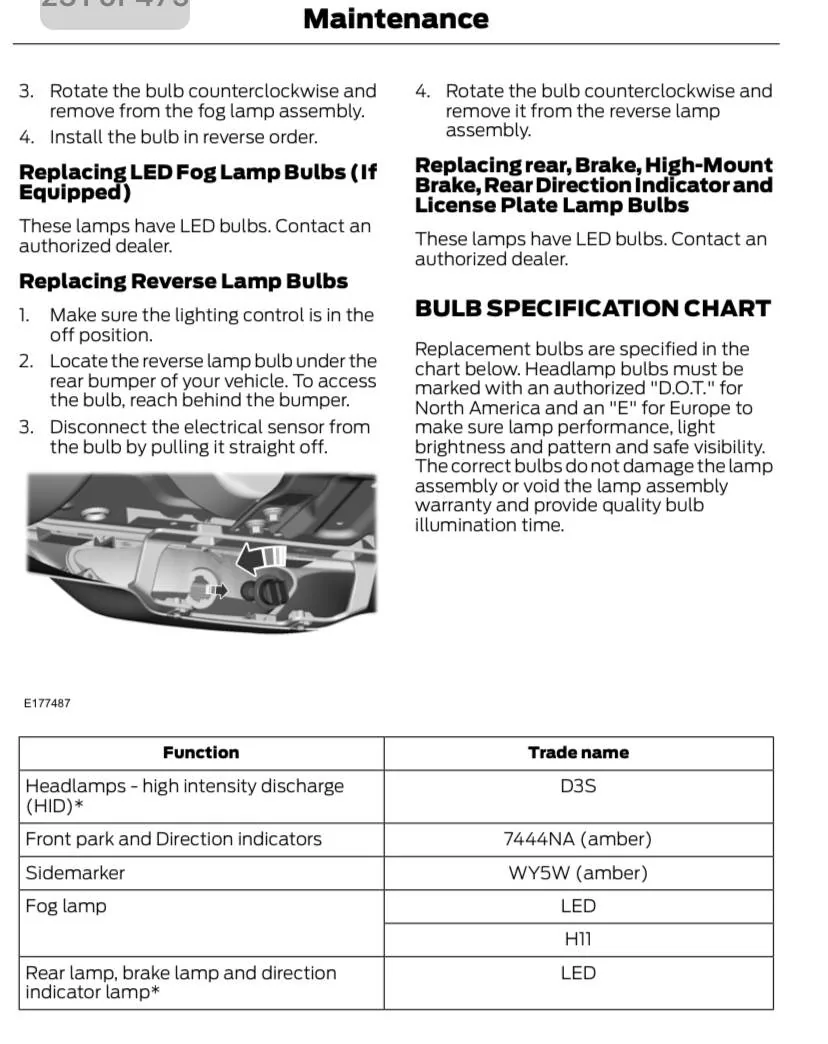

Hi All,
How do you change the globes re, parker lights and fog lights?

Hi All,
What year Mustang?
The light assemblies are different on the front of the 2015-17 vs the 2018-current. Fog lights on the 2018-current are integrated LED’s as are the headlights.

What year Mustang?
Its a 2017 gt

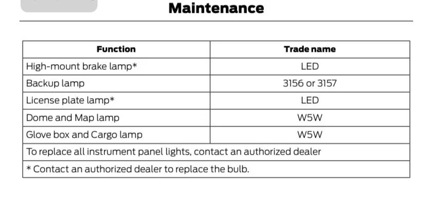

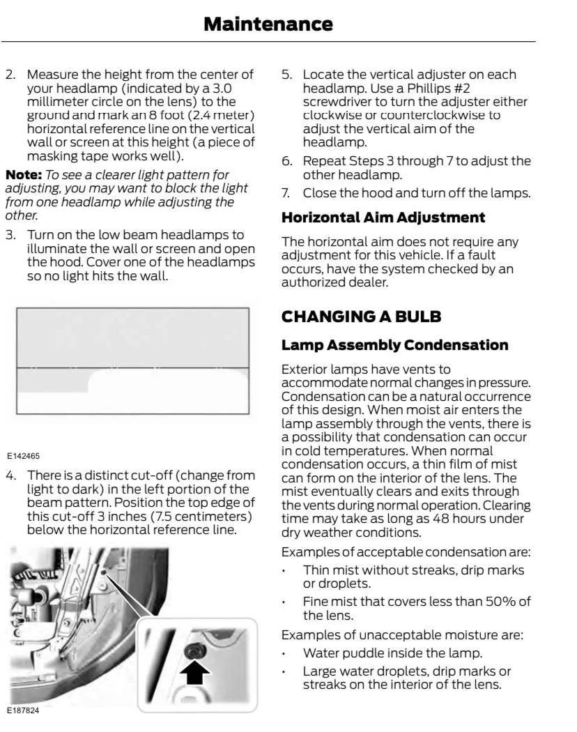

Here's the info from the 2017 Mustang Owner's Manual:

Thanks mate
