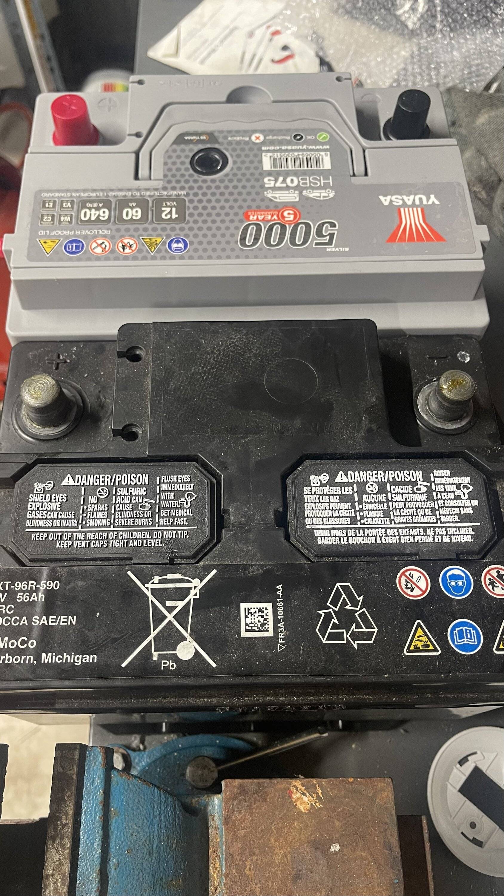

Found a pic side by side, it’s HSB 075, identical size to the motorcraft

Op, what did Halfords recommend, this is my reg recommendation, which is the one I have, they also show an HCB075 with less cranking amps so avoided it.
