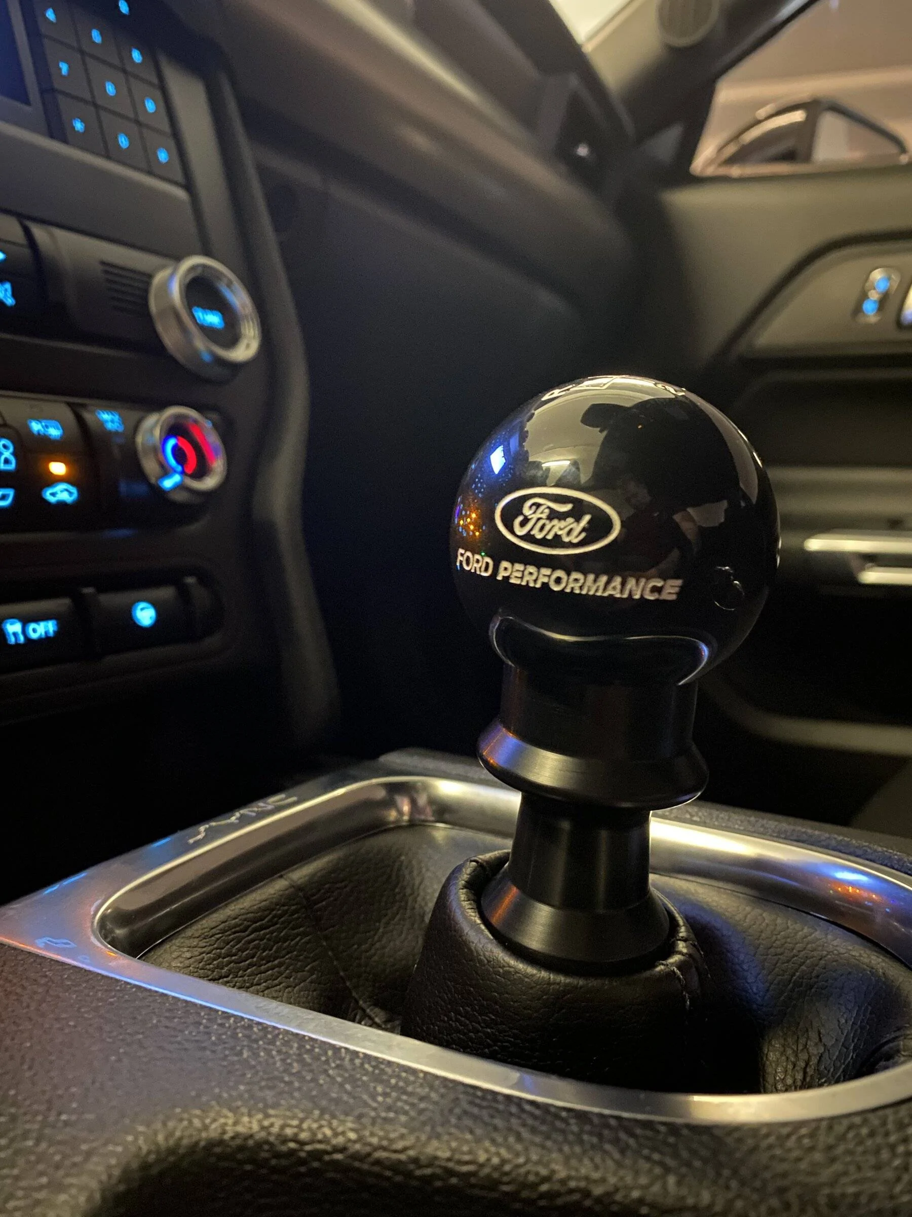

To remove the reverse collar you have to take out a couple of the top stitches where the boot meets the collar. After I installed the new collar my wife restitched it for me.
Edit: I’m referring to a manual, I don’t know exactly how the A10 is…
