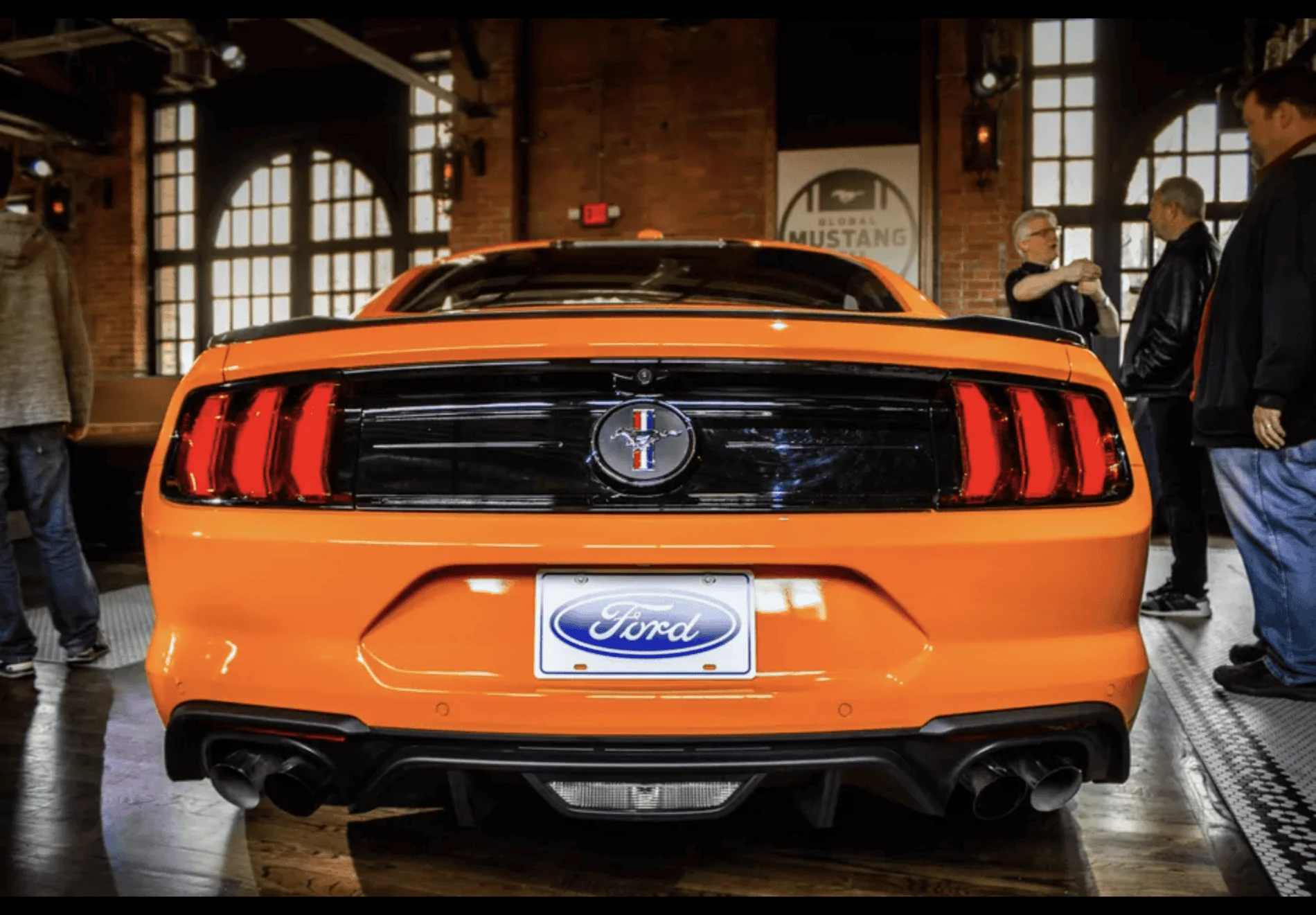

We just bought my friend a 2020 High Performance Pack Ecoboost and heres the thing..
I‘ve debadged tons of Mustangs but this is the first time I can’t figure it out because this Mustang comes with the huge circle with the badge on it.
just wanted to see if any of you have taken this huge bulky circle with the badge off?
I will include a reference pic below

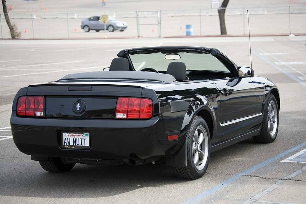

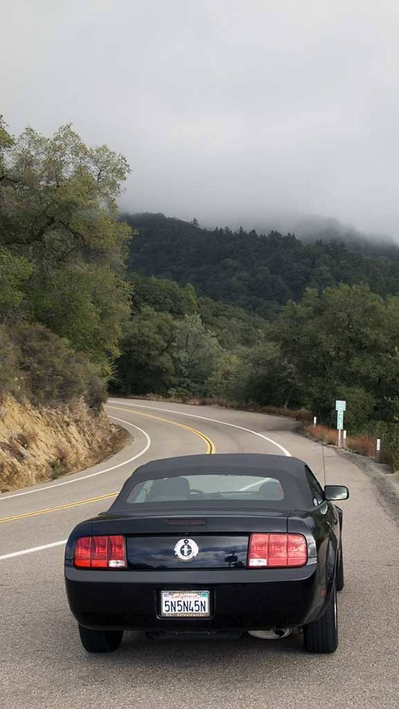

I didn't like the big chrome circle on the back of my 2006 Mustang, so I masked the rest of the car (and the center of the emblem) and rattle-canned it Satin (semi-gloss) Black. Still like it.

You can remove the badge, but the entire deck lid must come off first, so that you can cut off the mounting pins from the other side.
And if you take the deck lid off anyway, then you might as well install a new, plain one, because the old one will now have three holes in it.
