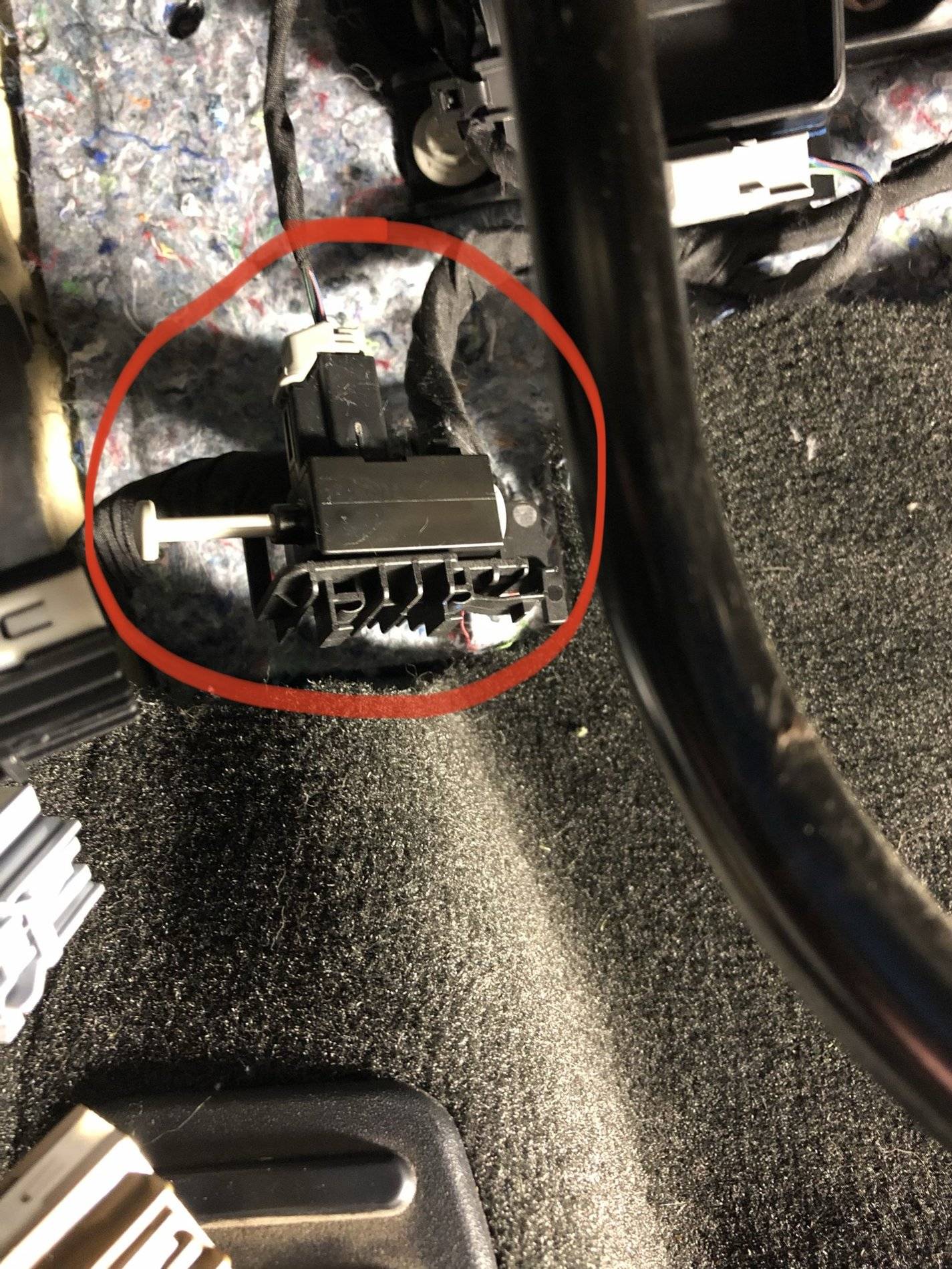

I was removing my factory amp and this fell out from behind it:
anyone have any idea what this is and where it goes?

Clutch switch. It snaps back in. I can get a pic if you need it.

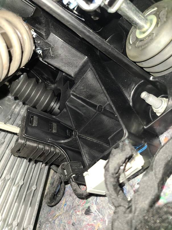

Doesn't take too long but that switch along with the OBDII port needs to come out. I took out the 9 speaker amp and installed a shaker pro amp.

Thanks! Now I just need to figure out how to snap it back in. I found one pic in another thread but it wasn’t very clear on how it sits in there. I’ll also need to check the OBDII port since I didn’t know that needed to come out to remove the amp.

I've pulled that amp several times and I always pull the OBD2 port and the clutch switch as it usually give just enough room to wiggle it out.
