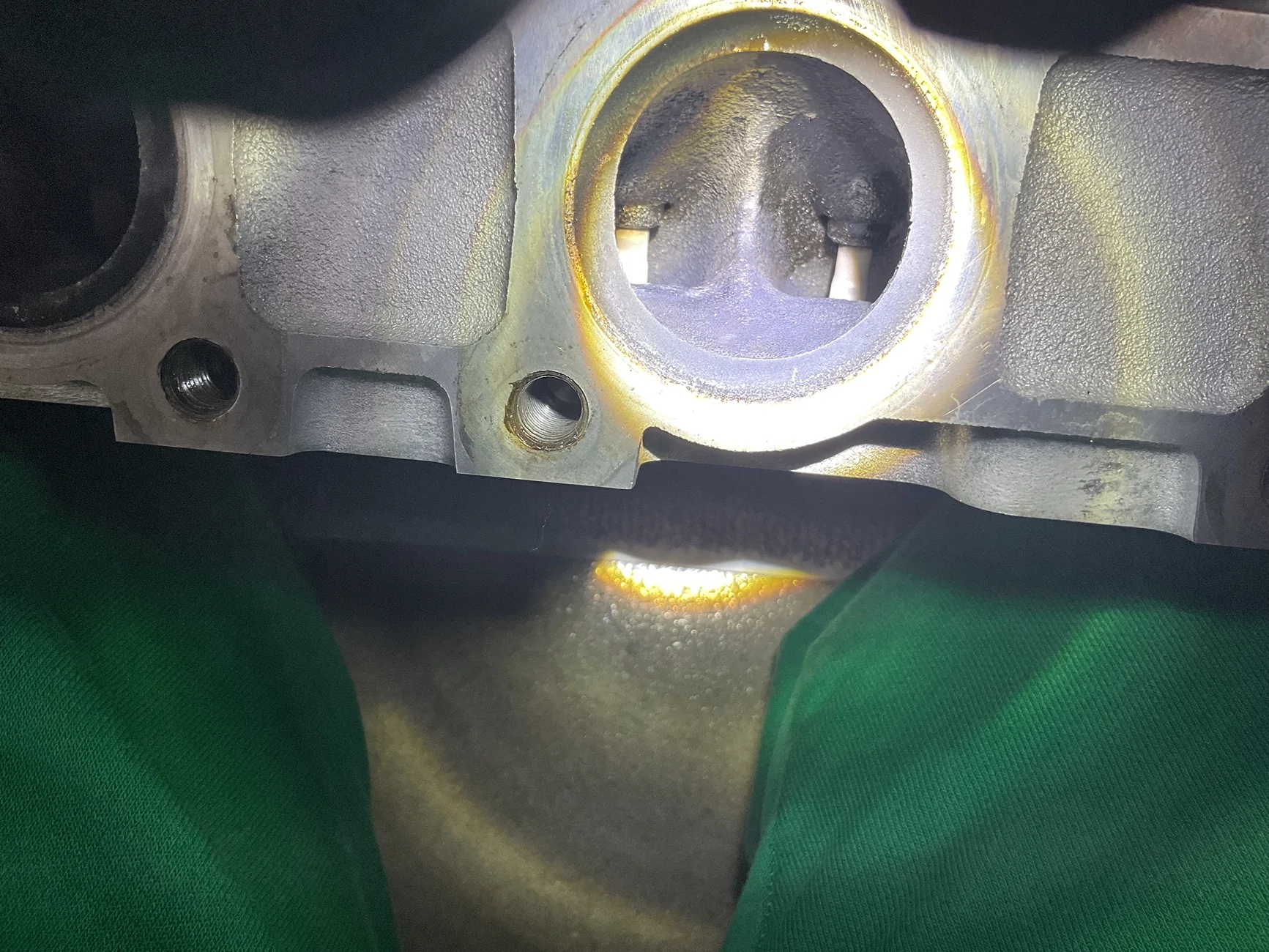

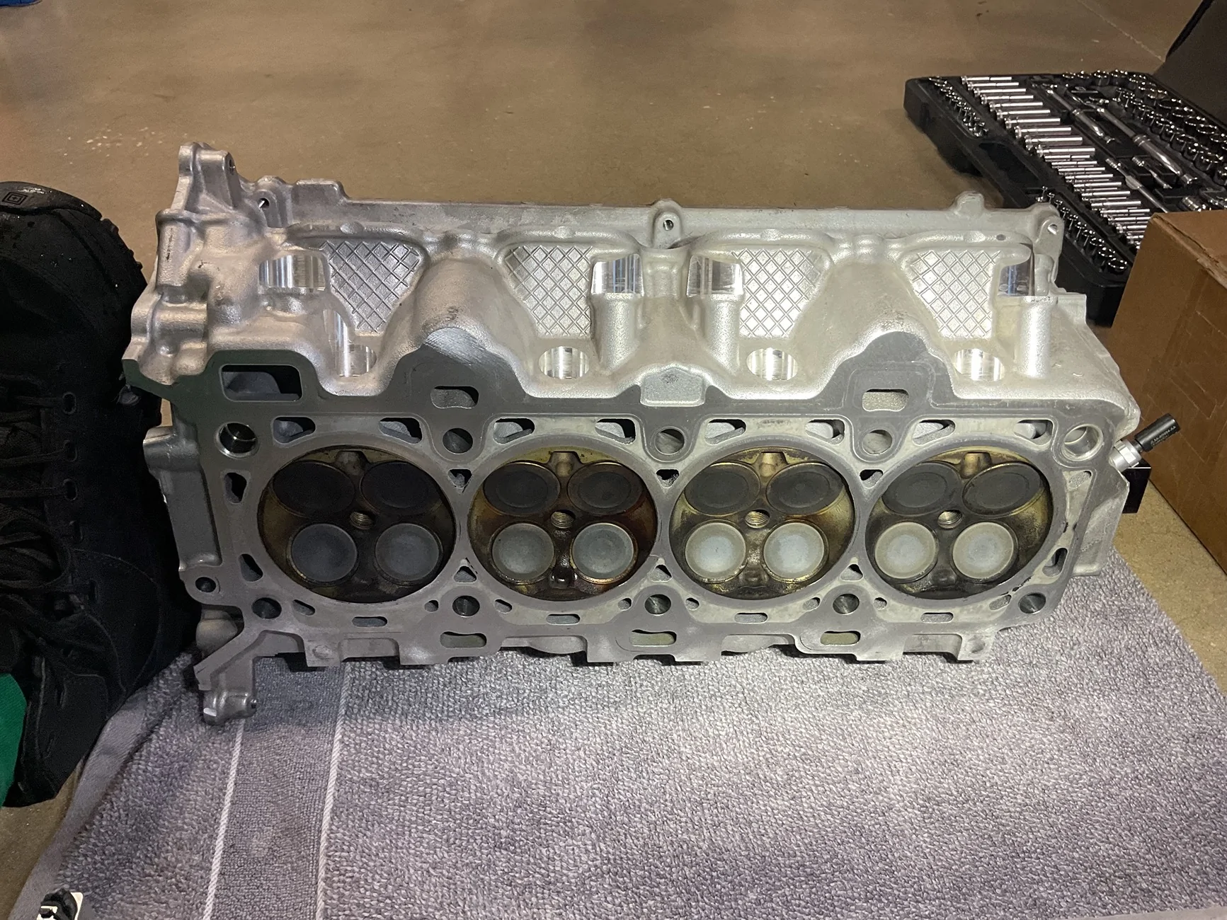

Does anyone here know of a product that works extremely well at removing carbon deposits from valves, aluminum heads and pistons safely?

When I rebuilt my heads it was hard to beat carby cleaner and a brush. most solvents will work Well. Even solvent base engine cleaner is fine.
but hard to beat a scrub.

Advice taken! Walnut blasting machine has been ordered. I’ll get this done and report back with results under my build thread.

The question is, why is there so much buildup on your valves? I've never seen them so dirty on a PI car, that's usually what I see when I take apart Audi engines that are purely DI.
A Coyote intake valve should be squeaky clean.

Guess I'll ask... how many miles are you at, how was it used (was it mainly a car used for wot blasts or was it ever used in a DD capacity where it would have seen plenty of low-load and idle times for PI to do it's work), and were you using top tier fuels exclusively?
8800 miles on the motor. The car has lived on E85 for over 5 years, with the exception of about 10 tanks of 93 during that time.
The car is not a daily driver and has been driven primarily in the city and on the highway. Lots of 1/4 mile hits at the drag strip as well.

carb cleaner that is "highly dissolving". let it pool and bubble around valves
You didn't say where you were getting fuel. Top tier stations exclusively? Just trying to gauge, not prod at ya.
