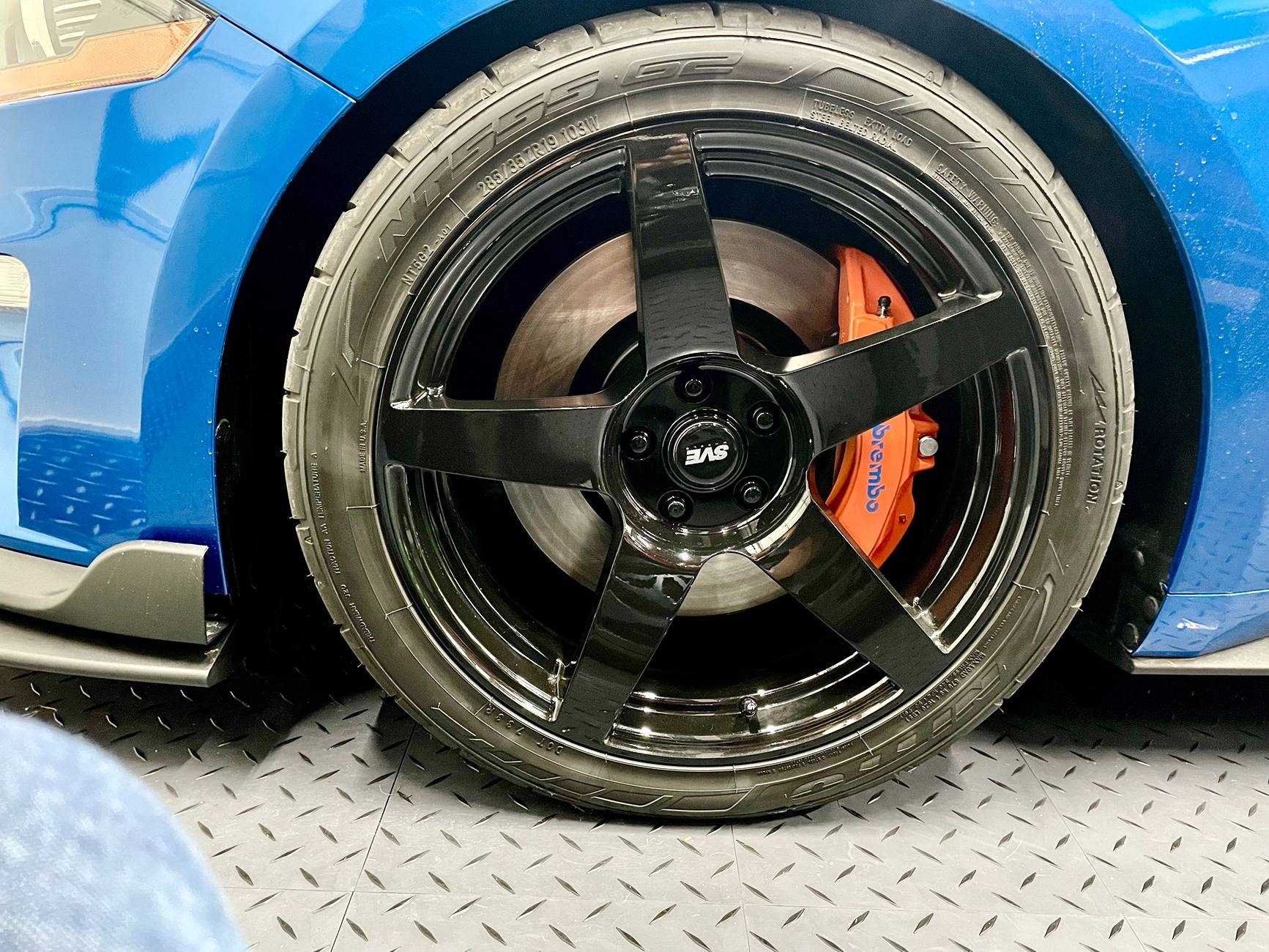

I did this last year, I removed the calipers from my car and completely disassembled them to have them powdercoated a different color. It was pretty easy, you just need to take your time and keep track of the parts you remove. I wound up rebuilding the calipers with new seals since it was fairly inexpensive and I wanted the peace of mind. There are a bunch of videos on how to do this and you can get the brembo decals on Etsy or eBay to complete the job.
