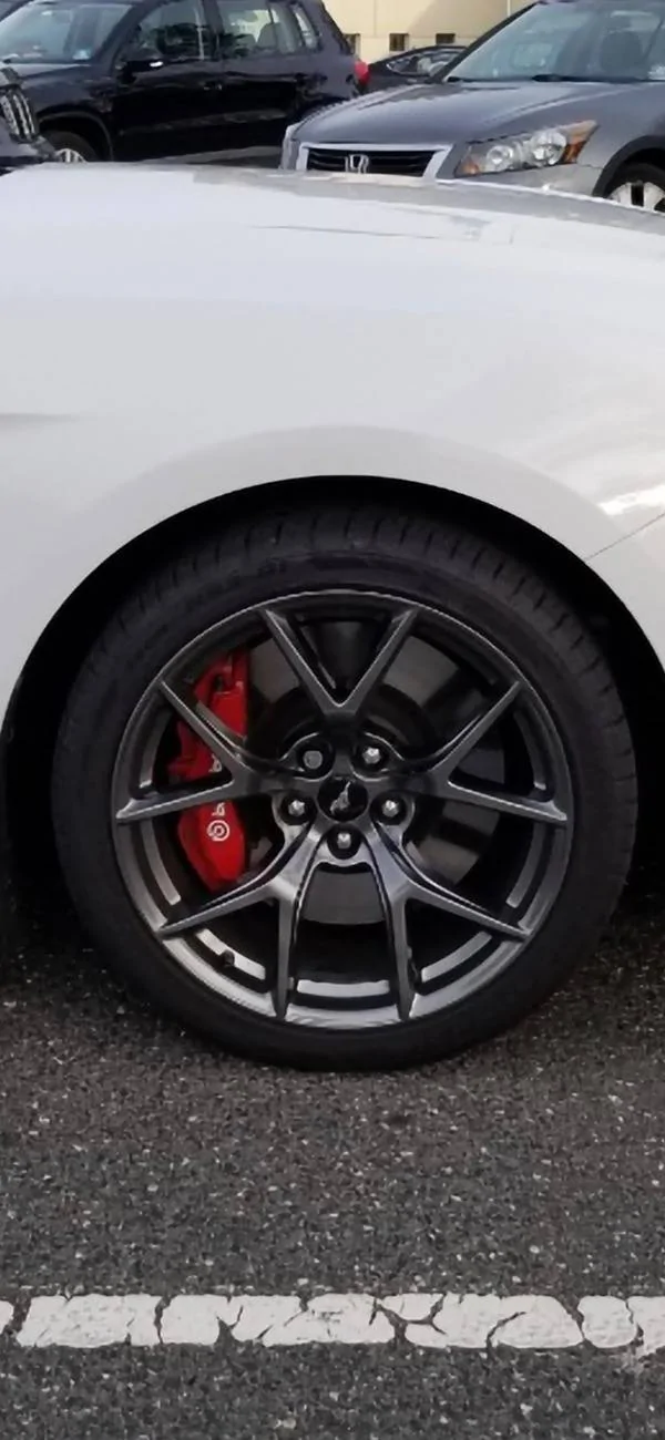

Removing calipers to powder coat
AShelbyinCali
New Member
Jun 18, 2025
Fresno, ca
Jarrod
2017 GT350
I've had personal experience with powder coating Brembo's. If I had to do it again, I would buy the GT350R caliper as the whole process I performed was about the same cost. That price point included used sets of F/R calipers, caliper piston removal tool, Brembo vinyl stickers, piston seals, and boots. I bought an extra set of calipers as soo I could work on this project slowly and not have the car be in a down state.

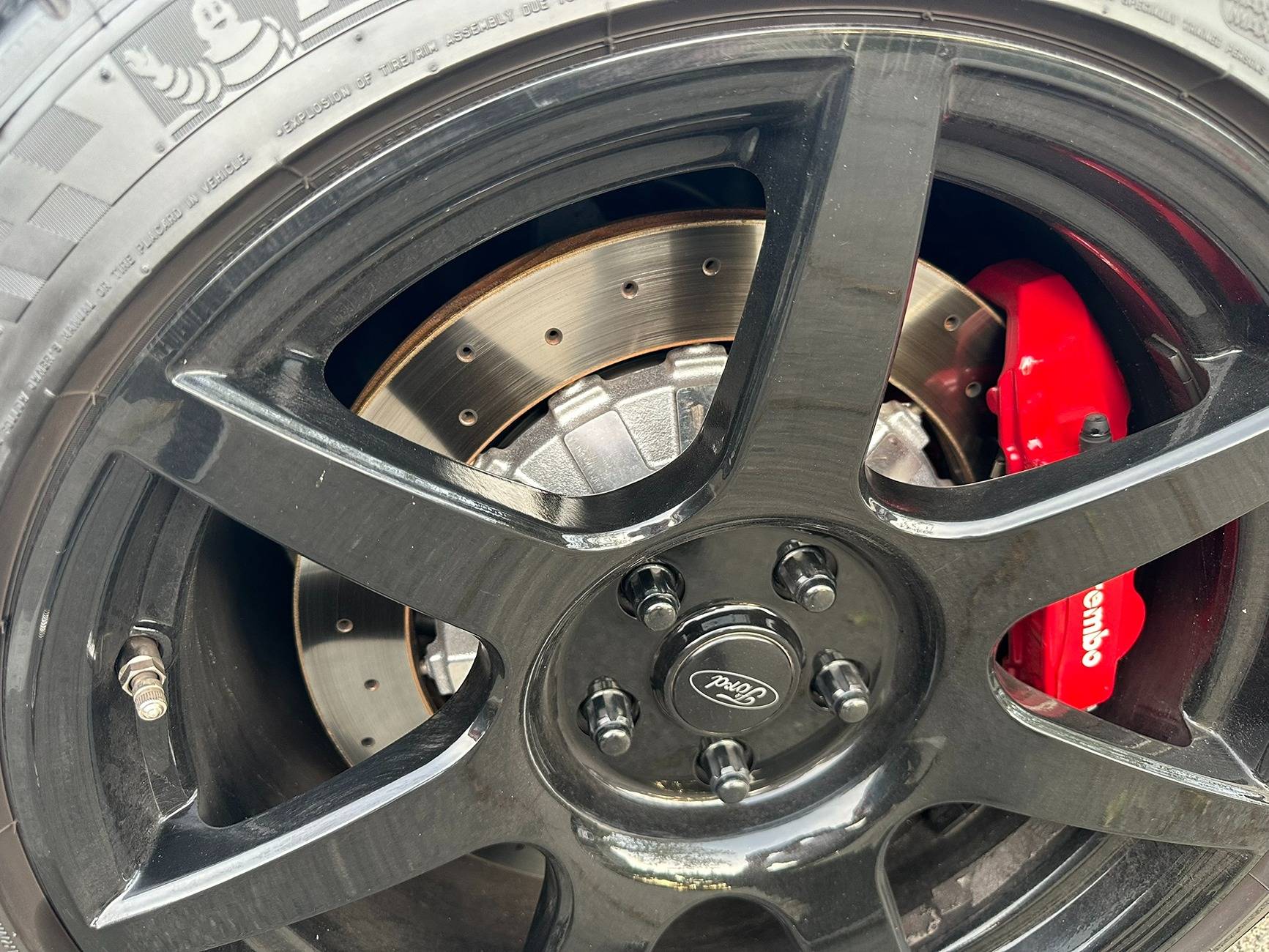

Leave them on the car, clean them, tape them, and paint them with G2 paint kit, then add a decal. They'll look great and you'll be done in a day or 2.
This is how I'm doing mine, just got a question, I have some rather obvious dents/gouges on the face, would the g2 smooth that out or do I need bondo to fill the imperfection? The cause was several full force hammer strikes including a sledgehammer. The pins didn't want to come out they were seized solid. They went from a point to completely fault against the face and still never came out so I missed a few times lol
The G2 isn't filling hammer dents like bondo. Just rough up the service and get it clean and paint over the imperfections. They'll be so shiny, the casual observer probably won't even notice. Unless you're looking for show car quality, which it sounds like you're not. Ymmv

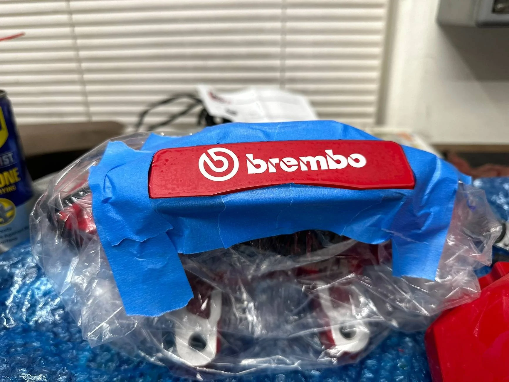

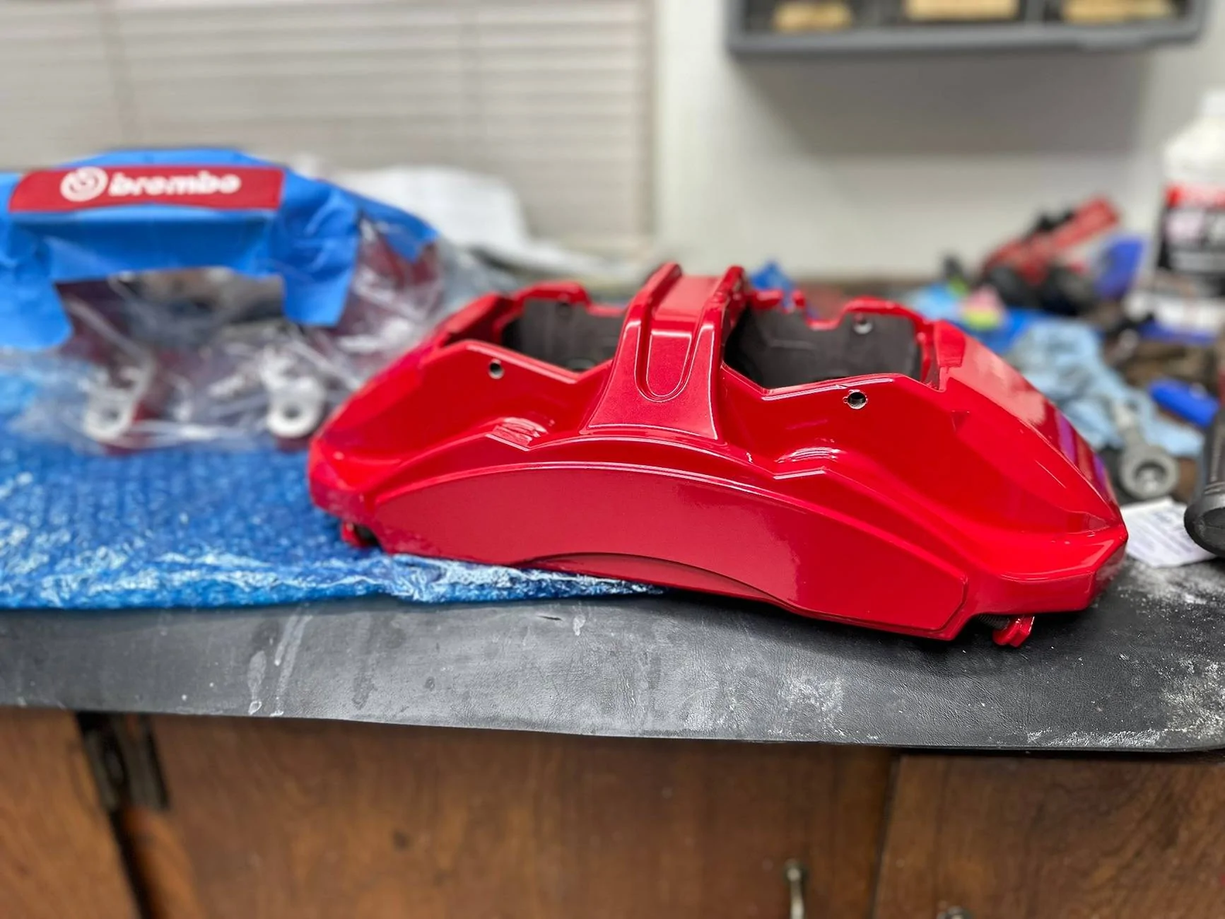

OP, just some notes if you haven’t done this yet and go with G2. Follow the instructions to a T. Watch every tutorial video and read every review you can. I’ll admit I rushed the job and I was a little disappointed with my results but that’s on me.
Once the paint is dried and cured, it can actually be wet sanded and buffed. Buffing will give you an overall glossier finish, and wet sanding will help bring down any uneven areas. Do not paint the back of the caliper - it’s a waste of very expensive paint. You’re better off coating areas you’ve already hit with another layer.
You’ll have an easier time if you remove the pads and hardware, but you can 100% tape them off and paint around. Before you remove the calipers, open the brake fluid reservoir under the hood, put a plastic bag over it, and screw the cap back on. This will create a stronger air seal that will prevent you from losing fluid through the hoses - by removing the caliper, you are depressurizing the system so creating a seal means you only have to replace the fluid in the caliper.
