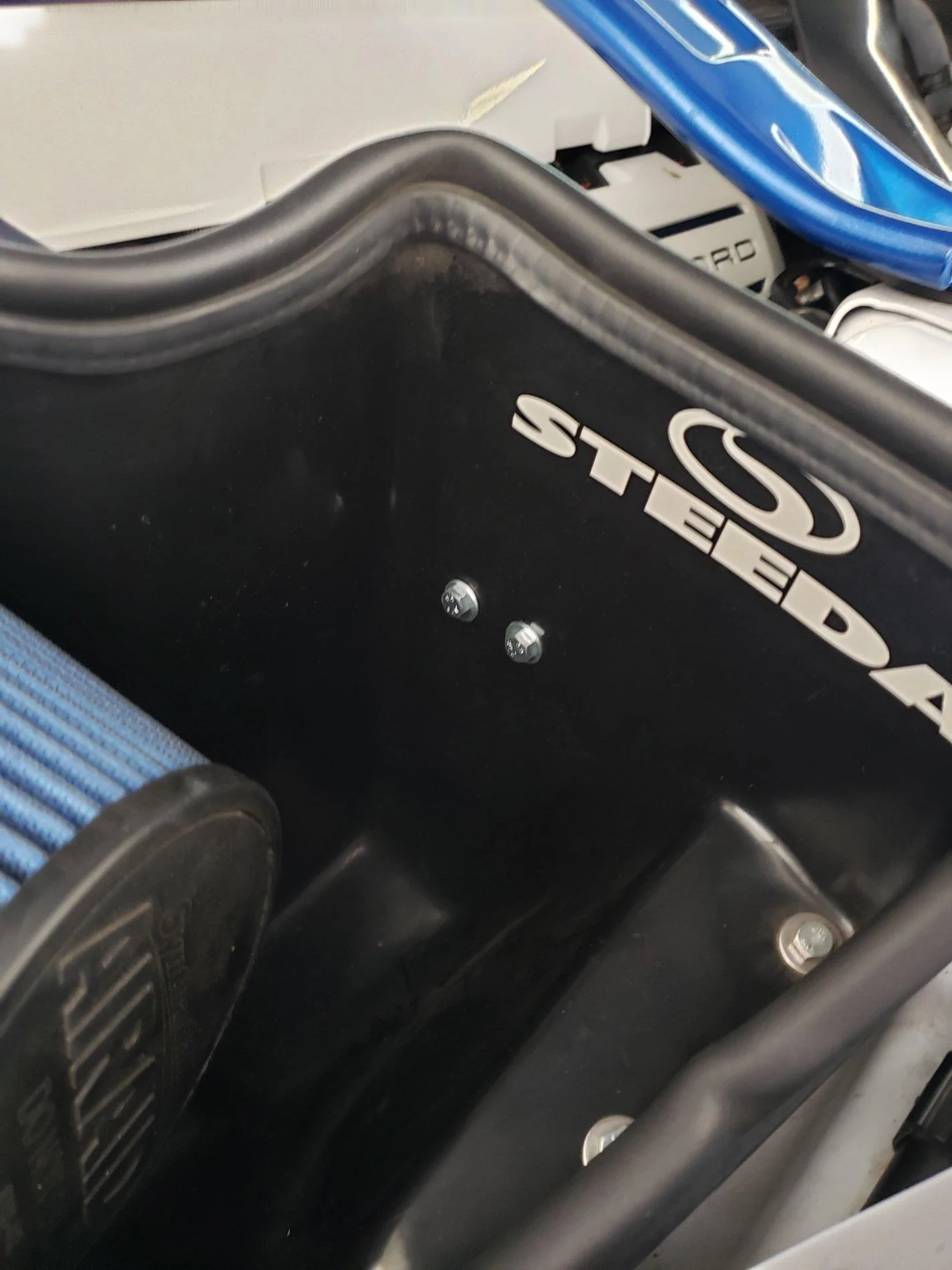

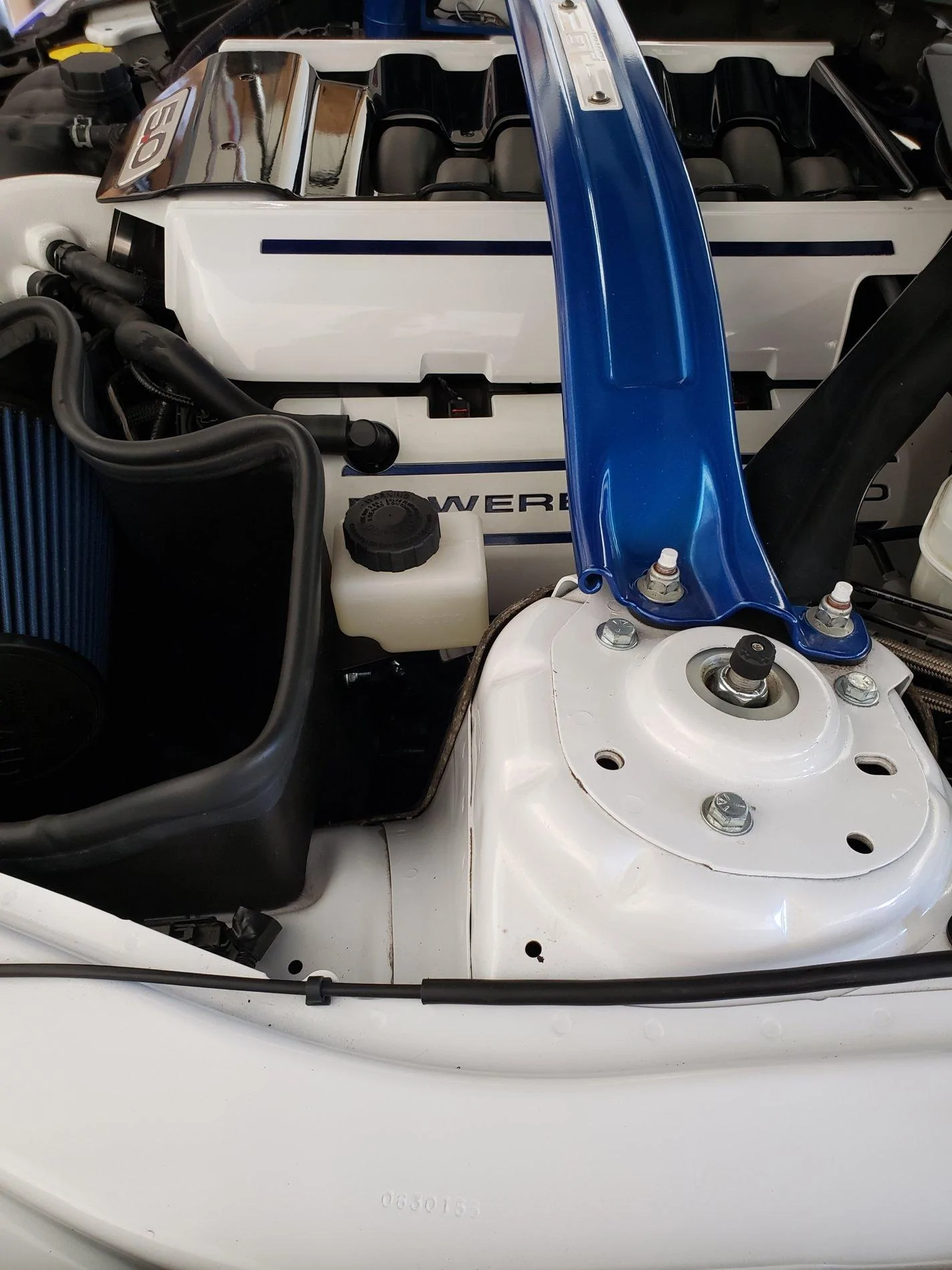

Hey guys, I seen this was a topic some people were asking about, myself included so I figured I would post up. On the s197 tons of companies made solutions to separate the clutch fluid from your brake fluid, well for some reason that hasn't hit the s550 market. Here is how I did mine and what parts I used.
Wilwood 7oz fluid reservoir, P/N: 26011098
1/4" vacuum cap
I mounted the resivoir to the back side of my CAI box with some 1/4" bolts and nylock nuts, ran the supplied line from the wilwood kit to the nipple on the firewall, and capped off the nipple on the brake resivoir with the 1/4" cap.

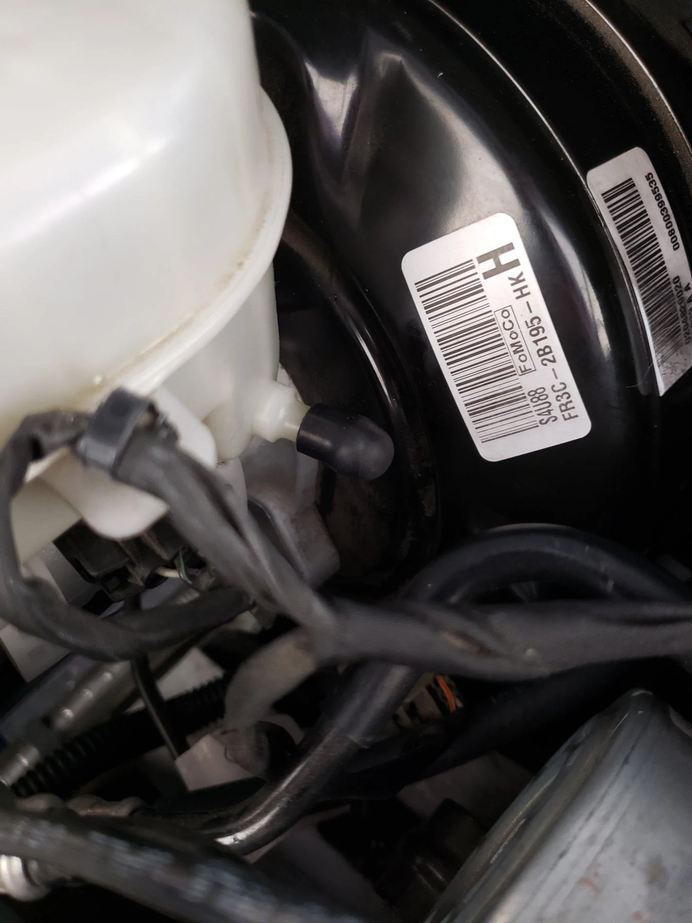

One you look under the hood it's fairly self explanatory, I was worried about it myself till I looked at it. The picture I posted with the vaccum cap, there is normally a black plastic line there, you can trace that back to the firewall, the plastic line is maybe 4" in length. You just pull that line off from both ends, cap the one and attach the new supplied line from the wilwood kit to the nipple on the firewall. It's just above where your main clutch line is that goes down to your transmission.

Update to this, the vaccum cap that I used decided to fail at autox yesterday. Lost all of my brake fluid. I will now he ordering the automatic with performance pack master cylinder to totally get away from this issue happening again.

It's the same. Ford just cuts off the tip, and fuses the plastic. Even my 2018 F-150 Platinum had that clutch nipple fused, so cheap Ford apparently uses the same damn brake fluid reservoir on all vehicles. Looks super cheap IMO. I wouldn't do that mod just because there's no sure way I can think of to cap that thing nicely, and safely.

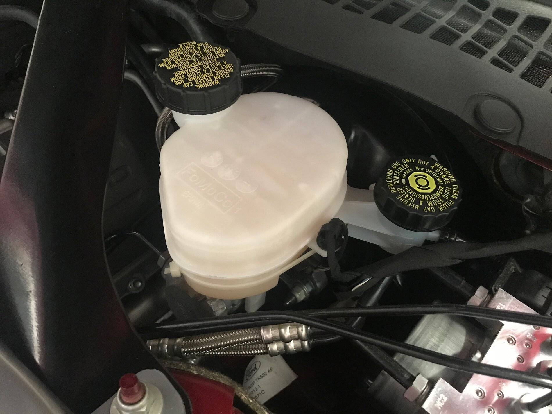

Most people just buy the auto version. Unlike the previous mustangs, the reservoir and MC come together. On ebay, you can get the auto with brake booster for around $60. The GTO clutch reservoir seems to be the go to.

I was able to pump the reservoir empty then disconnect it from the MC and install the auto reservoir on the stock MC. No air introduced into the system. Just have a towel handy since some fluid will run out once the stock reservoir is disconnected

I am using this reservoir and I've just got it zip-tied to the brake fluid reservoir until I can figure out something more permanent. Not worried about it coming loose since this reservoir when full probably only weighs a couple ounces. More worried about the zip tie getting brittle and breaking later down the road.
