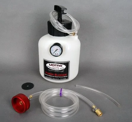

I use the motive power bleeder with the red aluminum cap. I've had it for years for other cars. I've stopped putting any fluid in the motive power bleeder to reduce the cleanup. I just use it to pressurize the system and keep an eye on the actual reservoir and top off as necessary. It's always worked well for me.
I use Castrol SRF fluid. It's worth the extra money IMO.

[MENTION=14263]Brent Dalton[/MENTION]
do you have the part number for the red aluminum cap or a link? they have a few different ones that are all red.
Sub'd. How much fluid does the PP take for a full flush?
Also always make sure to bleed from the inboard nipple followed by the outboard nipple on dual nipple calipers. Some just bleed the outboard which is not ideal.
Yes it is this BLEEDER as Brent Mentioned. His method of using it as a pressure source only is the least messy method of doing a brake bleed. There is no need to bleed the ABS system unless you had it opened. The Ford method uses a pressure bleeder to flush and bleed brakes. No ABS actuation is required. 1 Liter of fluid will fill a system but 2 liters (or qts) will be enough to do a full flush.
Any DOT4 should be changed every 6 months for track use. SRF has a 500+F WET Boiling Point so it able to perform much longer than regular DOT4. We run OEM DOT4LV and have never experienced brake fluid issues. We run cooling and a proper brake pad. OEM fluid is good 500+F when it is fresh. We recommend a racing fluid for track use but we are testing, not trying to set fastest laps so we have stayed with OEM fluid to verify product performance.
