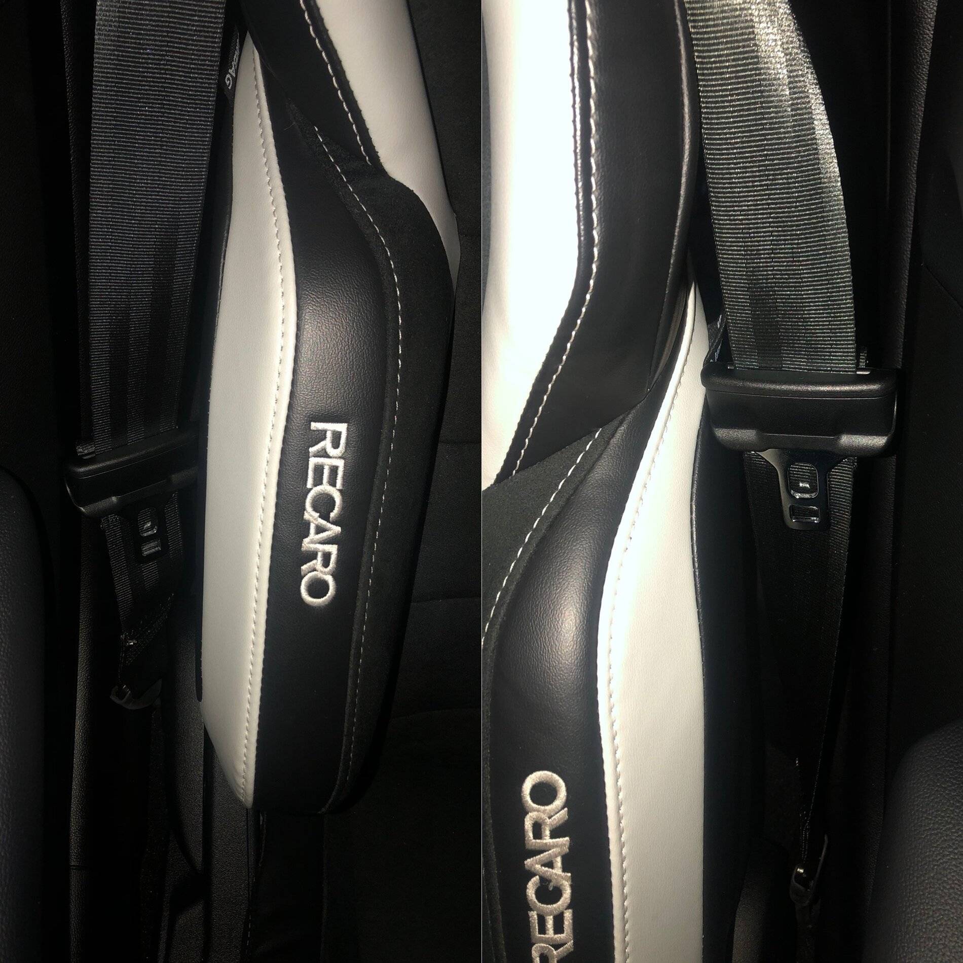

I have one too but it’s only when I don’t have a passenger. Turns out it’s the passenger seat belt bouncing between the seat and the door panel. For some reason the drivers side belt buckle sits higher than the passenger(when not buckled.)
see pictures for difference, left is passenger, right is driver. It rattles more if the passengers has the assistance strip holding the belt.
Thank you, I hear the vibration with a passenger as well, it sounds like something small is loose. I am hoping I can track it down, it is not too loud, so I am not too concerned.
