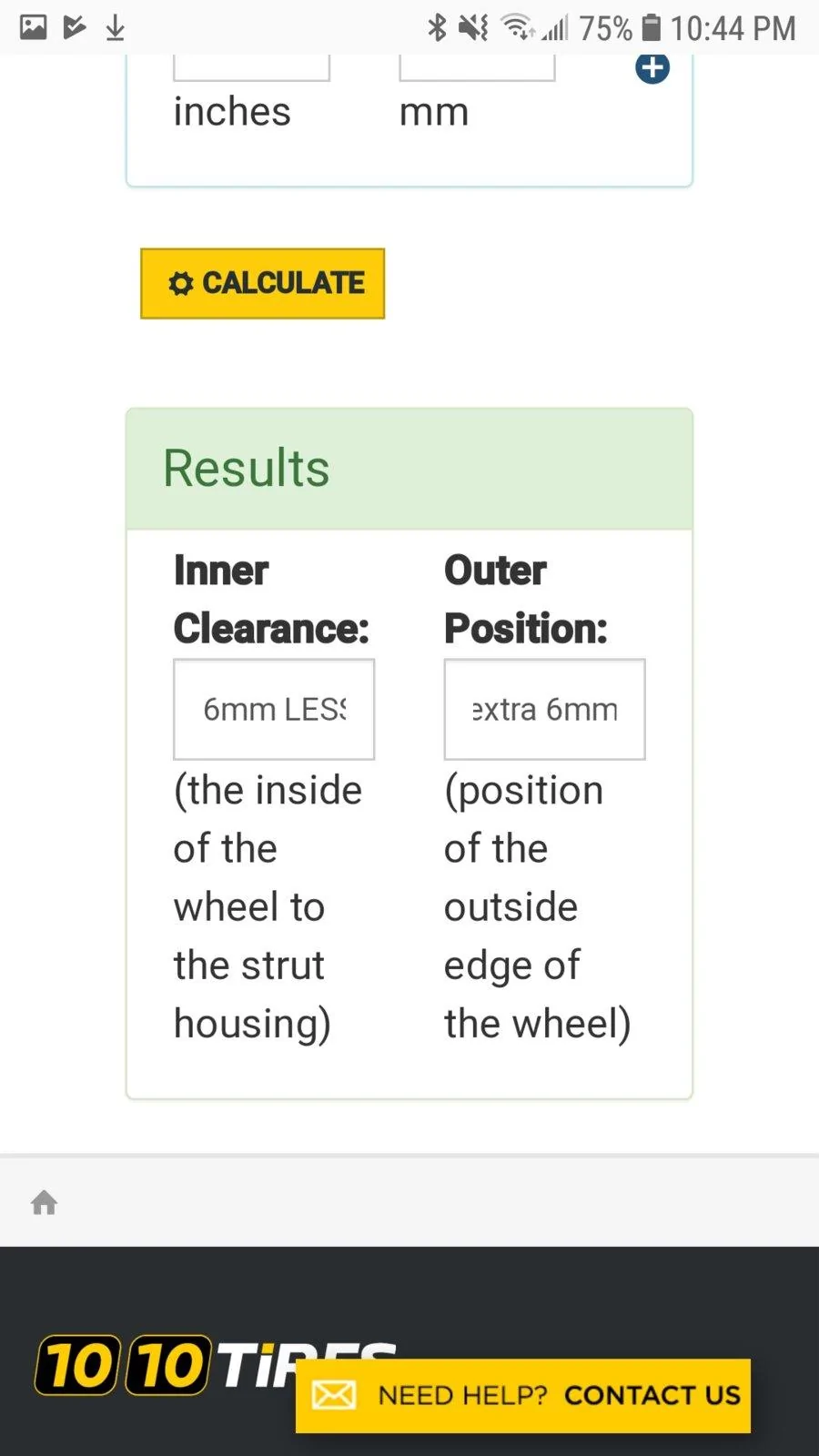

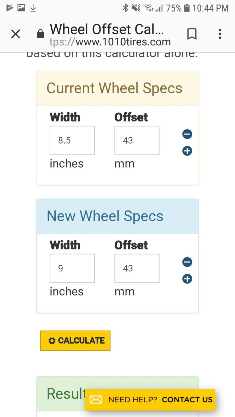

So I just need to get this straight. When getting our wheels widened. Outer lip face to fender doesn't change right? Only the inner lip to suspension. Are your back wheel/tires tucked flush or poke now?
Because my 9" wide wheels have 42.5 offset which I am getting widened to 11". So they will fit the same way at the fender as yours are? Hope I'm coming across right.

It would be great if you could do that pic thx. I'm not worried about fitting on the inside measurement, I'm wondering how close my wheel lip will be to the fender.I can't get a good idea of the difference in your 8.5 wide and 42.5 offset and my 9 wide and 42.5 offset. I'm being repetitious so if anyone else is following they'll get exactly what I'm talking about. I would like to use the 20mm spacers since I already purchased them and the wheels are being welded as we speak. But if I don't use them it's no big deal. I tried to use the 'will it fit' site but couldn't figure it out. I'm not that literate enough to figure it out. Lol
So I'm hoping my fellow Mustang clan can help. Thx for your time.

I found it. So my offset will be 6mm wider. Are your fronts the same offset?
