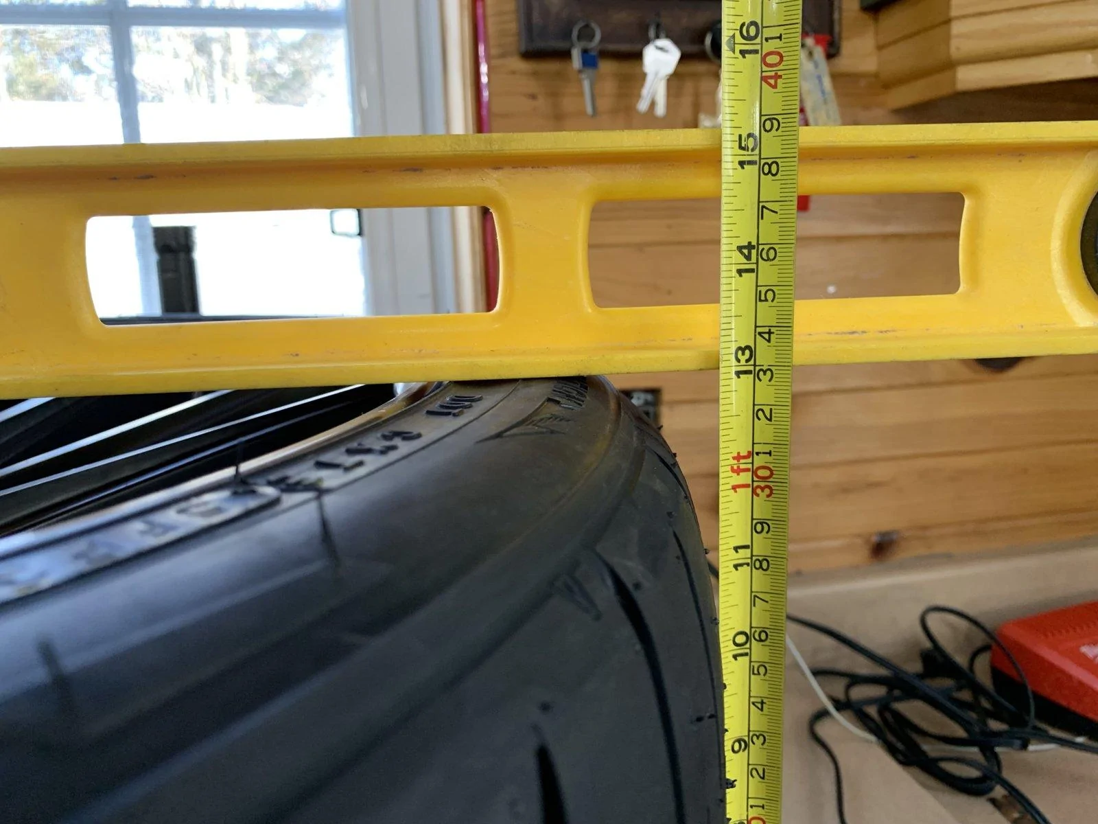

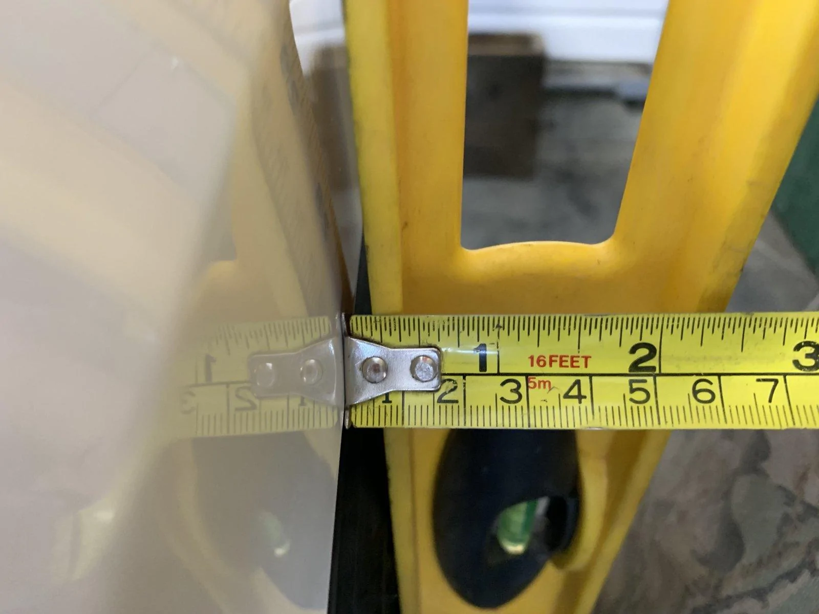

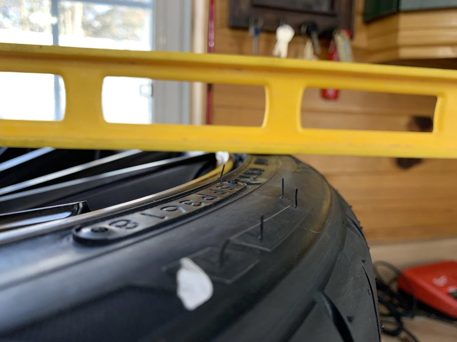

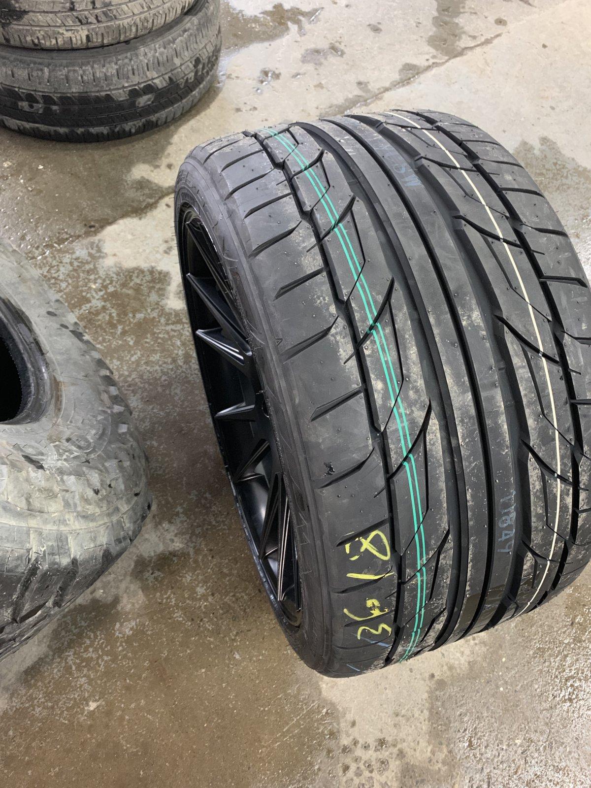

Tires came in early so I'll try and get them mounted Monday if possible. These Nitto 315/30 20 are a brand new size just came out this Nov. Nitto NT555 run wide compared to other brands, the Dunlop 325/30 I had returned because they were old stock are as wide as these 315/30's. Here are some pics and measurements of the tire and the widened 12" wheel. It looks like with the measurements theses tire should fit just a hint of stretch, but mounting well tell.
Wheels from Rim outer edge to edge 12 3/4"
Wheel inner beed seat 11 3/4"
Tire inner bead edge to edge 11 1/2"
Tire tread width 12"
Tire overall width 12 7/8"

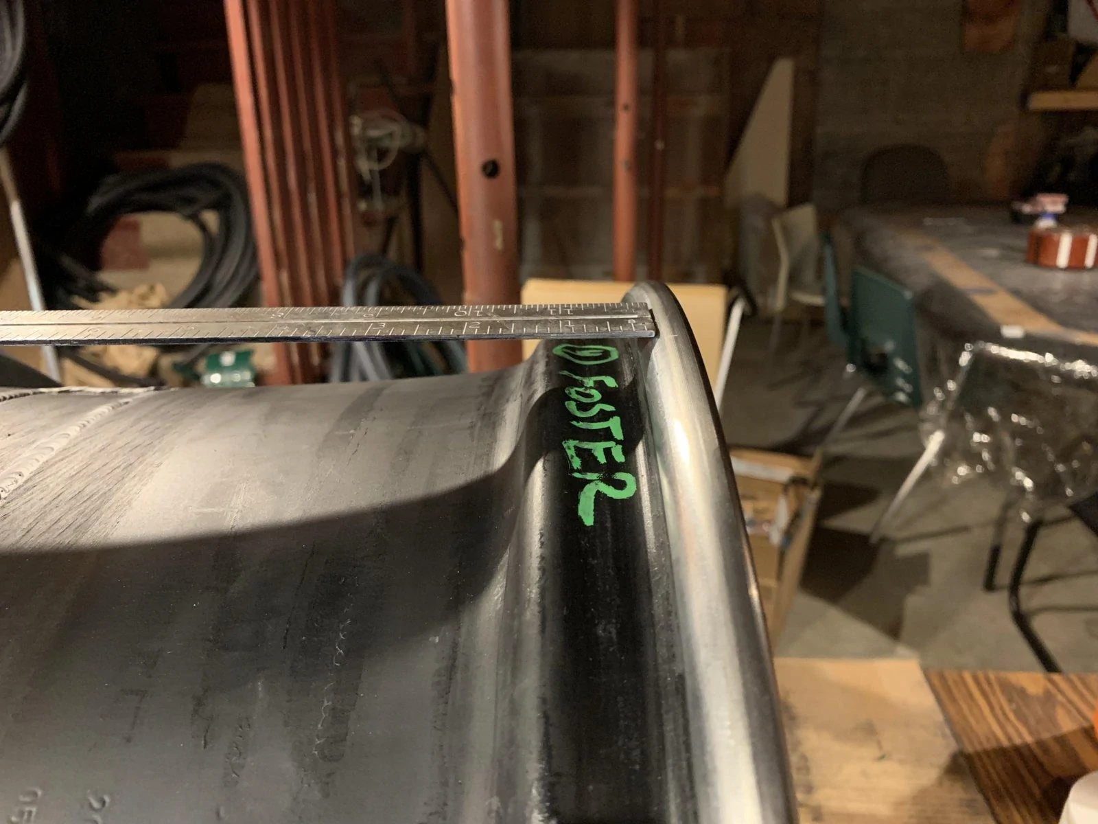

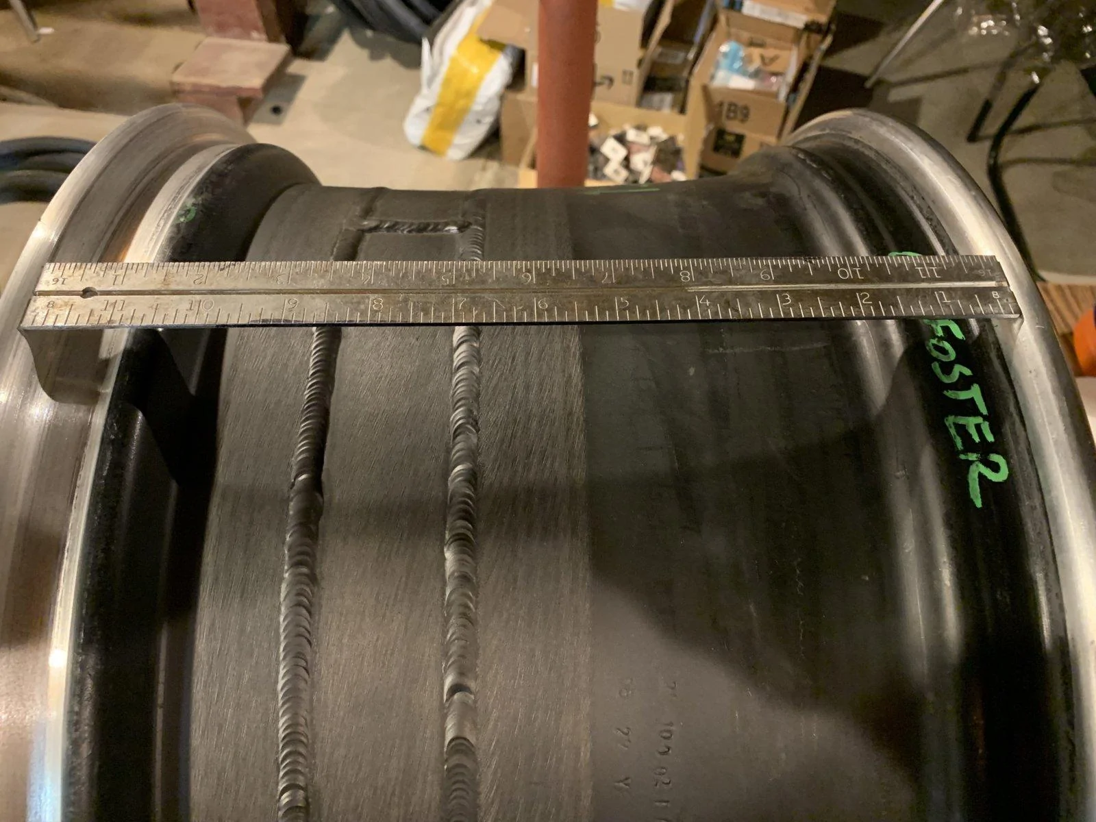

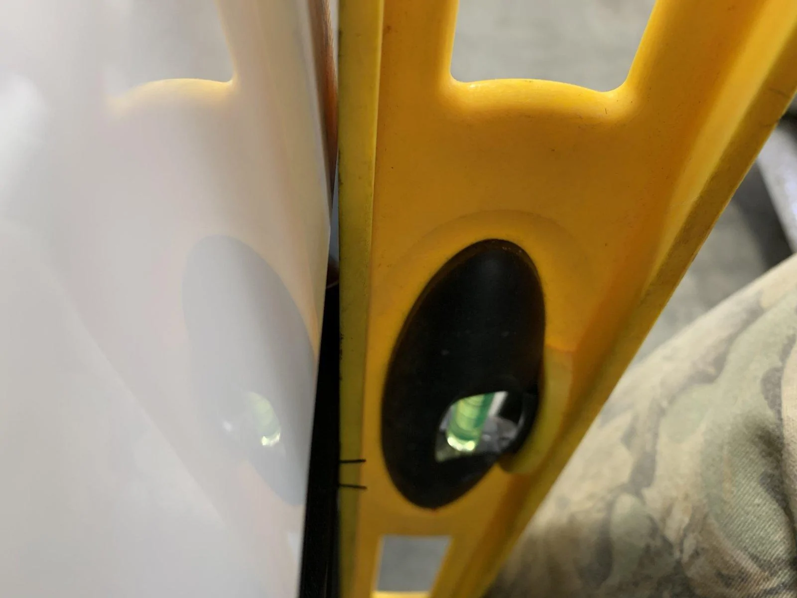

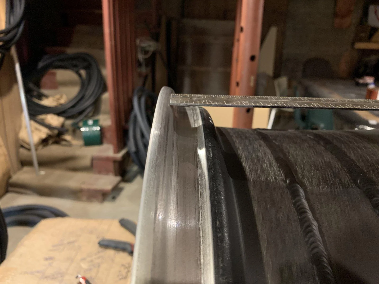

Also did some remeasuring on the wheels width and they very 1/4" from bottom seat to middle of the inner flange lip. As you can see from the photo a 12" ruler fits inside but about halfway down so at the bottom they are 11.75"

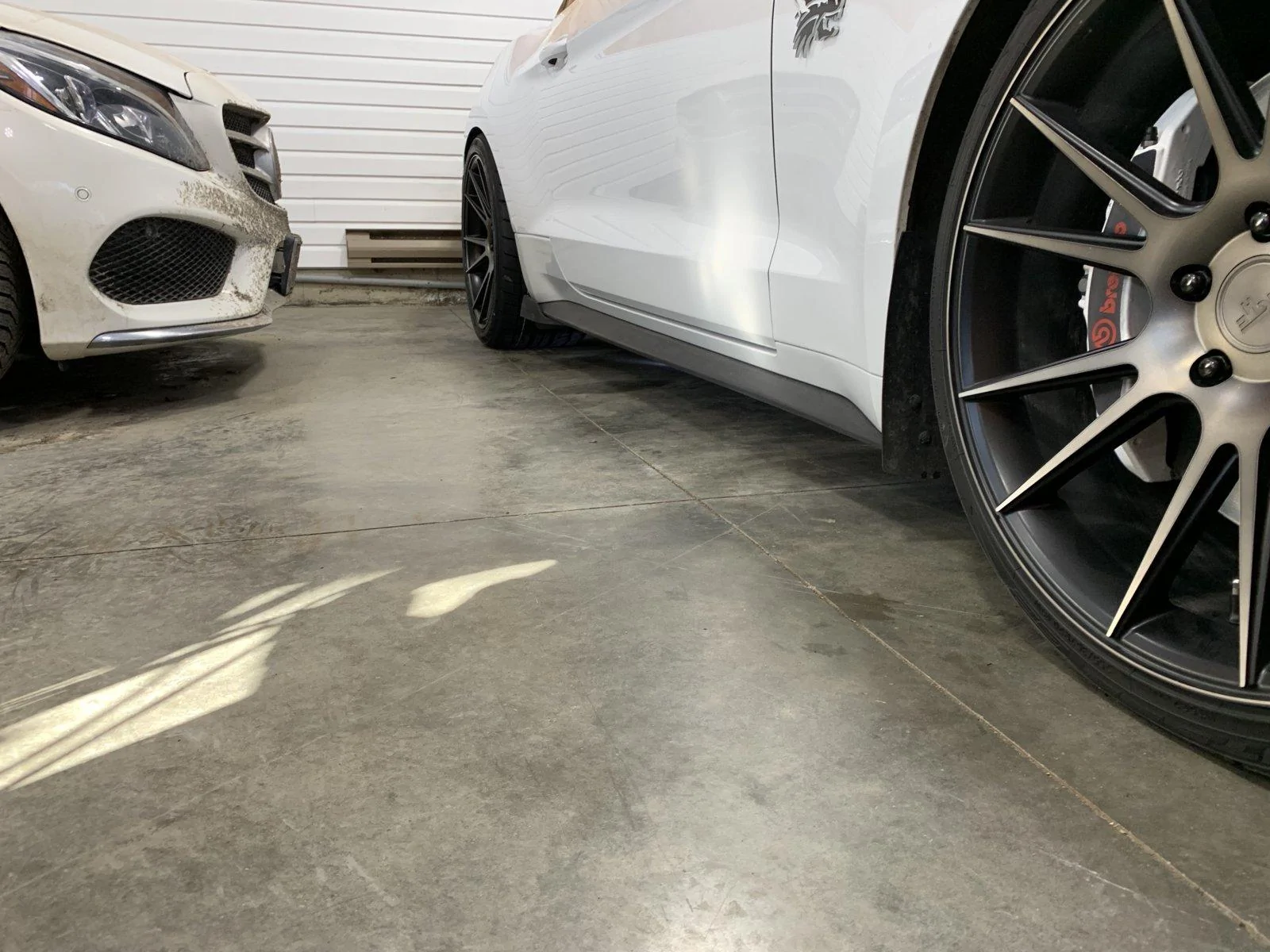

Wheels and tires are on, and fit perfect. Details coming with many pics.

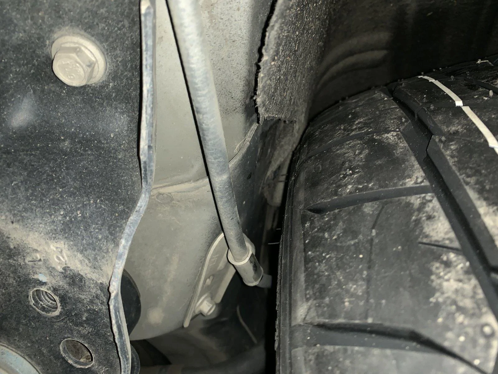

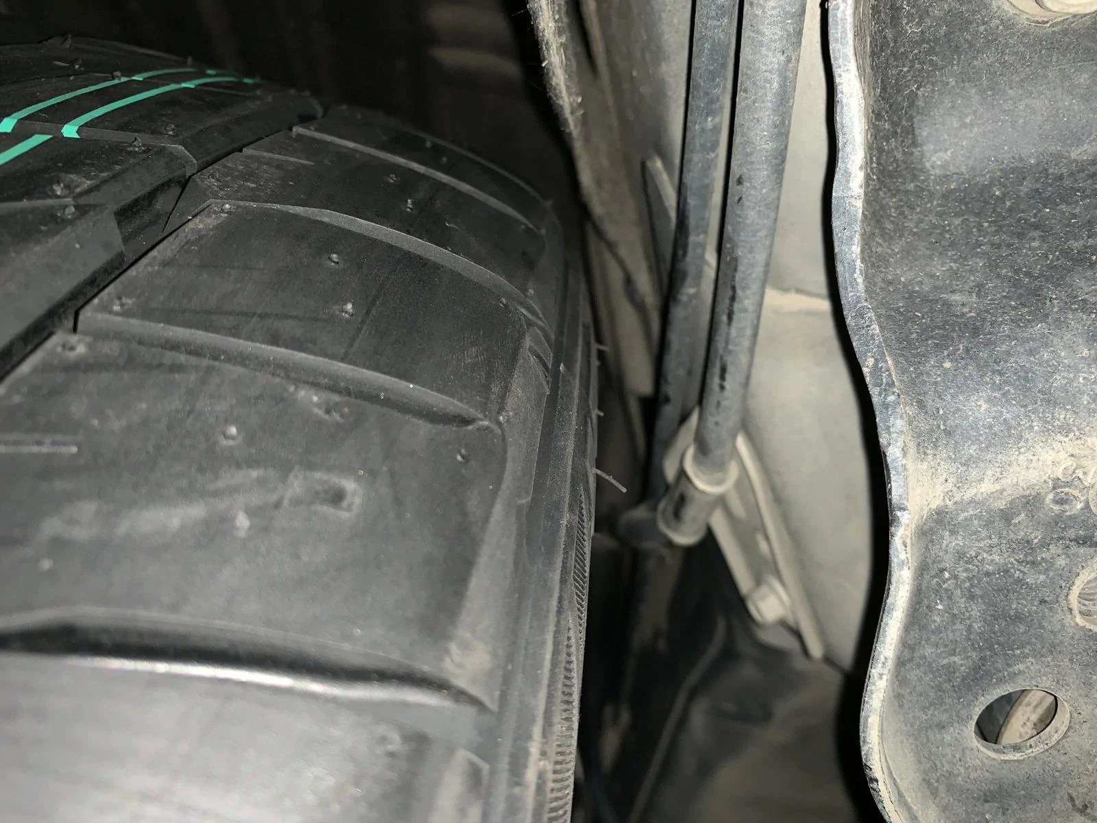

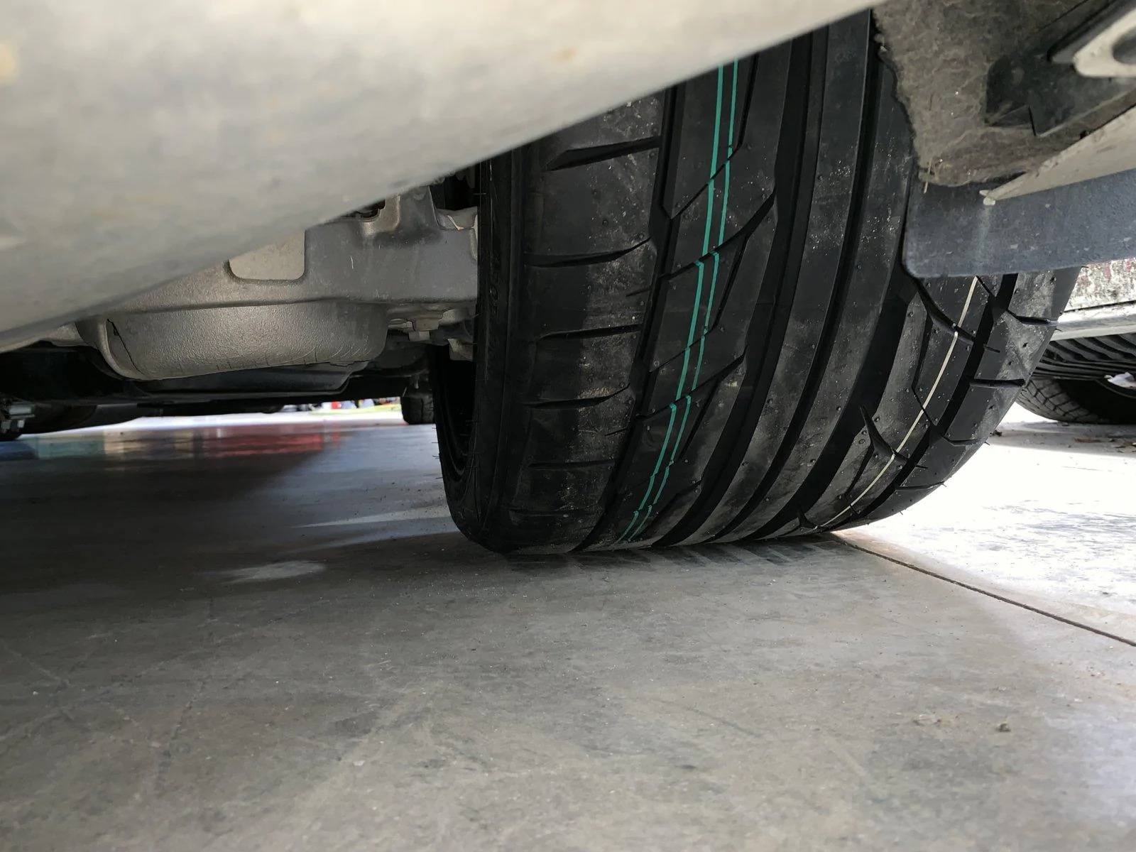

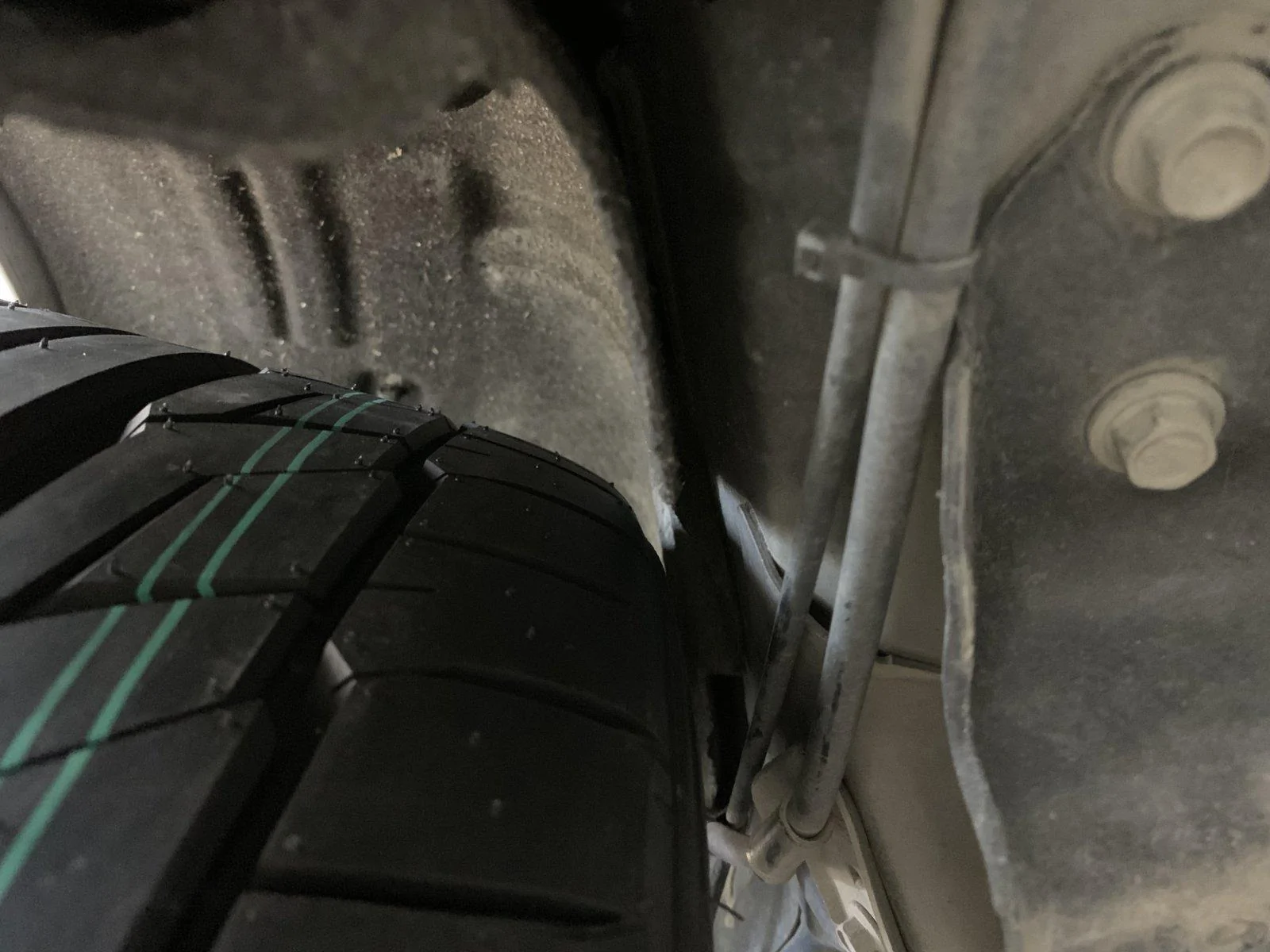

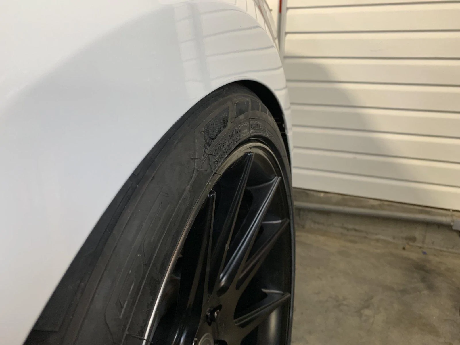

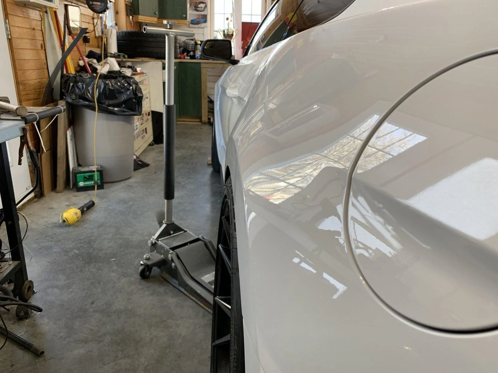

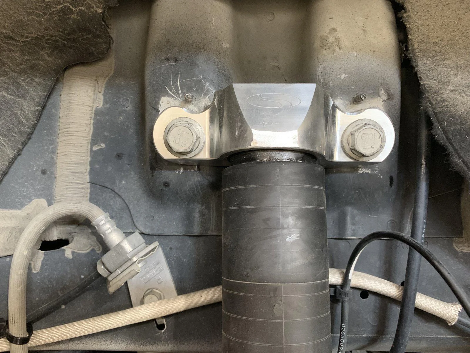

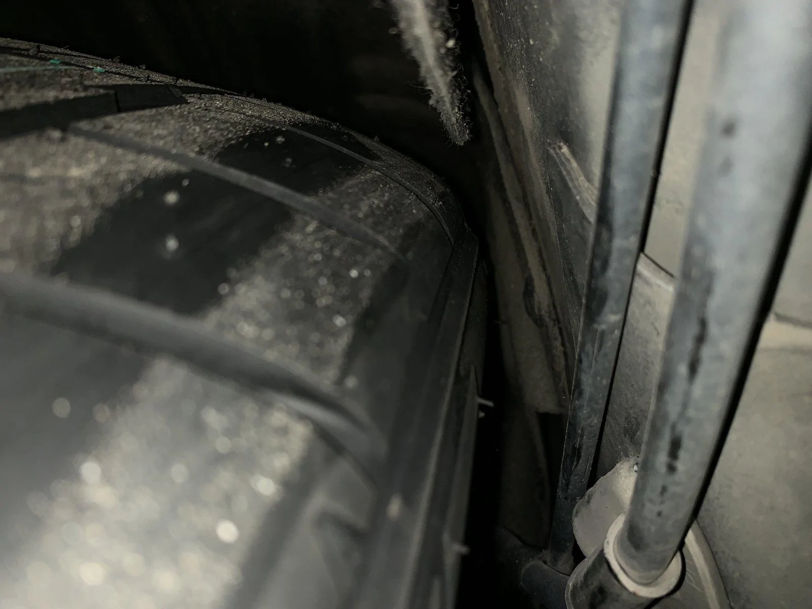

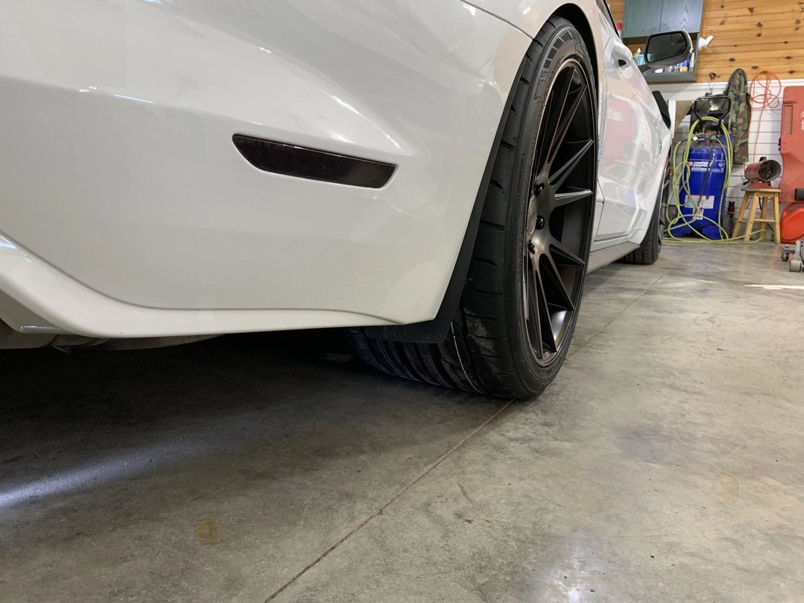

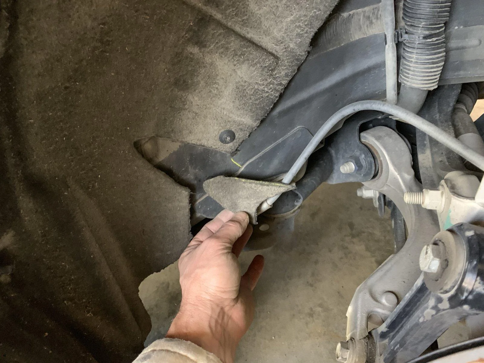

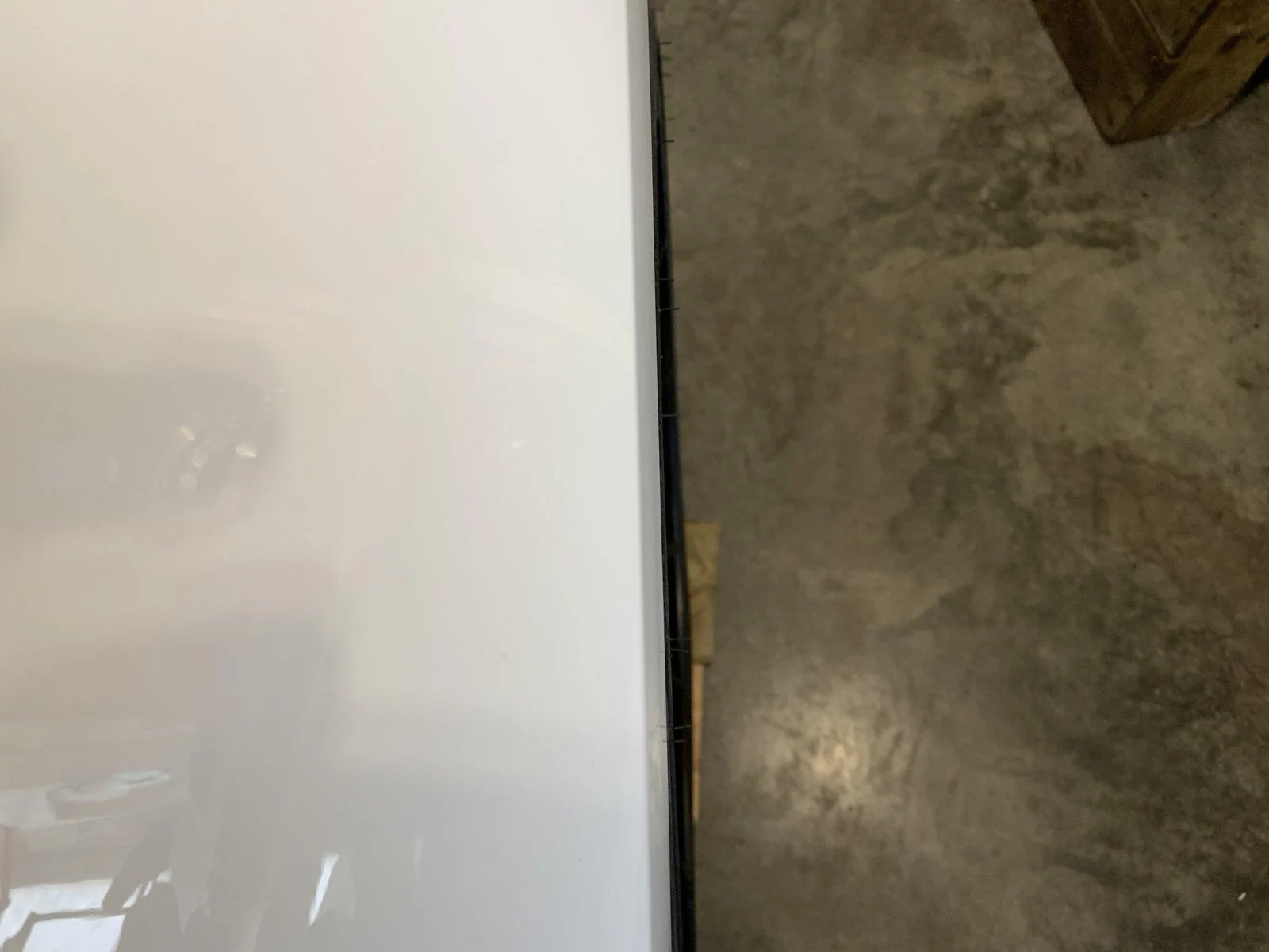

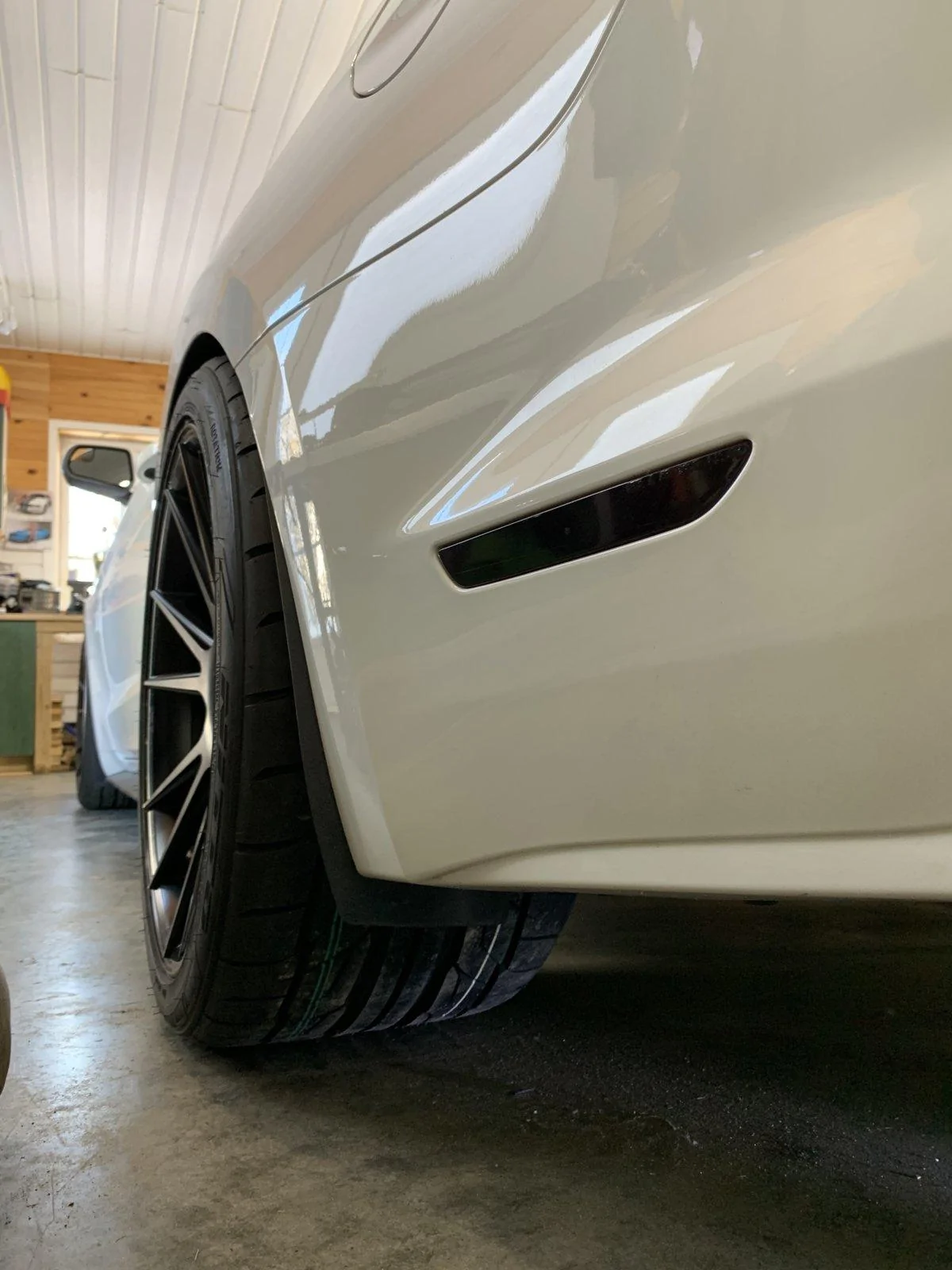

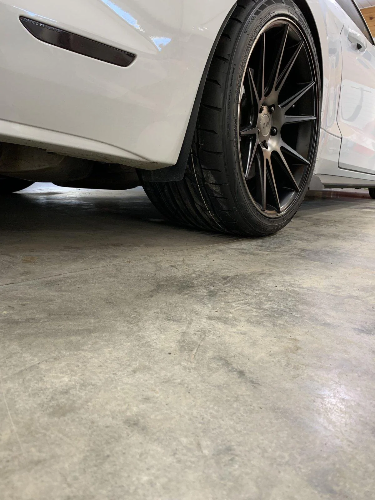

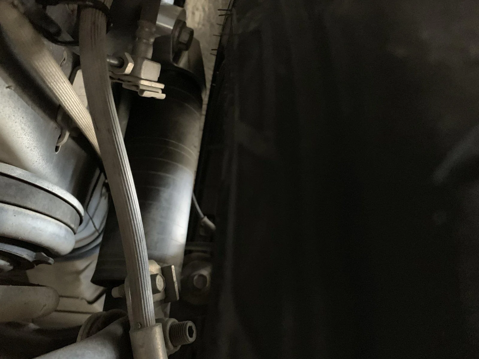

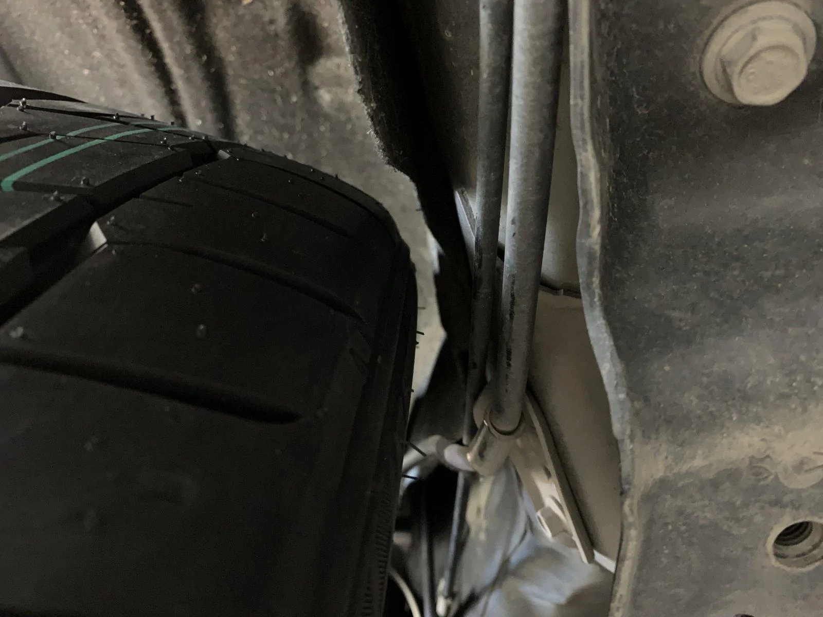

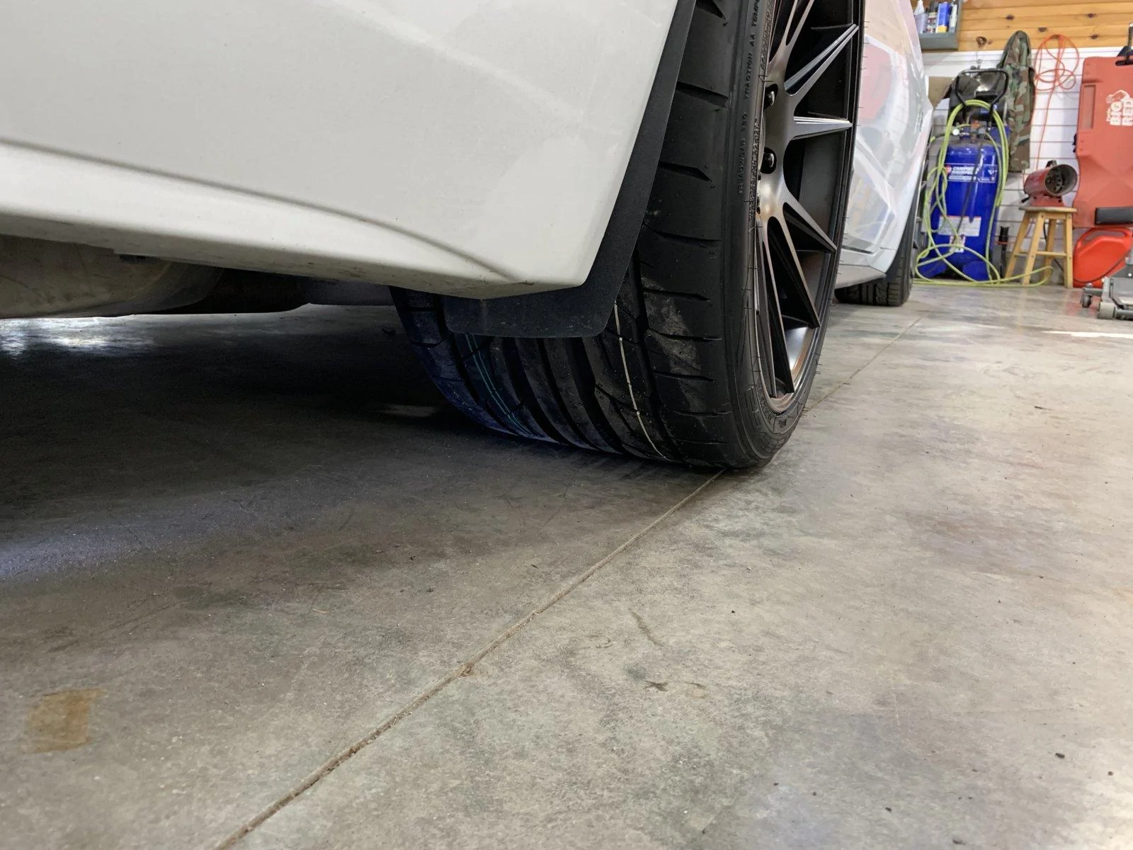

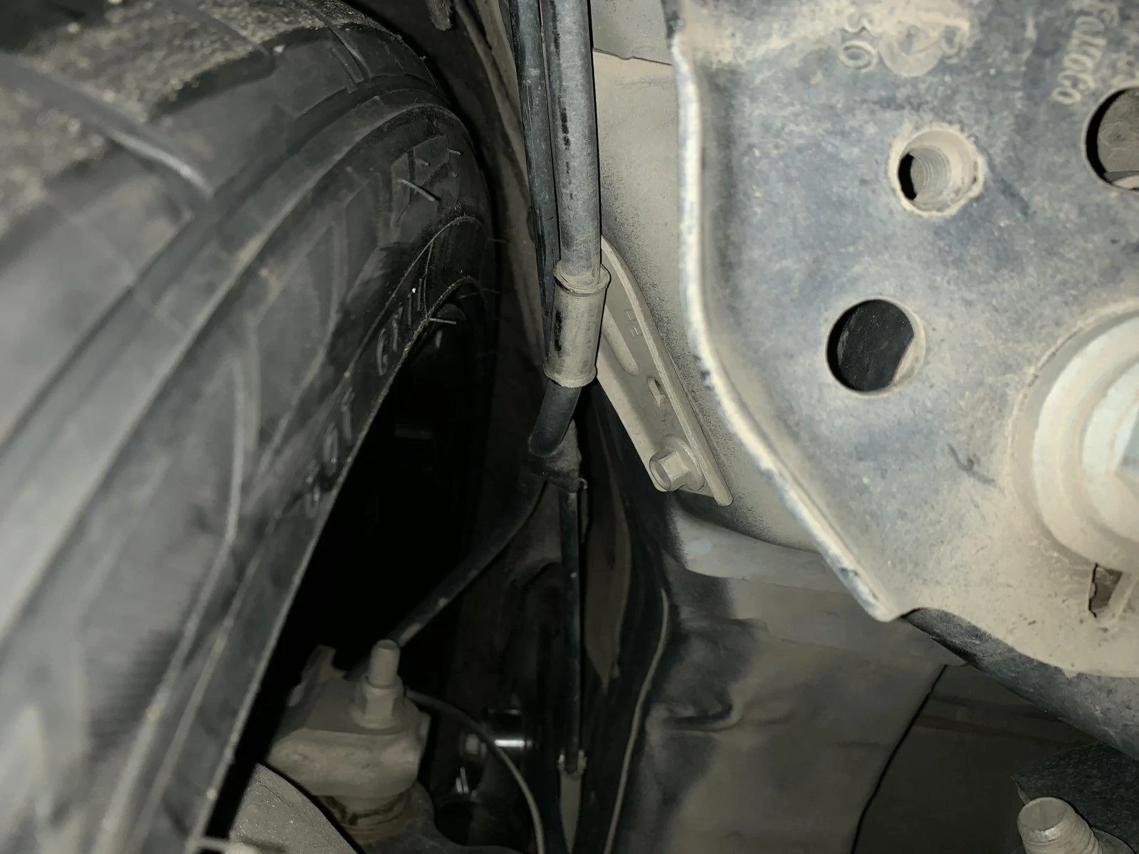

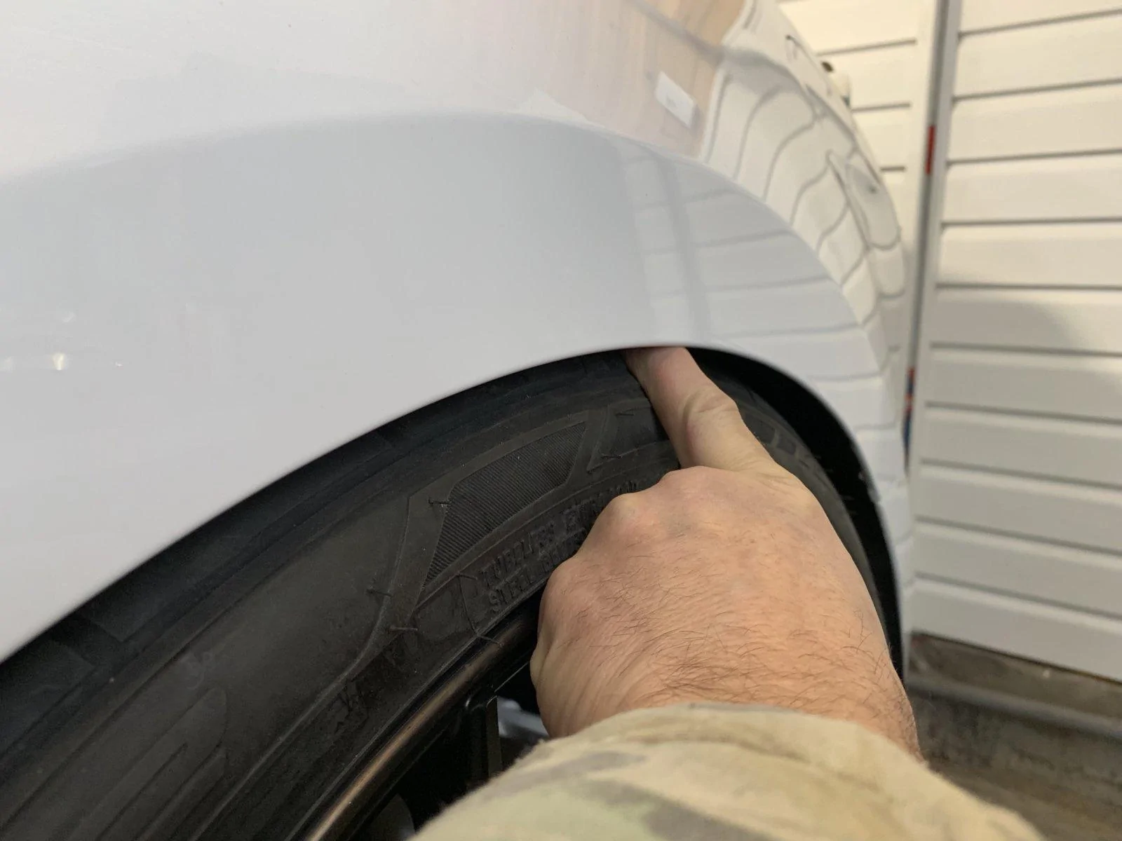

So these tires have some bulge to the sidewall, but with these wheels widened the fit is good however I personally prefer a little tire stretch and that didn't happen here. With the tire mounted on the wheels the maintained the same section width as you can see in the measurement which is just under the 13" from sidewall bulge to sidewall. I cut a small piece of fender liner and clearanced the Steeda mount a bit just to be safe, it wasn't touching but was within 1/8" o n the liner and 3/16" from tire bulge to Steeda mount. When in motion and suspension articulating it could have rubbed so trimming was just a precaution. I could have also used a wheels spacer as it looks like there is plenty of room even for a 1/4" spacer. When I measured the tire poke at ride height I was surprised to find the driver side had 3/16" poke and pass had 1/16" not really much but was notable. No doubt as the wheel push up further into the wheel well under load the wheel and tire tucks further in as there is a slight ark to the suspension. At this point I almost wish I went wider on the wheels to 12.5" and I would have had the fitment I wanted with this tire. It's been proven though that Nitto NT555 run wide in comparison to some other brands. And of course I had to watch the guys mounting my tires.

Man, that looks great. So the real width, if you use up the entire wheel well with the Steeda shock mounts, is right at 13". Any tire wider than that will have to poke out or risk contact? Seems like you nailed it.
Edit: mind if I ask what they charged you to install the shock mounts (if you didn't do it yourself)? I was quoted $200.

So I think with shaving the Steeda mount 1/4" and using a 1/4" spacer in my case (depends on original offset) one could do 12.5" for sure, but dam how wide do we really need to go.:cwl: Stupid question...wide as humanly possible when getting wheels widened:rockon: I still wish I would have added 2.5" in my case making it 12.5"
The mounts take about an hour to install which I did my self. Seems they are charging 1.5" which isn't bad.

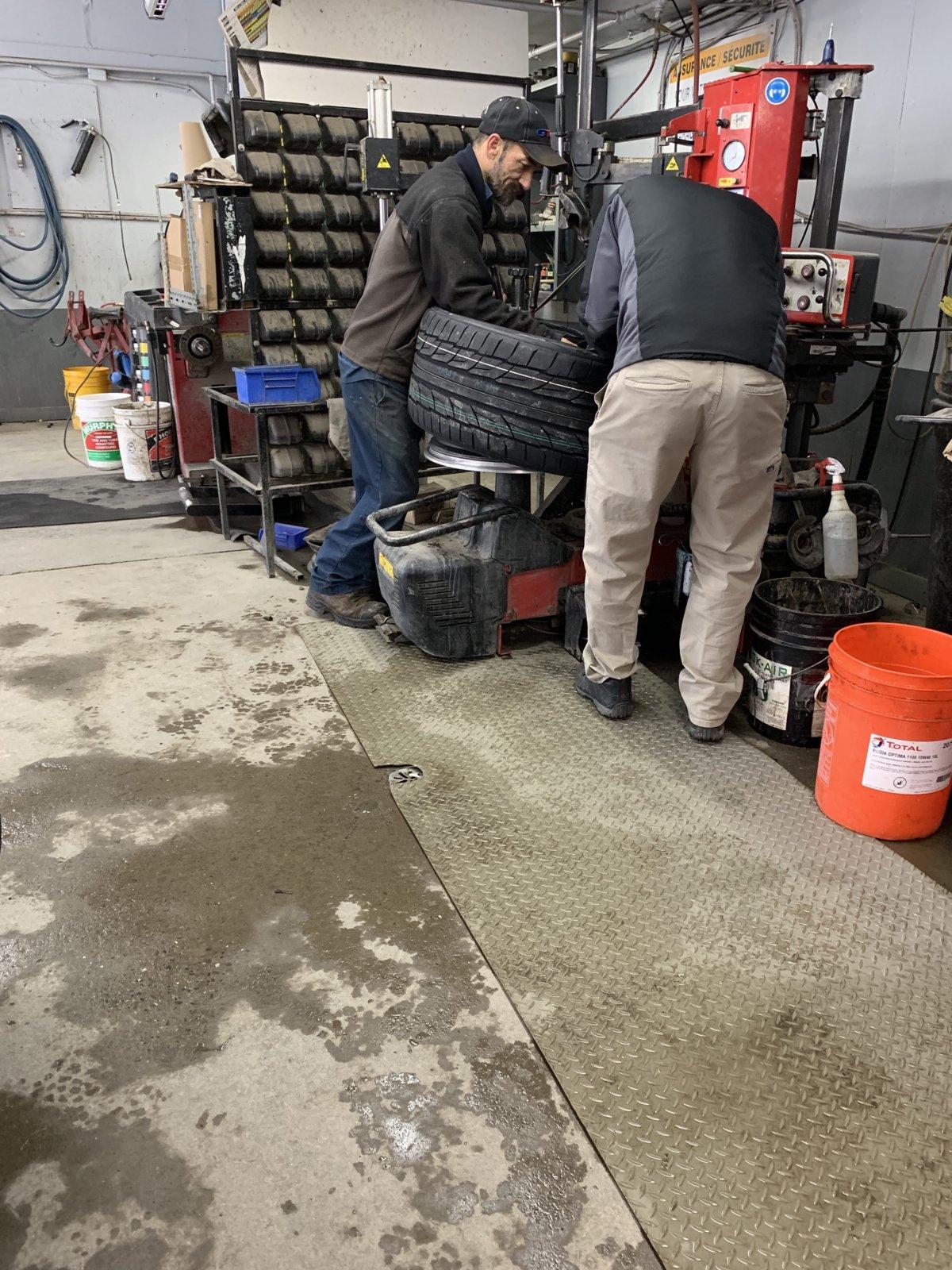

Me watching Tire Mounting:bandit:

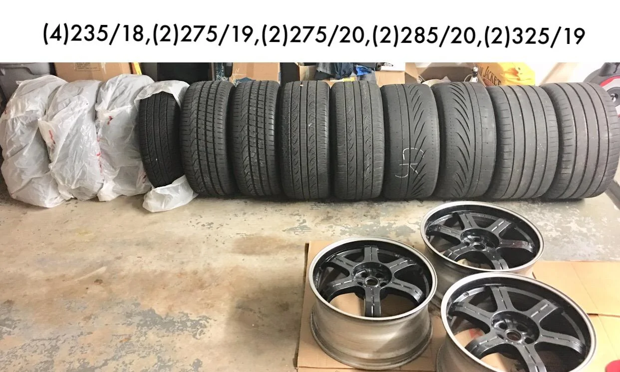

Sending wheels to weldcraft this week then got to get even more tires for the new wide rears. Not pictured but coming off of the car soon - 2 more 275/40/20 and 2 255/40/20.
In a month the only tires I have that will make the final configuration will be the 285’s pictured. Everything else will get sold.

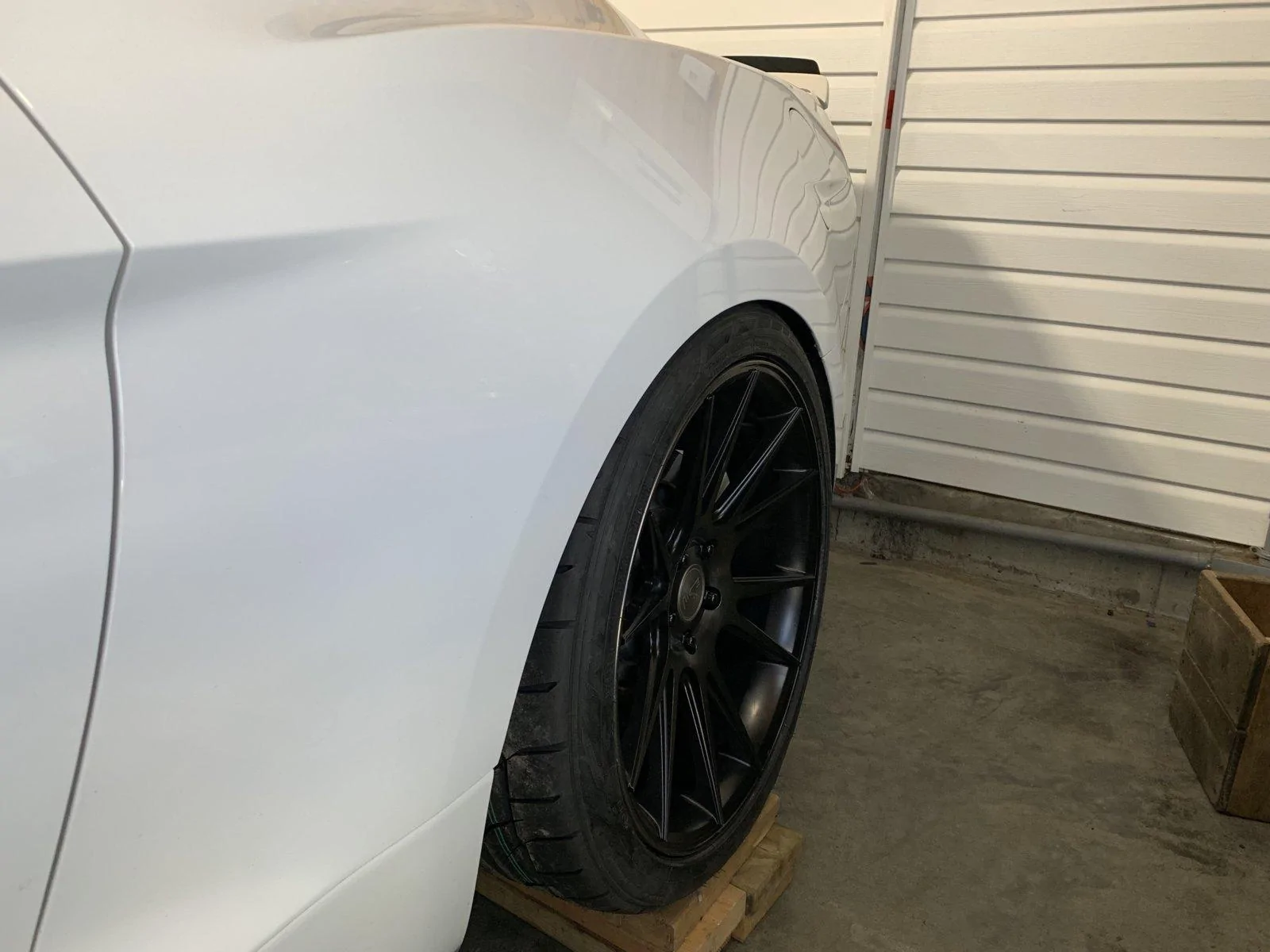

Got mine back from Weldcraft, looked great, no issues at all. Got them painted up and Discount tires mounted up my new tires also, they fit great on that wheel. Hardly took any weight. They were hesitant at first to do it, had never seen widened wheels before, but after us all talking about it, and them looking at the quality of the welds, they did it. At first they wanted proof of Weldcraft having a welding certification, but we got around that. They learned something today. They look great on the car, I also went with 20mm spacers in the front only. Sorry for the bad pix, it was dark in my garage.
