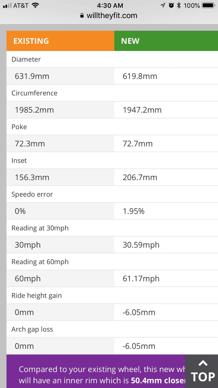

I have spent 2 hours searching for info because I didn't want to waste your guy's time. Couldn't find this info. 20"x 9" 42.5 offset OEM wheel widened to 11" on back. 2017 Mustang GT. Is there enough inboard space to fit? With or without Spacers?

I think that’ll be 1/2” too wide to the inside. Widen it 1.5” and you should be okay. This comparison is approximate (your poke won’t change from the left column unless you add spacers).
On 20x11 wheels, 50 is the highest offset I’ve seen people run and it puts the inset number around 190mm toward the suspension. That said, on 19x11.5” wide wheels I know 56 offset (around 202mm inset) also just barely fits but does work.
I’m thinking that the shape of the wheel well narrows (or there is some other impediment in there) and running taller wheels (with possibly taller tires) means you have 10mm less room with 20’s vs 19’s, but that’s just a guess.
If I’m wrong about that issue in the wheel well, with your offset, you may be able to widen 1.8” before hitting that 202mm distance into the wheel well.
This pic from willtheyfit.com shows your current wheel on the left and that same wheel widened to 11” on the right.
Another option would be to widen to 11” and then run a 1/2” spacer to push the wheel back away from the suspension.

Ok thx for the feedback. Exactly what I was looking for. With 42.5 offset I'll have enough room to bump the wheel out with a small spacer. Don't like the idea of using them but that's a whole 'nother topic. Thx. again.

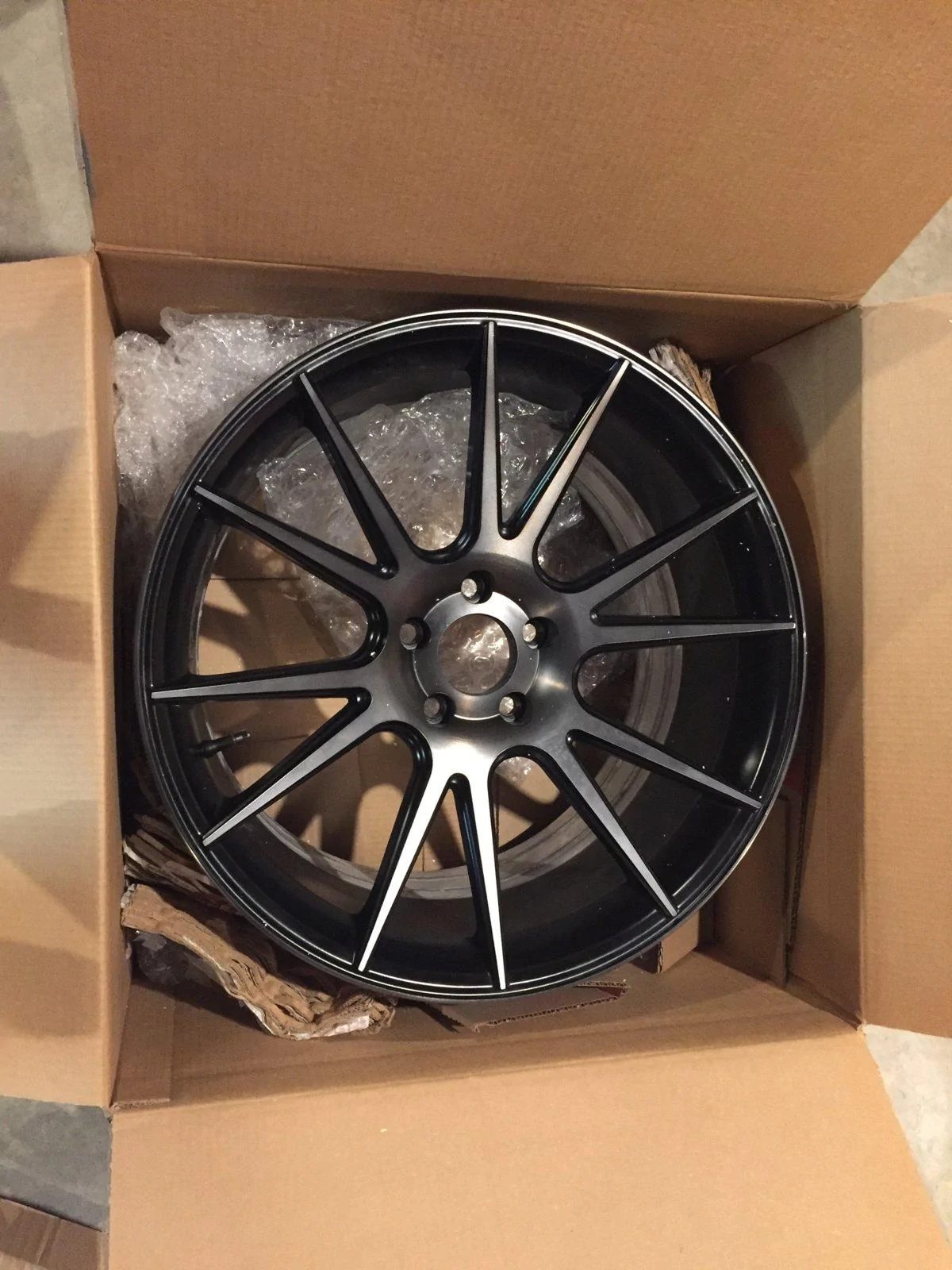

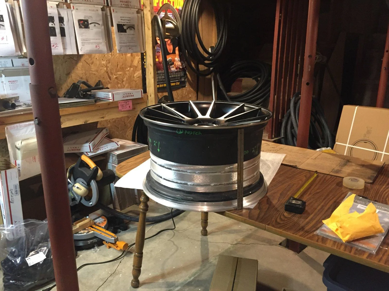

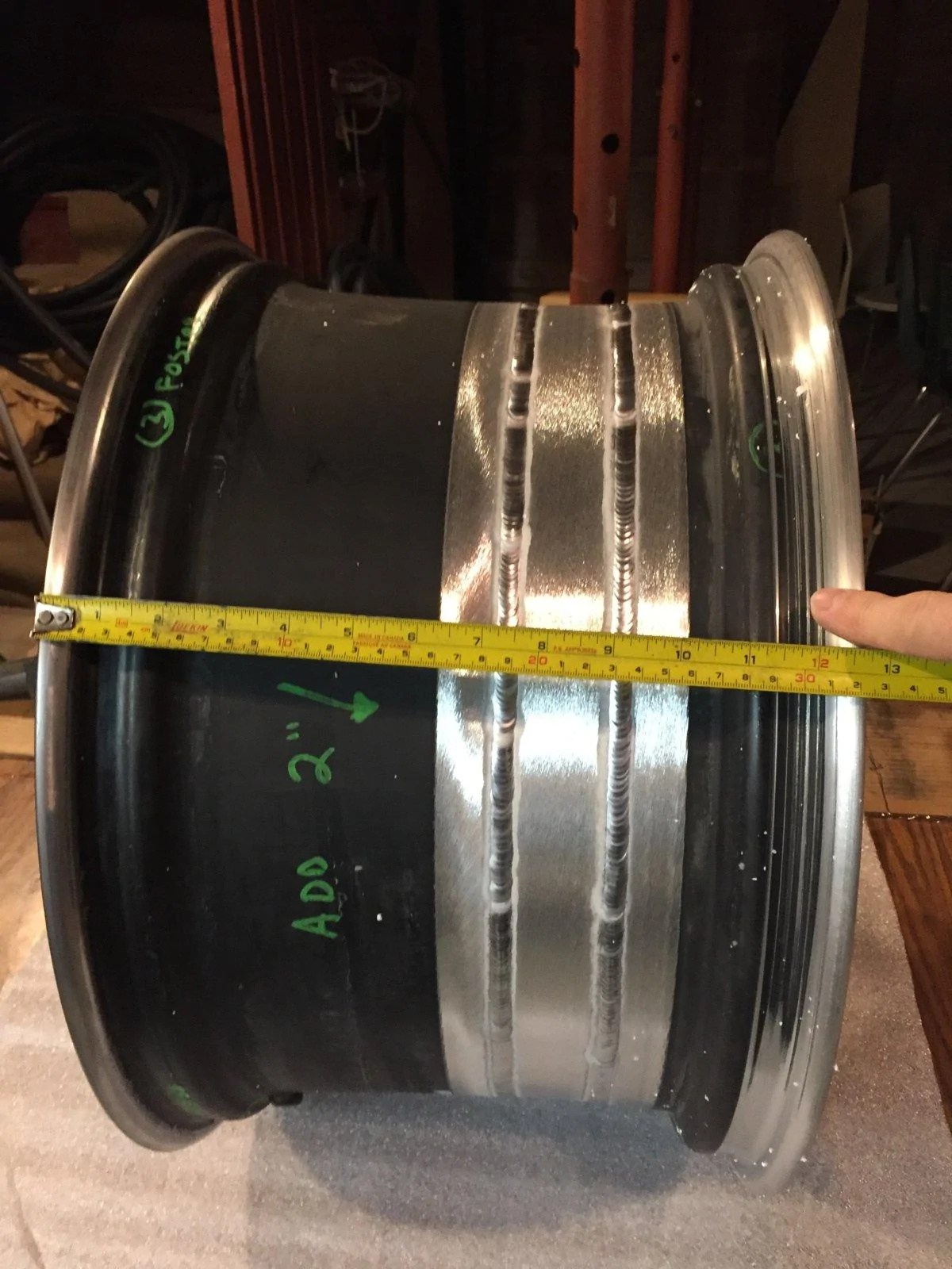

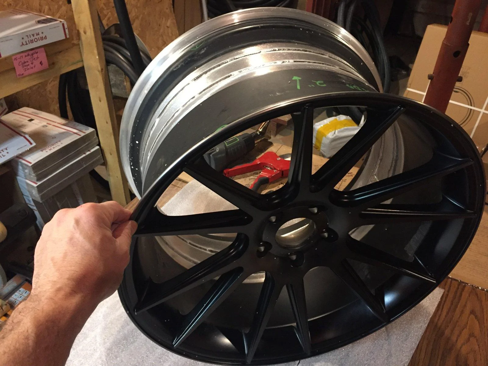

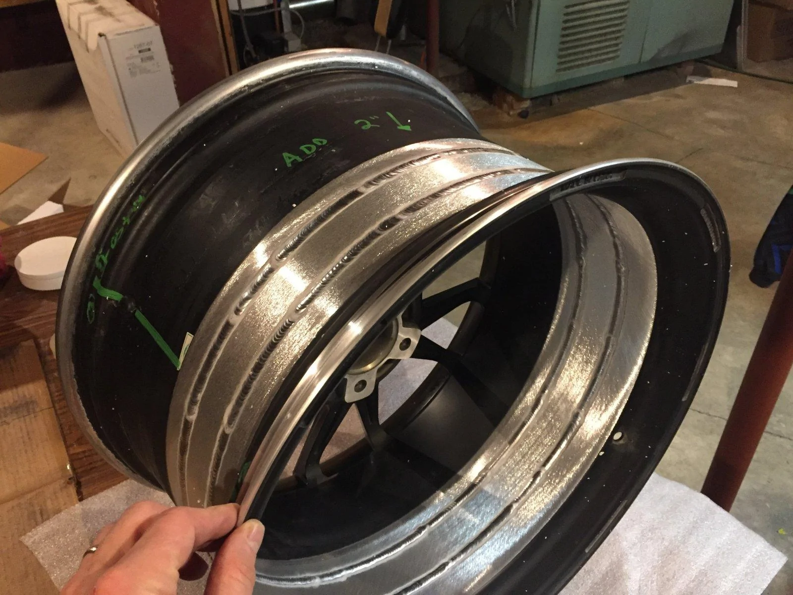

My Niche Vicenza Wheels arrive today widened 2" by Weldcraft, total 12" wide now. I must say Robert at Weldcraft really gave awesome service and timing on this. I didn't read their direction completely for sending them in and left the TPS sensor in and they asked for them to be taken of first. Also was supposed to use a box that they could fit the wheels once widened for return and I didn't. Not a problem, they shipped them both separate in new boxes with TPS sensors for reinstall and didn't charge extra. The work looks really nice and I'll be doing some sanding and painting of the bare metal before tire mounting and install.
