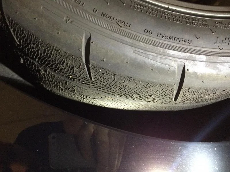

NT05R *when freshly installed* will hook like a mofo (first still useless on street without burnout, but second is usable with gradual application of throttle). After a few thousand miles, the very soft tread compound will cause the tread surface to break down and degrade and the surface of the tire will look like a tennis ball with loose rubber peels and the grip will be worse than ever. When you reach this point, they will only hook well when you do a burnout to clean some of the feathering rubber off the surface. But its a long service life of basically hooking like shit (my car will usually light them up in 4th gear) once you get to this point. I have wore a set well beyond and found that once most of the tread depth is gone, the feathering starts to go away, and then they hook again decent (normal temps will hook in 3rd with gradual application of throttle) until the cords show.
This problem I am describing, I personally believe is a mostly IRS specific thing, as I cannot find many solid axle guys talking about it. IRS is always running some toe and camber and putting extra heat and wear into the tread.. the soft compounds get attacked by it I THINK.
I put on some MT Street R. They hooked even better than the NT05R. They also degraded even faster than the NT05R and in less miles than an oil change the tires are worthless for street use as they will now only hook after a massive burnout to clean the peeling rubber off.
My thoughts are basically that the drag radials will hook best but only when new. Once they start wearing they are worse than ultra high performance tires that wont start peeling and breaking down.
Attached is a photo of what a NT05R looks like after a few thousand miles of use (the photo was taken much later, but the surface had been like this for a long time before i took the photo). As you can imagine, hooking up with that loose rubber all over the surface is futile. The MT Street R did the same thing only sooner. So, tons of tread DEPTH left, but an entirely worthless tread surface. Alignment was at -1 degree camber, and 1/16in toe L&R (in spec). I was thinking about trying ZERO toe in the rear to see if that might prolong the tread surface life a little bit.
