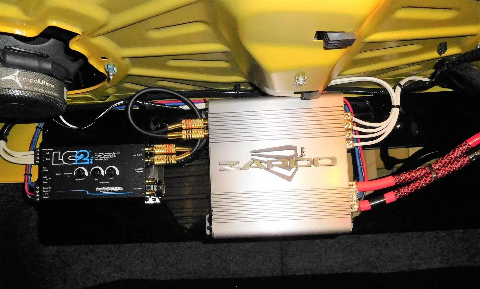

Yes, you can use your line level inputs to your rear speakers to feed into a DSP then to an amp to power a sub. I up graded my rear deck speakers and power them with a Zapco amp via the LC2i DSP. The wiring for a sub would be similar but I would power the rear speakers and the sub from a 4 channel amp with a subwoofer output on the amp. The DSP will defeat the bass roll off that the head unit and you'll actually be able to hear your rear speakers. I did 100% of this installation after dusting off some spider webs from my car stereo shop days when going to college .
