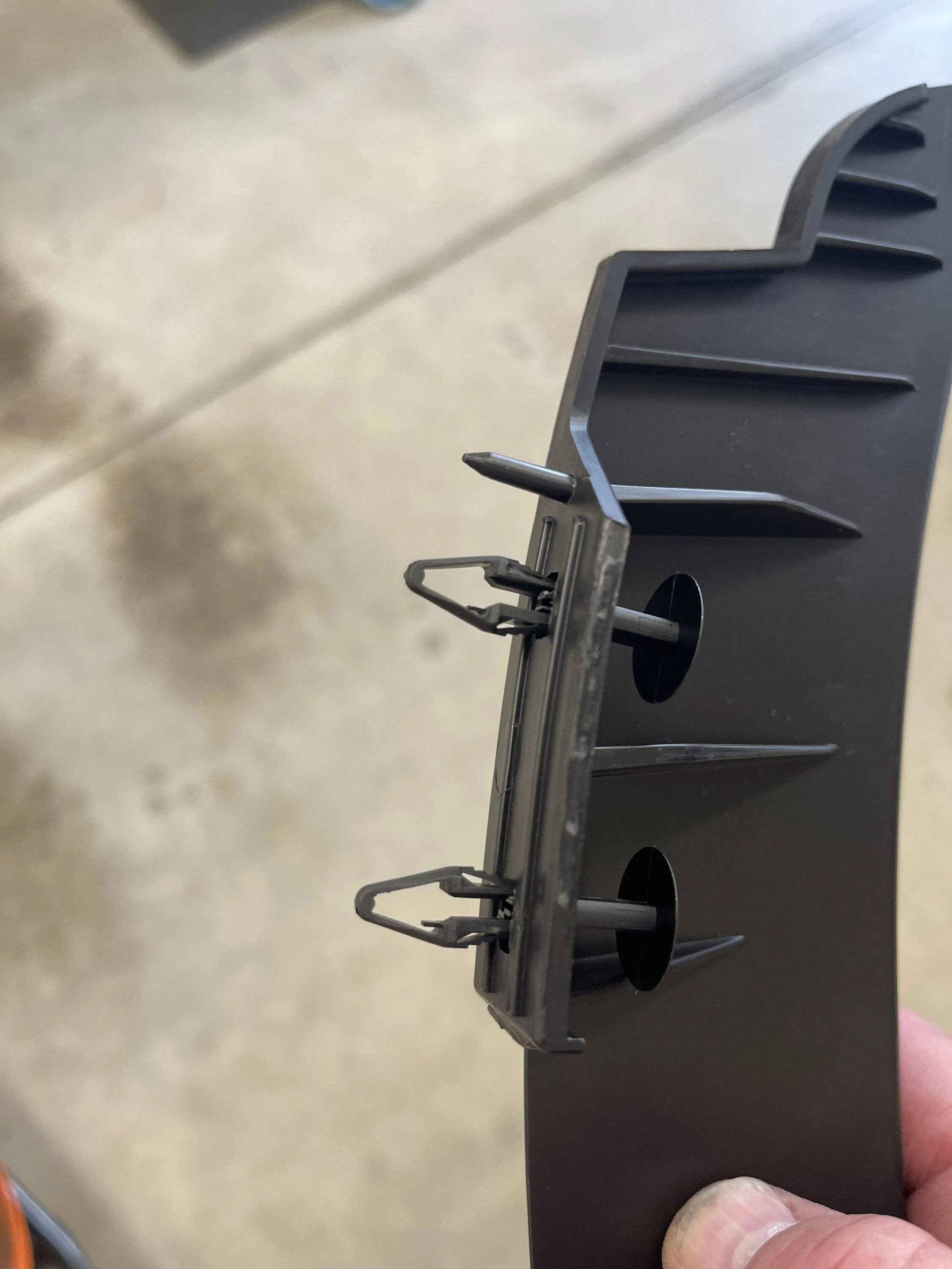

There's no need for video or tutorial, it's very easy, nothing can go wrong. Put the splash guard in place and you'll see holes that need screws and pushpins that need to be taken out and then new ones inserted. Pushpin is removed by pulling the top middle part out with a small flat screwdriver and then pulling the whole pin out of the hole. You want to remove the wheel for good access.

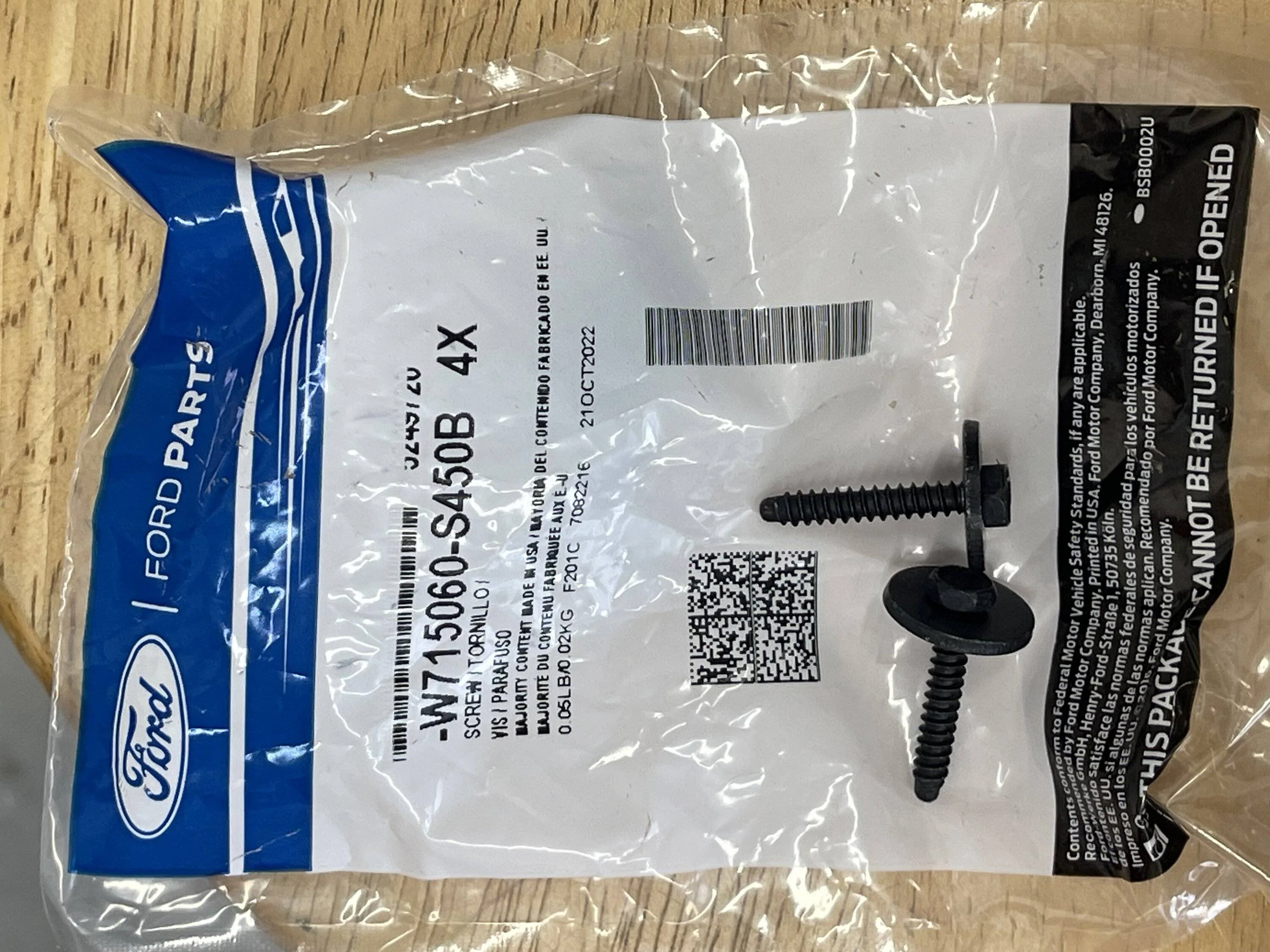

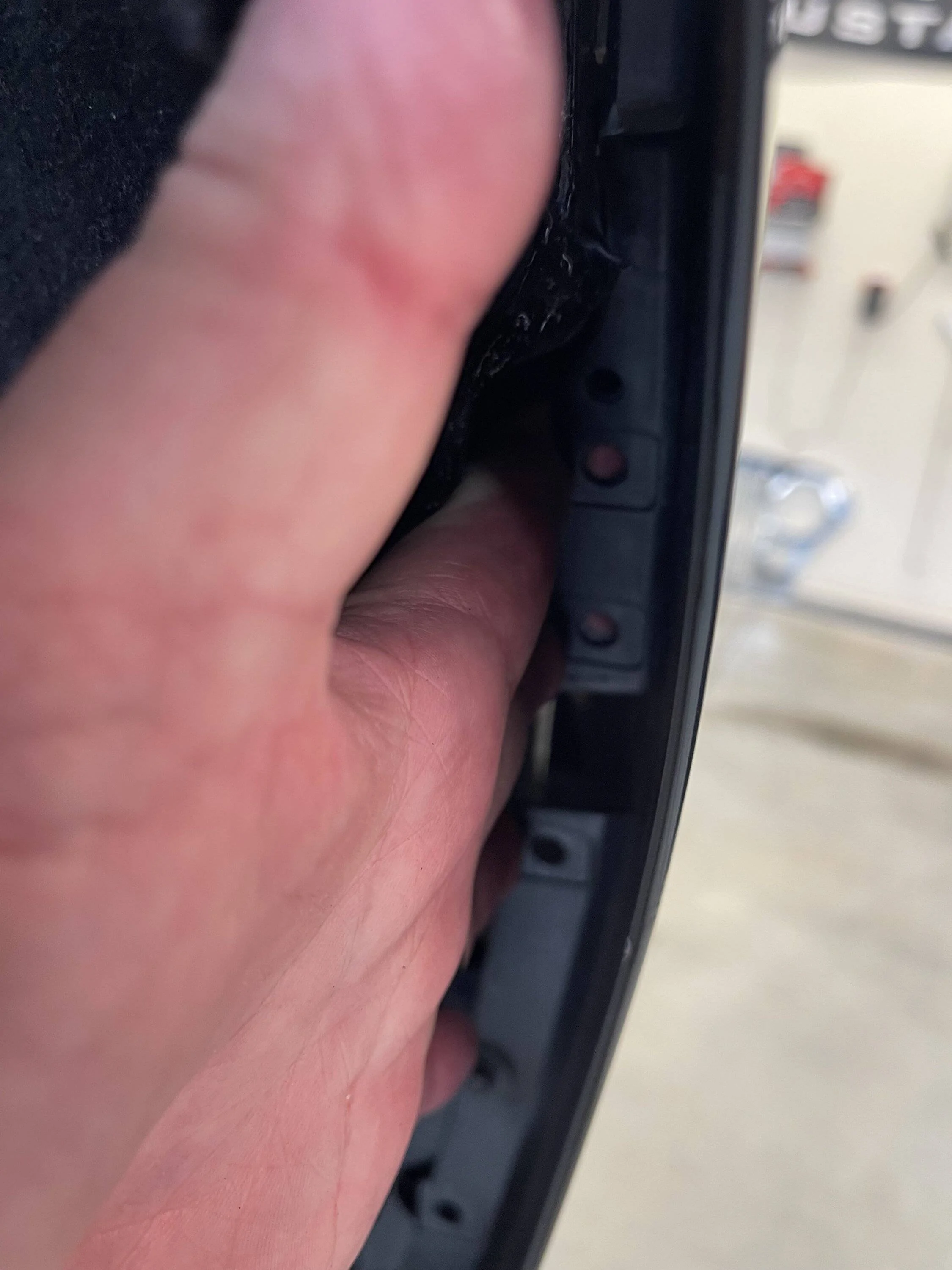

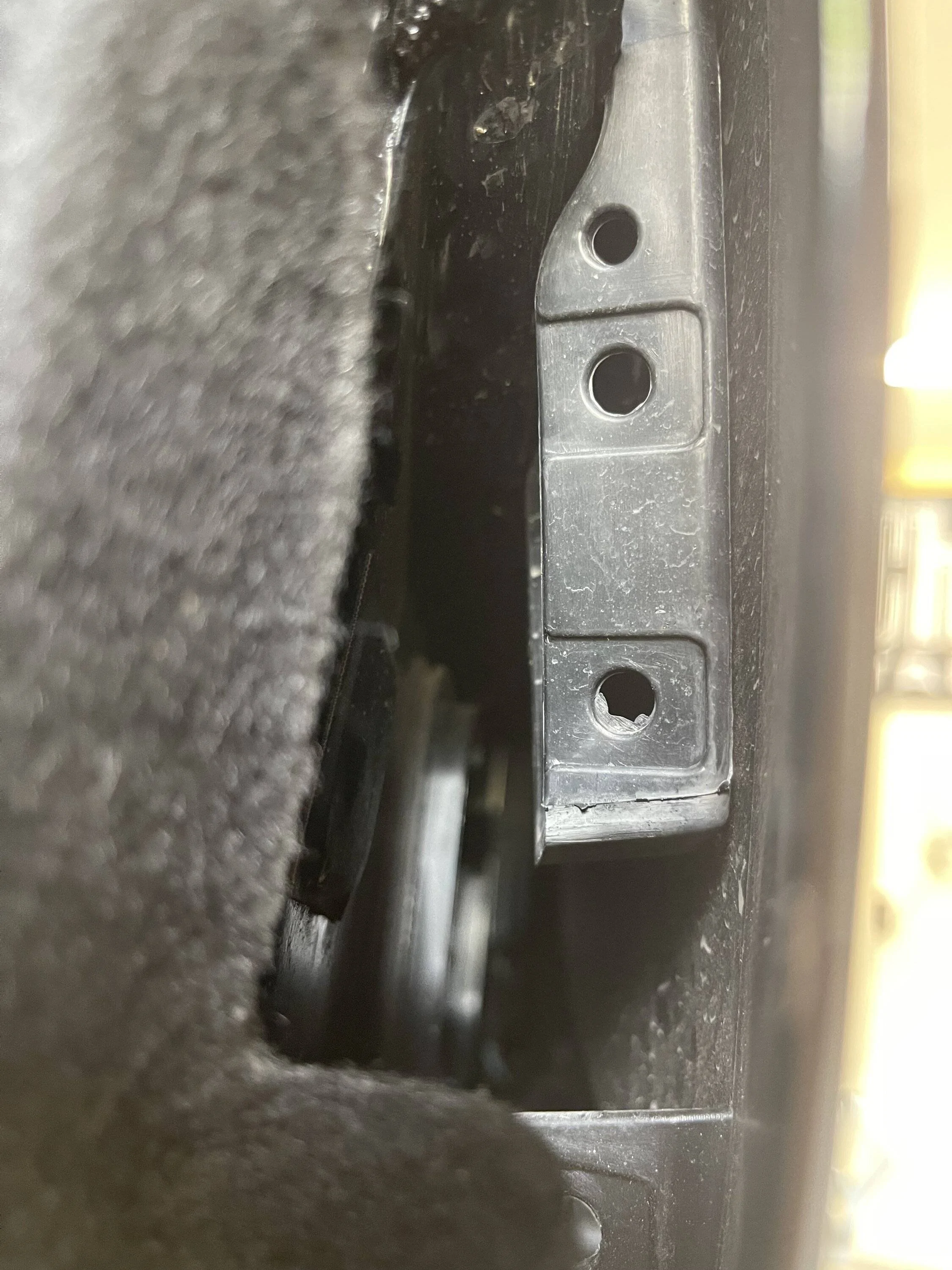

@Charlemagne Ok so I got this going but have a question regarding the screws included. Where do they go? Not seeing anywhere they could go except the bottom hole but there’s no capture nut on the car for it to thread into.

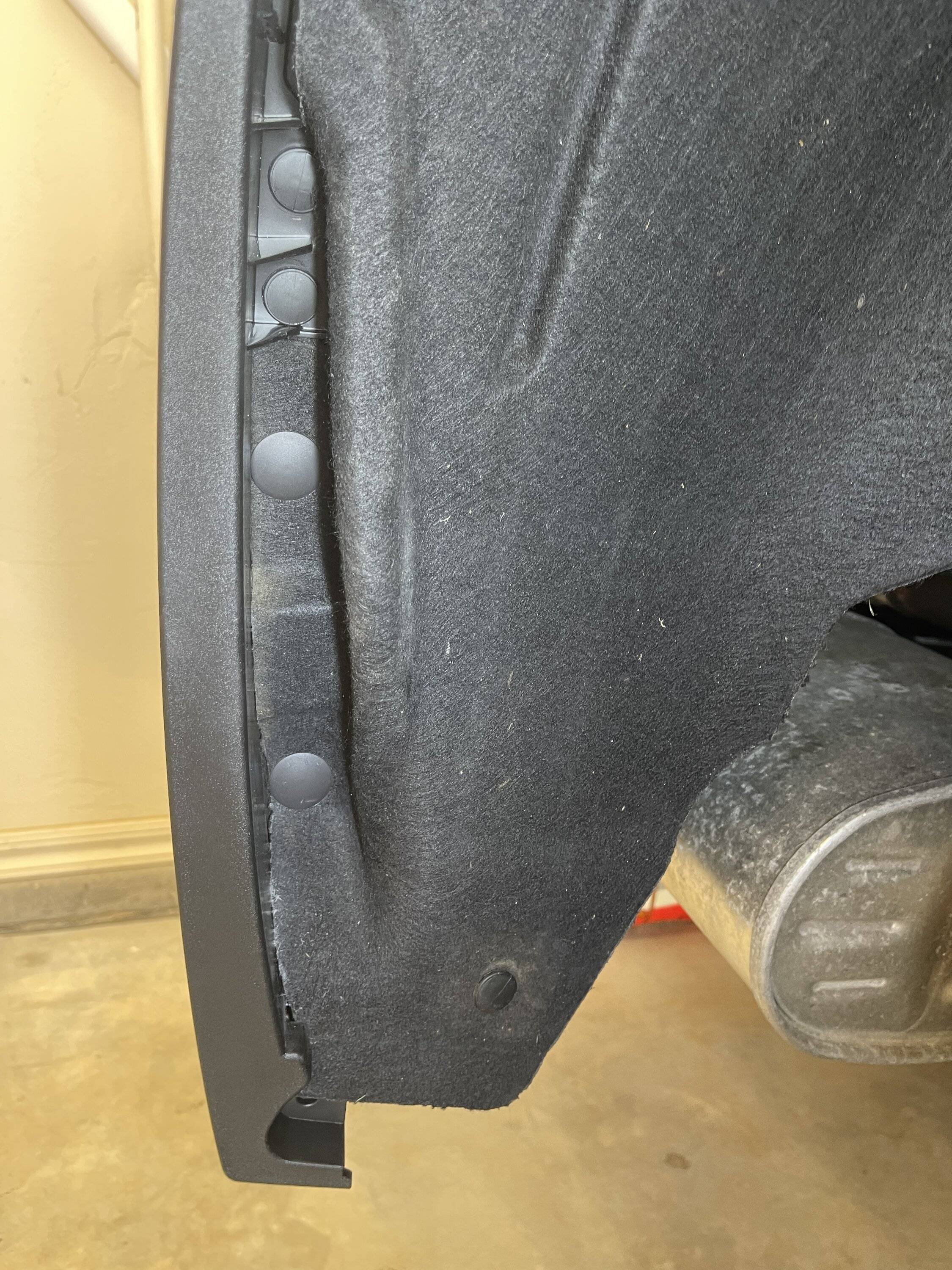

Done. Euro cars must be slightly different. Definetly no place to use the screws. Used 2 new push pins for the 2 upper holes and reused 3 factory push pins for the 3 lower holes. Seems to work fine.
