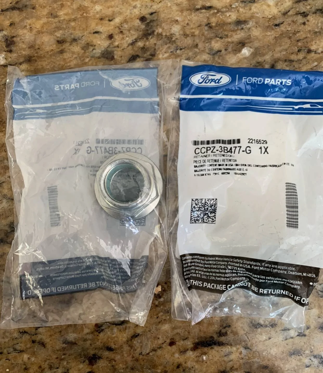

I’m replacing the wheel studs on the 500 and after removing the half shaft nut I went to ford to get a replacement nut and ran into an issue.

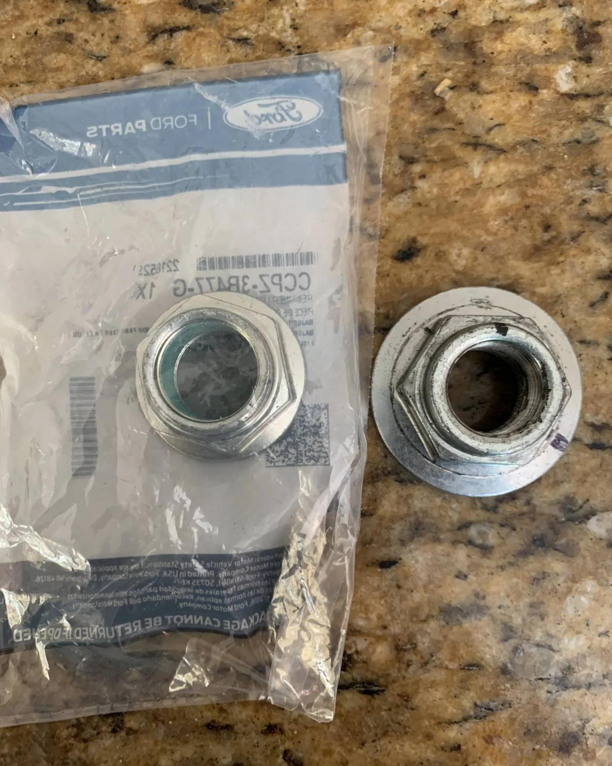

This is what ford gave me. However in comparing it to the old nut the two are quite different (see pic below)
Wait there’s another twist when the parts guy looked up my vin for the part nothing showed up. Now he’s wondering what the hell is going on, so he looks up the original part number that came on my car and got a different number.
This is the part that came on my car originally. The ford parts warehouse has a butt load of these.
So who has removed the half shaft nut and did you replaced it and what with?
Plus is the part I purchased the correct part# CCPZ-3B477-G? The parts guy said this is an old number.

CCPZ-3B477-G will not work it has a dia of 1 9/16” the half shaft opening in the bearing is 1 7/16” dia. The original nut is 1 7/8”dia.
FYI if you replace your half shaft nuts don’t buy this part # CCPZ-3B477-G get part# kr3z-3b477-a.

I didn’t try to thread the nuts on I’m turning them today and ordering two of the correct nuts kr3z-3b477-a.
CCPZ-3B477-G is only 1/8” bigger in dia that’s 1/16” per side contact patch.
kr3z-3b477-a Is 1/2”larger dia that’s 1/4” per side contact patch.
1/16” contact patch might be sufficient for a lower hp car however not 2020 GT500.
The IRS on my 00R the front nut is smaller than the rear nut. Plus the rear nut is torqued to 250lb-ft.
