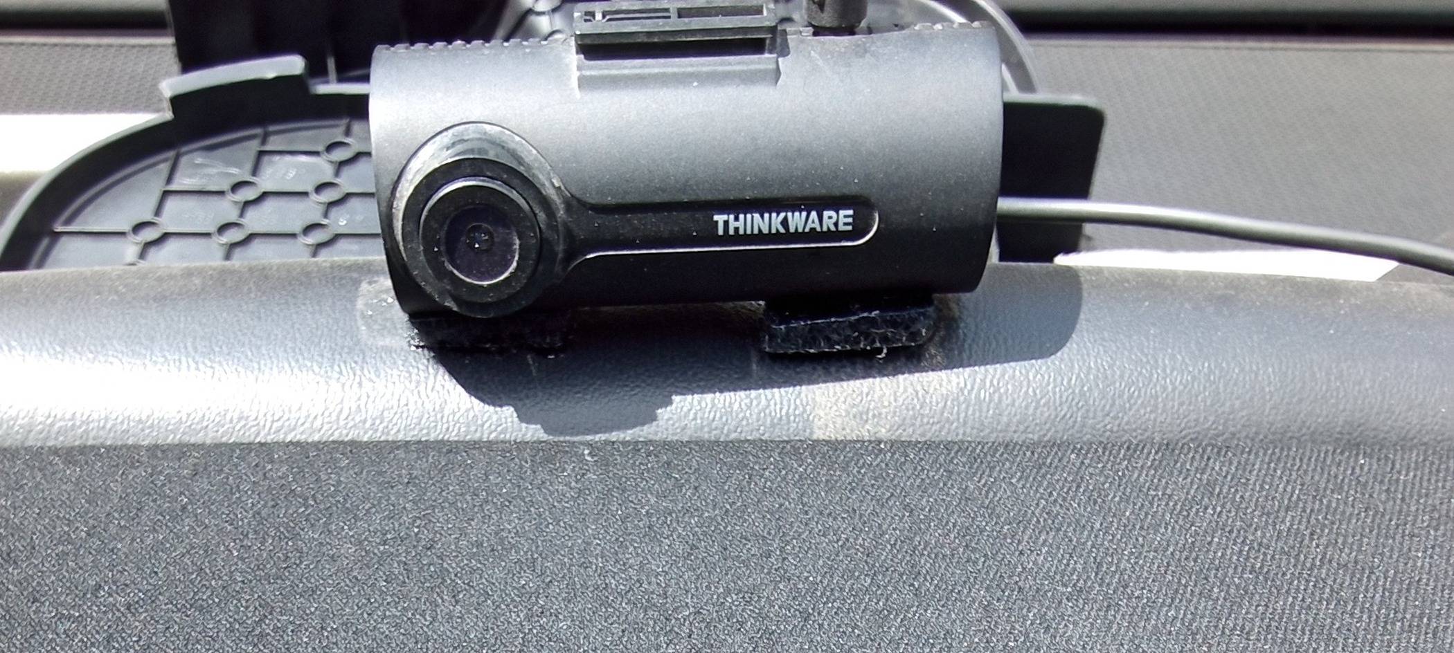

I used two way industrial Velcro on Thinkware mounted upside down on the top center of rear seat back with power cord plugged in the top, routed behind the seat between the vert top, loose, under rear seat cushion, under sill trim zip tied, and hardwired to passenger kick fuse panel.
I wanted it accessible to pull the storage chip.

Here's a pic. It works with top up and down. I like how visible it is so tailgaters and cops see it, before they do something stupid.

Never thought about that might give it a try but having it ont the tag give tag view of vehicle behind unless you live in my state where we don't have front tags. Guess could also make a bracket to fit behind the seat to mount the camera on also.
