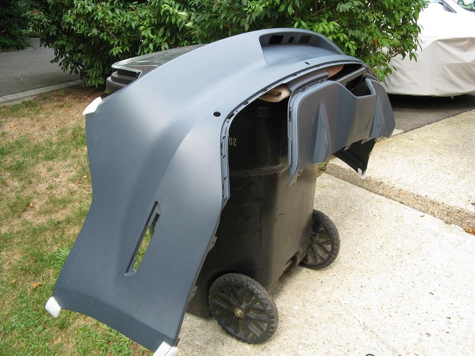

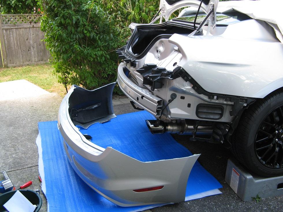

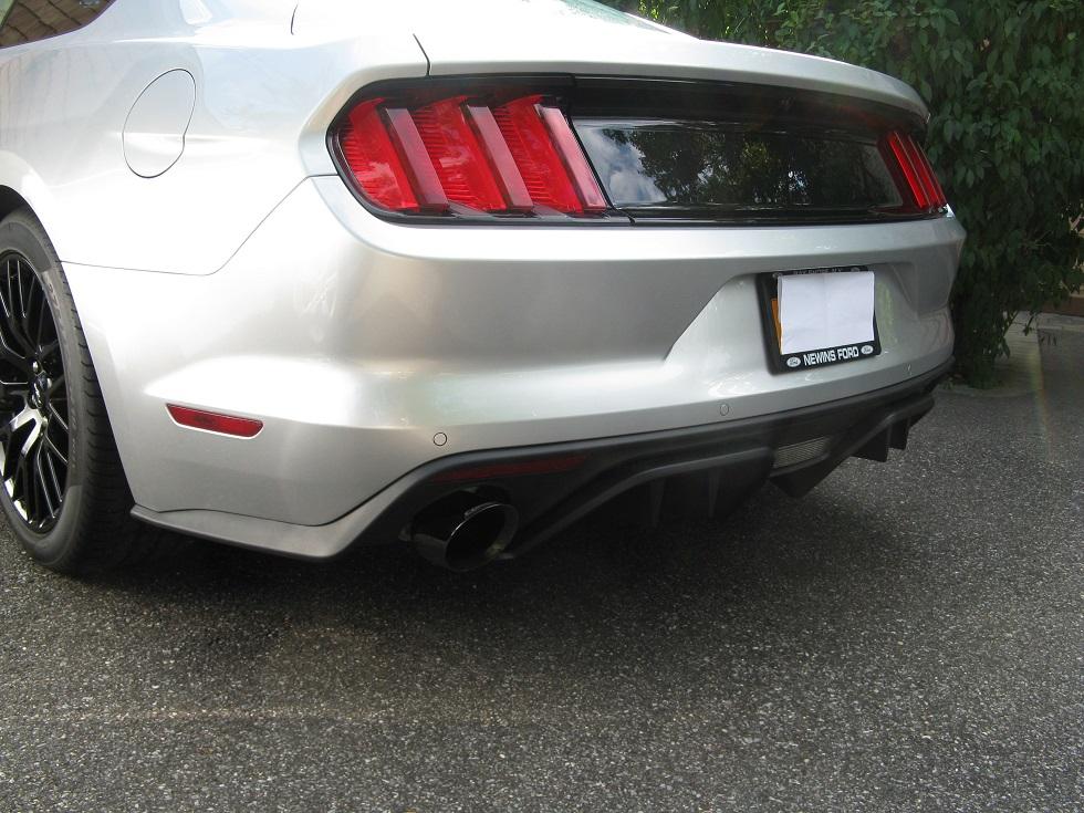

Well I finally switched to the premium bumper and added the RTR diffuser, it took me 4 hours in the driveway...but after it was completed I really like the new look.
Thanks for all the help and advice

Does the texture and color of the black plastic match the oem sidesills and front lip?
The premium bumper black rear valance is exact to the side and front trim,
the black RTR diffuser matches the factory black valance in color, the factory trim pieces have a grainy texture appearance to them, the RTR diffuser also has a grainy texture but is not as grainy, but from 2 feet away would never notice because there so close.

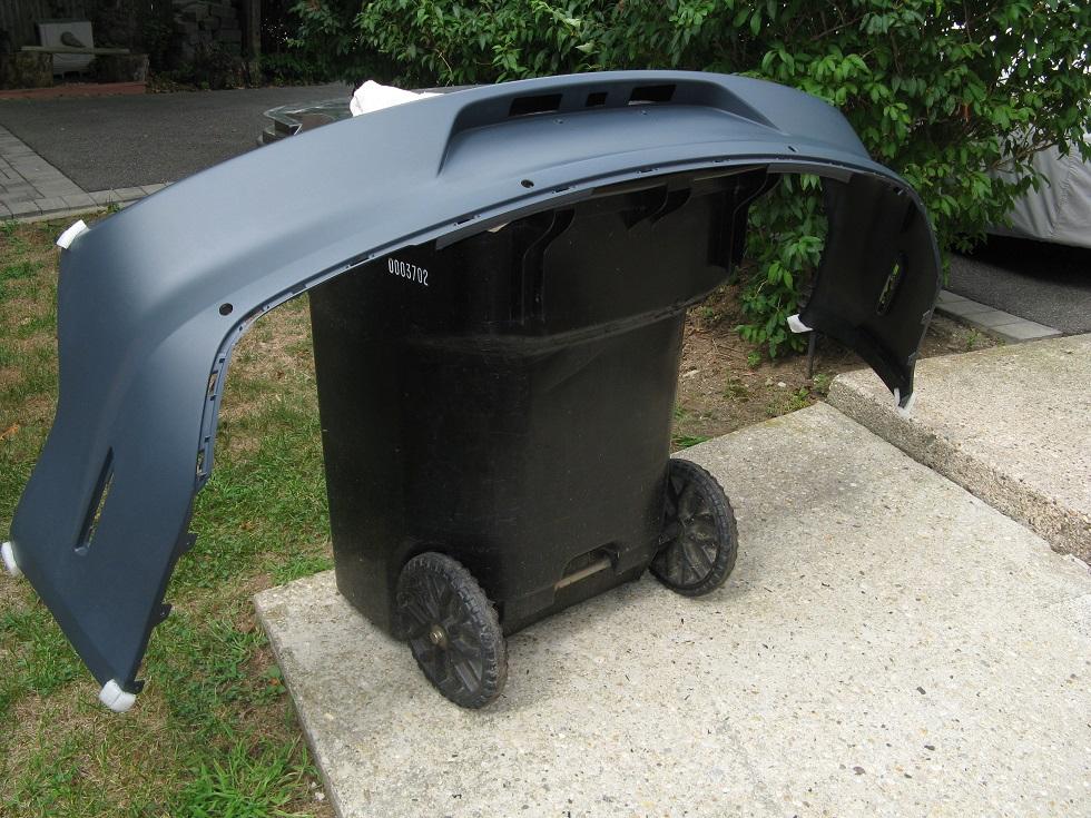

From Levittown ford I paid about 420 for the premium bumper with the sensors and the rear valance as a package , that included tax and core charge from the advertised price of 384. It cost me another 400 to get the bumper painted and then in my case the added expense of the RTR diffuser.
Does the RTR replace the factory valance or is that still needed as well ?
The RTR diffuser is actually made in conjunction to snap together with the factory black valance and can be attached to the bumper separately or together as I did. It's a really good fit and not easy to take apart once together. The factory diffuser portion of the bumper that sits under the black valance trim in stock configuration has to be cut off with a dremel tool (as in the before and after pictures) so the RTR diffuser fits perfectly in it's place.
For those who will just go with the factory premium look, there is no cutting, just attach the factory valance by pushing the valance clips into the bumper slots...
