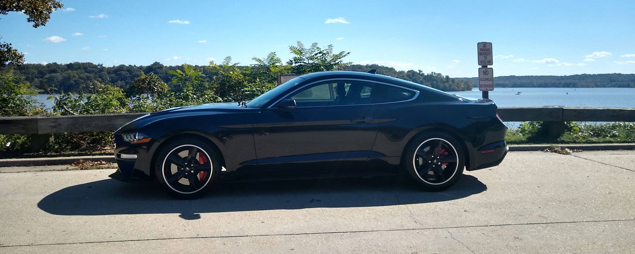

YES, Bourbon was involved in this post...... gratuitous pic just because I Love my car.
