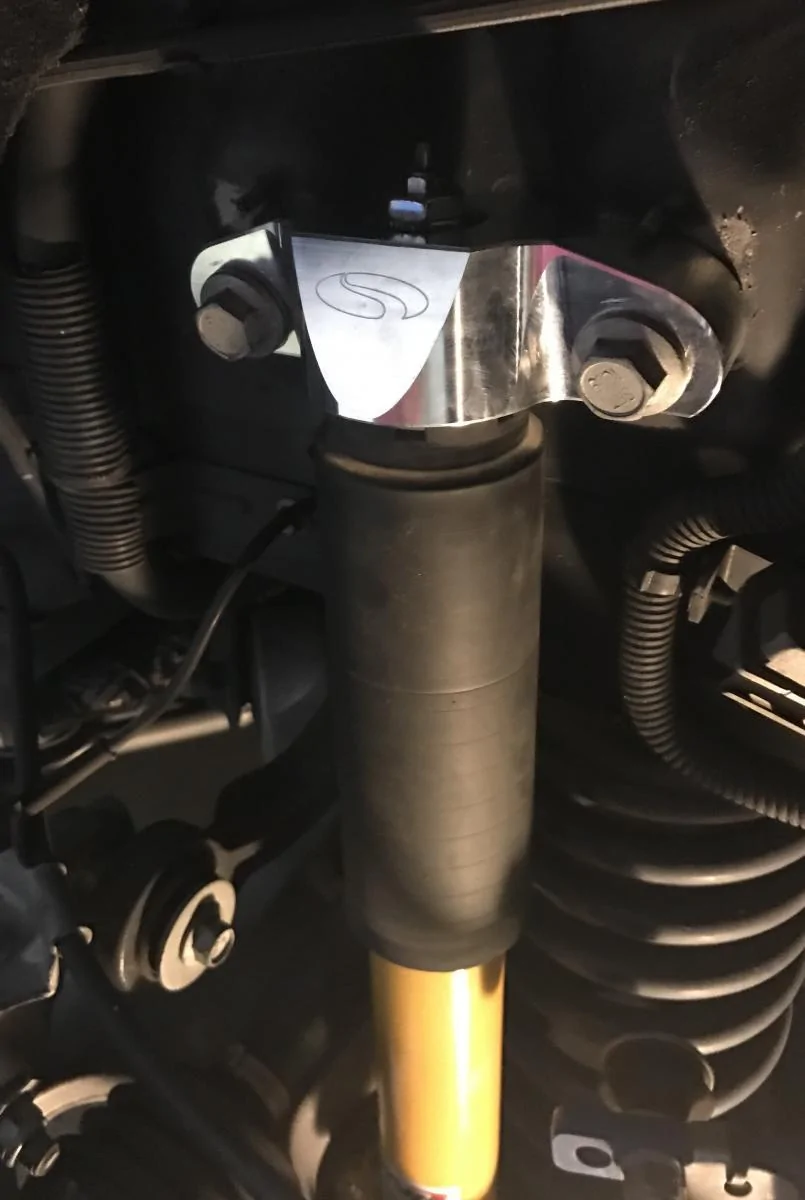

Billet rear shock mounts 100% worth it, they are a thing of beauty and when you hold the stock mount in one hand and the Steeda billet mount in your other hand you will understand. Spherical bushing absorbs the bounce factors way better than the stock rubber piece.
As far as struts/shocks, I personally thought my PP set up was decent, but boy was I wrong. PP suck, I switched to koni adjustable rears and steeda fixed struts and OMG, it's a new car, feels perfect now.
I'd recommend adjustables on all four corners since you "very occasionally track" your ride. Make sure you pick the right billet rear shock mount size 10mm or 12mm for the shocks you go with.

Yes, a great combination as mentioned above - Pro Actions & the mounts!
Many happy customers thus far & a lot of feedback on the boards - there is another customer getting ready to pull the trigger on the Pro Actions with the Sportslines in our Pro Action thread.
Could be worth the wait to see his feedback then pull the trigger!

Another recommendation for the Steeda Pro-Action dampers and shock mounts!

I've had the Steeda non-adjustable shocks and struts and Steeda's billet aluminum rear shock mounts on the car for about two weeks now. I've had the Steeda progressives springs for a while, well before adding the shocks and struts.
Anyway, the set up feels even better now than when the shocks and struts were first installed.
I like them. :cheers:
