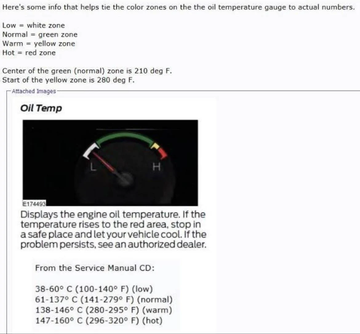

Soooo, that’s oil. Wrong topic. Great info tho.

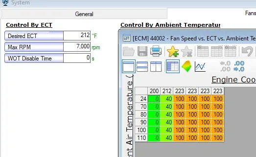

I've attached a document which provides several indirect references.
If you open the document and search for "coolant", several processes either stop, fault or reach their limit between 230-250 F / 110-120 C. :whew:
The graphic relates to fan speed, at what temp fans #1 and then two engage.

I believe Cylinder Head Temperature (CHT) is implied from other inputs. There is no actual coolant sensor.
