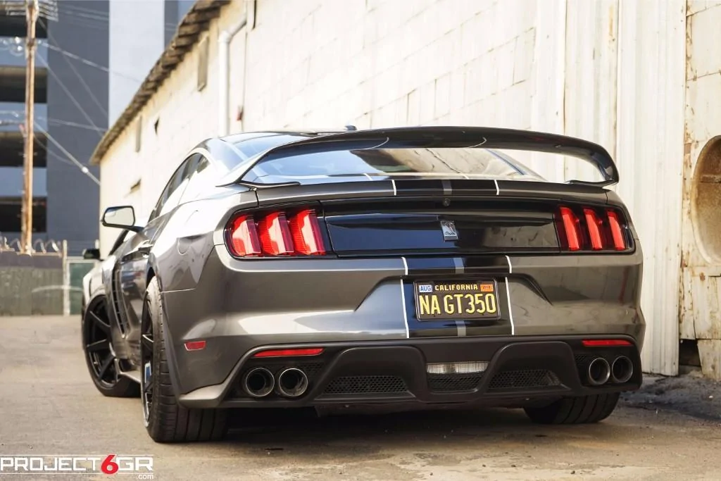

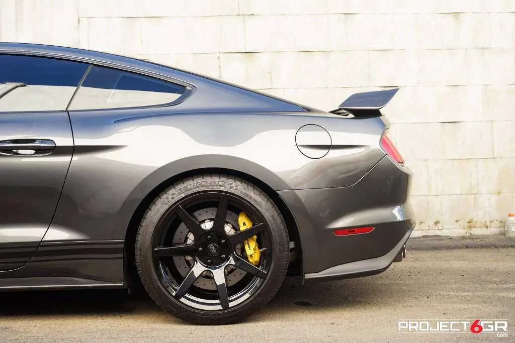

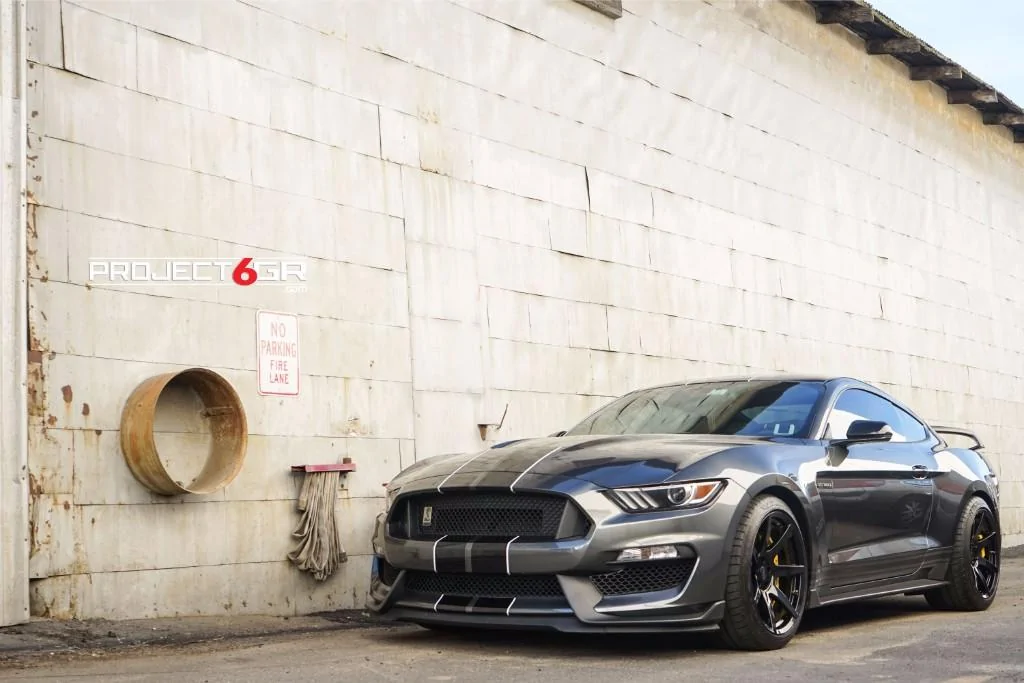

Yes you can also do the OEM GT350 tire sizes on R-specs.
295/35 | 305/35
Here are some pics of this setup:
