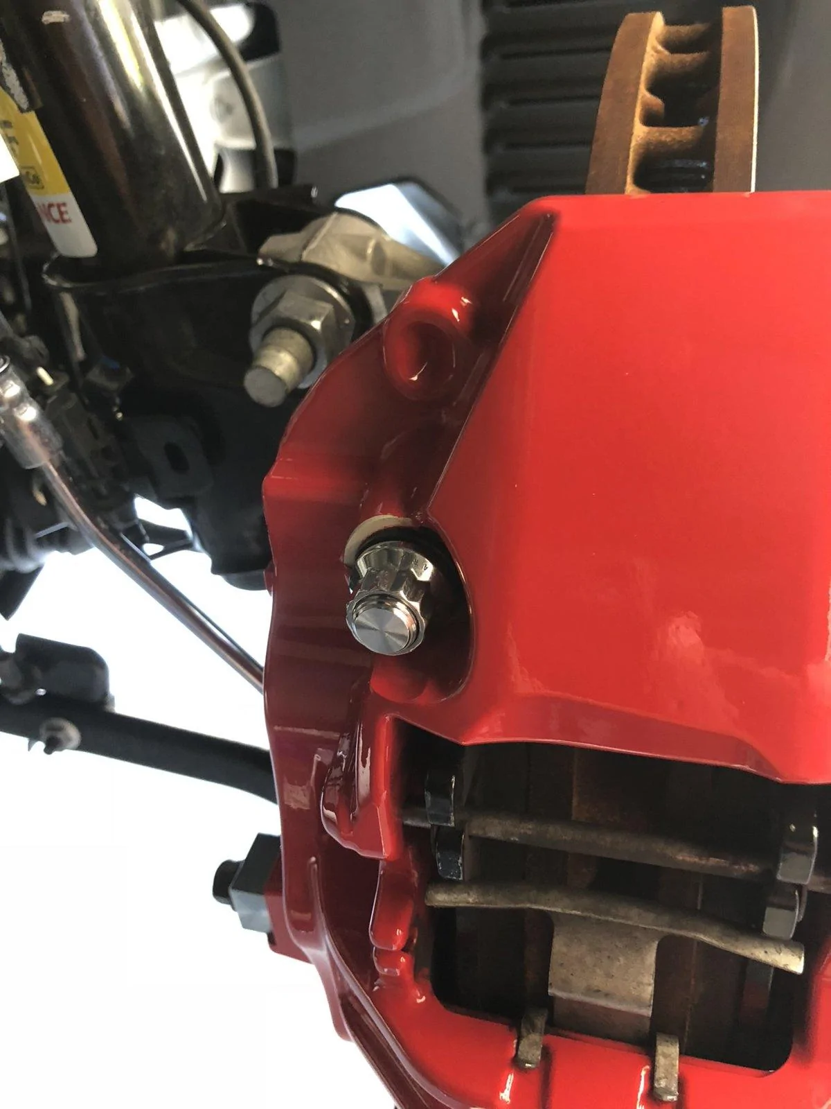

Uuugggg....that makes my skin curl thinking about you letting the jiffy lube place install these. Attention to detail...make sure they clean out the threads in the knuckle very very good. That junk left in there can influence the caliperfexion stud not torquing/bottoming out as designed.
I rescheduled with Ford's service department instead Galaxy. If I'm going to let QuickLane do it, I rather get a local buddy of mine to help me install it ourselves. The only reason I'm not addressing it myself is that I'm concerned Ford may have missed out on a component to order for the swap and if that's the case at least it's at Ford and they have stuff like that on hand versus me finding out during the install and getting stuck or having to revert back. The other reason is I've read to much on the master cylinder getting damaged from improper bleeding that I don't really want to try it.
However, I do want to track the car soon. Is it true that you have to bleed it every time your at the track? I'm comfortable now swapping wheels/tires since I installed the gorilla lug nuts. OEM lug nuts were a nightmare itself.

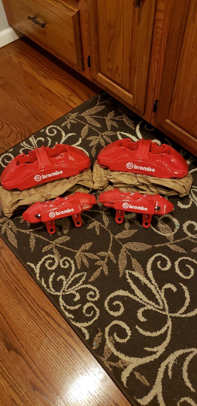

I got the R calipers last year Christmas time. I found a ford dealer in New York that shipped them to me with no core charge and for 950 so yea got a sick deal. I have the tools , jack's ,stands ,etc to do it myself however I Don't want to do the bleeding on the brakes as well . My buddy owns a garage and I'm just going to have him do it for less then what I would of paid to get some bleeder equipment off amazon. So it's a win for me . Can't wait to get them on, however I have to wait till spring (hate winter).
One question though what are these caliperflexion studs you guys speak of ,and should I get them as well prior to install ?

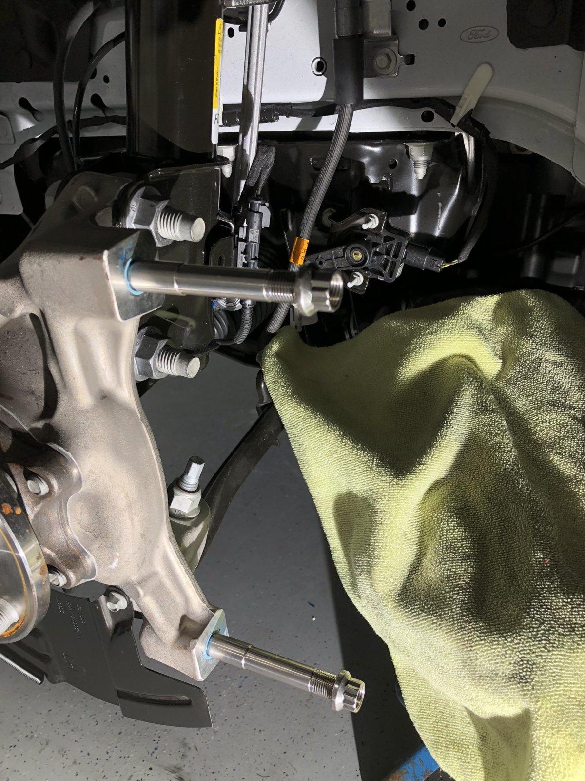

The Caliperfexion studs are just that, studs. Instead of using the bolts, which according to Caliperfexion are one time use, you remove the bolts and install these studs. The studs thread into the knuckle, caliper goes on studs, and nut at the top holds them down. If you swap pads often, like you would doing track days, you'll be pulling the calipers fairly often, and going through a lot of bolts at $8 apiece ($32 per pad change, before shipping).
https://caliperfexion.net/shop?olsPage=products/17-4ph-stainless-stud-kit

Even if you’re not doing track days and don’t r&r calipers often, they’re gorgeous and will look amazing with those new shiny red calipers. Then the next time you remove the calipers for any reason, you’ll be sooo glad you did. This was literally one of my very first mods.
Thanks --
Was your deal a 'one off' deal with the dealer or do you think they'd be willing to do it again? I would love to get the deal you got. If possible please forward me dealer contact info.

Thank you very much for the info man. I will definitely get these.

Thanks for the info and pictures my man - they look great and I'm going to grab a set. Anymore tips please feel free to shoot them over to me.
