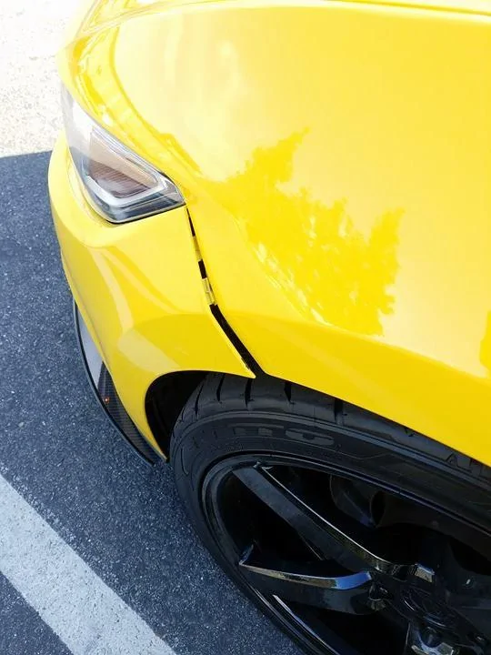

My bumper tabs broke and I tried everything.
I'm thinking of using a Quik-Latch. Any thoughts or ideas on this?
Anyone else have solutions with fixing the bumper?

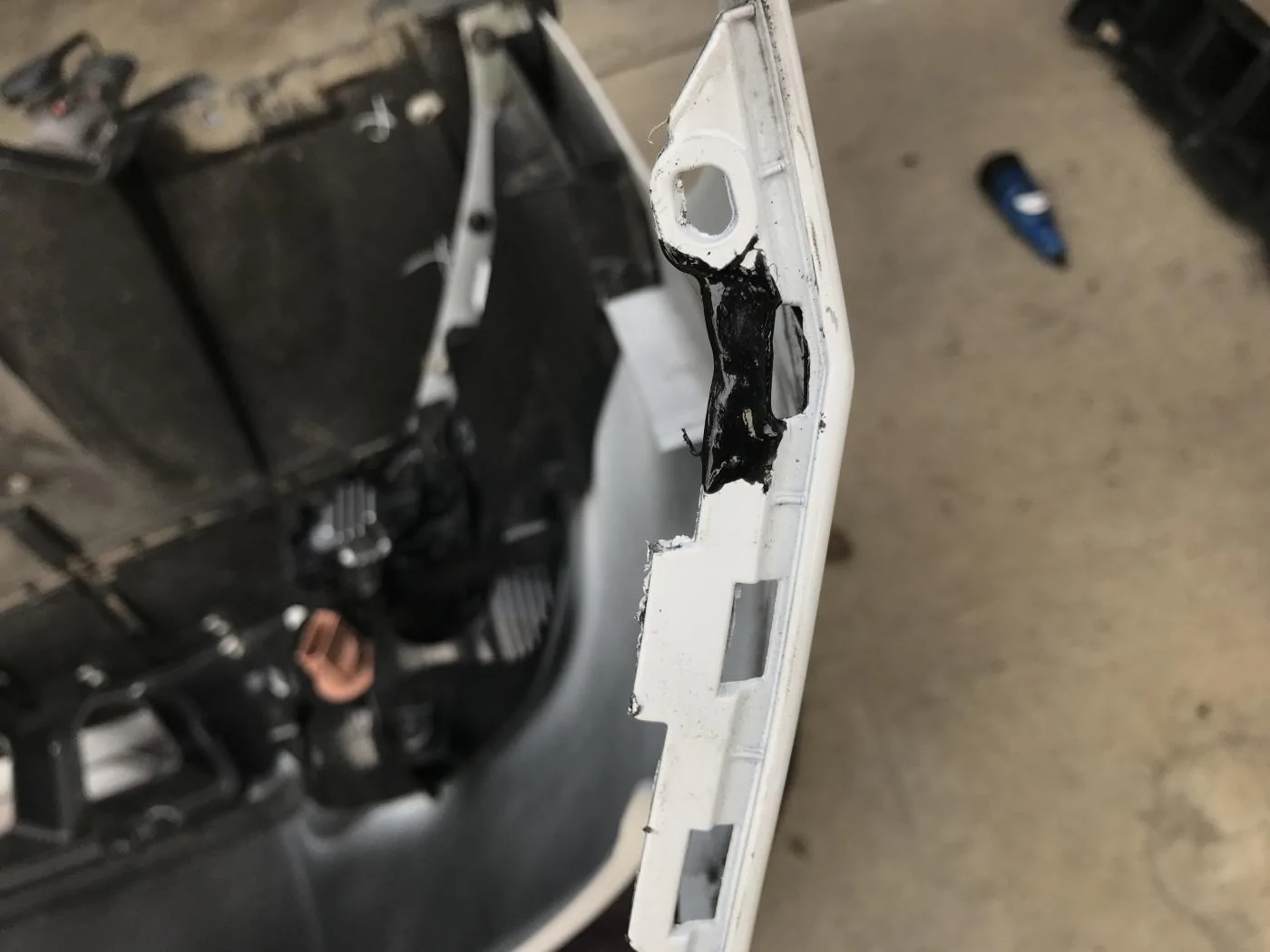

I broke mine on the driver side as well. It didn't break off completely so I was able to use some ABS cement I had laying around on it. I just covered it up with a few coats and let it dry. By the time I had to put the bumper on, it was good as new. You could try doing the same but bonding a thing piece of abs as a new tab.

Thanks for this, mine broke (or was broken from the factory) in the same exact spot when I removed mine to install the big mouth. Fortunately I was able to put it back on with no issues but in case I ever have to remove it again, I'll be sure to use some ABS cement before reinstalling :thumbsup:
